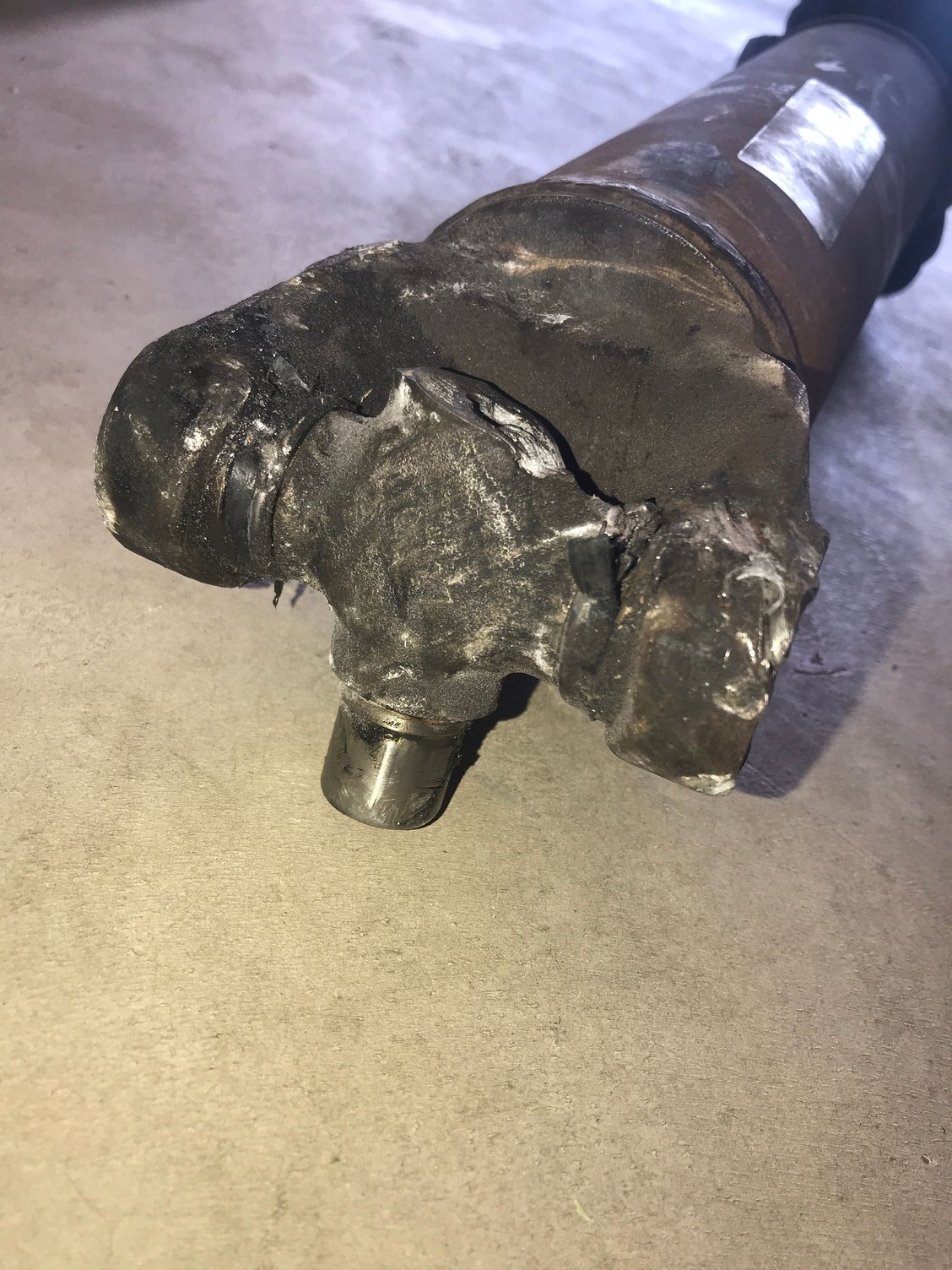

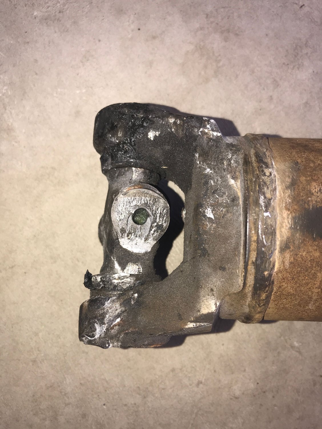

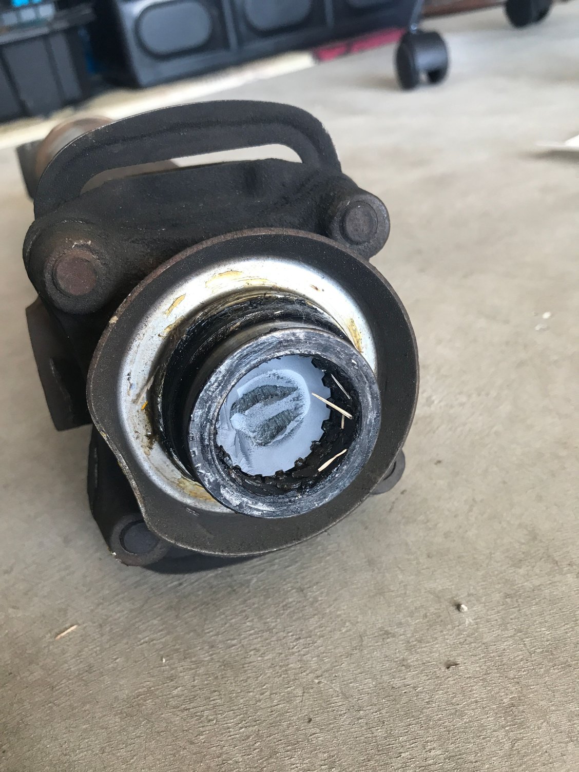

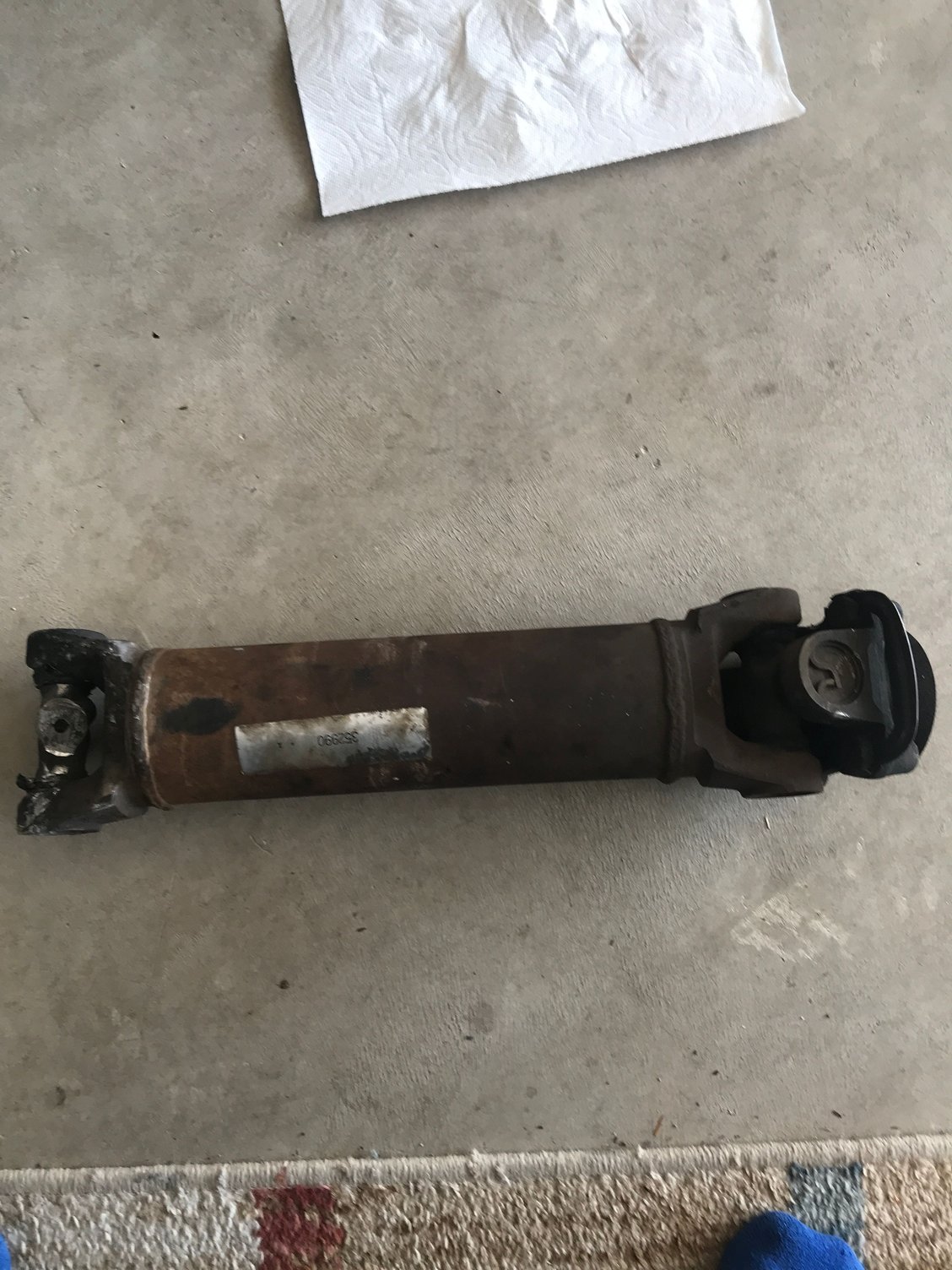

Here is the shaft, I dont have access to the car today

That is from abuse, maybe not by you but the car was beat up. The inner u-joint sheared, the outer axle snapped you still have the axle nut on the end of the axle?
The 1/2 shaft is not the cause. You are going to need to rebuild the trailing arms and look at the diff for internal damage. You are going to learn a lot about vette IRS now.
What power, trans, traction and use do you have? If the power is around 500hp that will do it with some launches, if it's the stock 200hp or so motor with automatic the car was flogged badly.

Yep. U-joint failed in fatigue. Finally snapped and the shaft was left spinning on the backside of the wheel...until that battering broke out most of the spines in the hub.
That joint has passages to allow grease fitting and pressure lube. The passages actually weaken the part; but when used normally, there would be no problem. If you put power thru the U-joints regularly, it would be better to use joints without zerk fittings and lube passages, as they are stronger.
