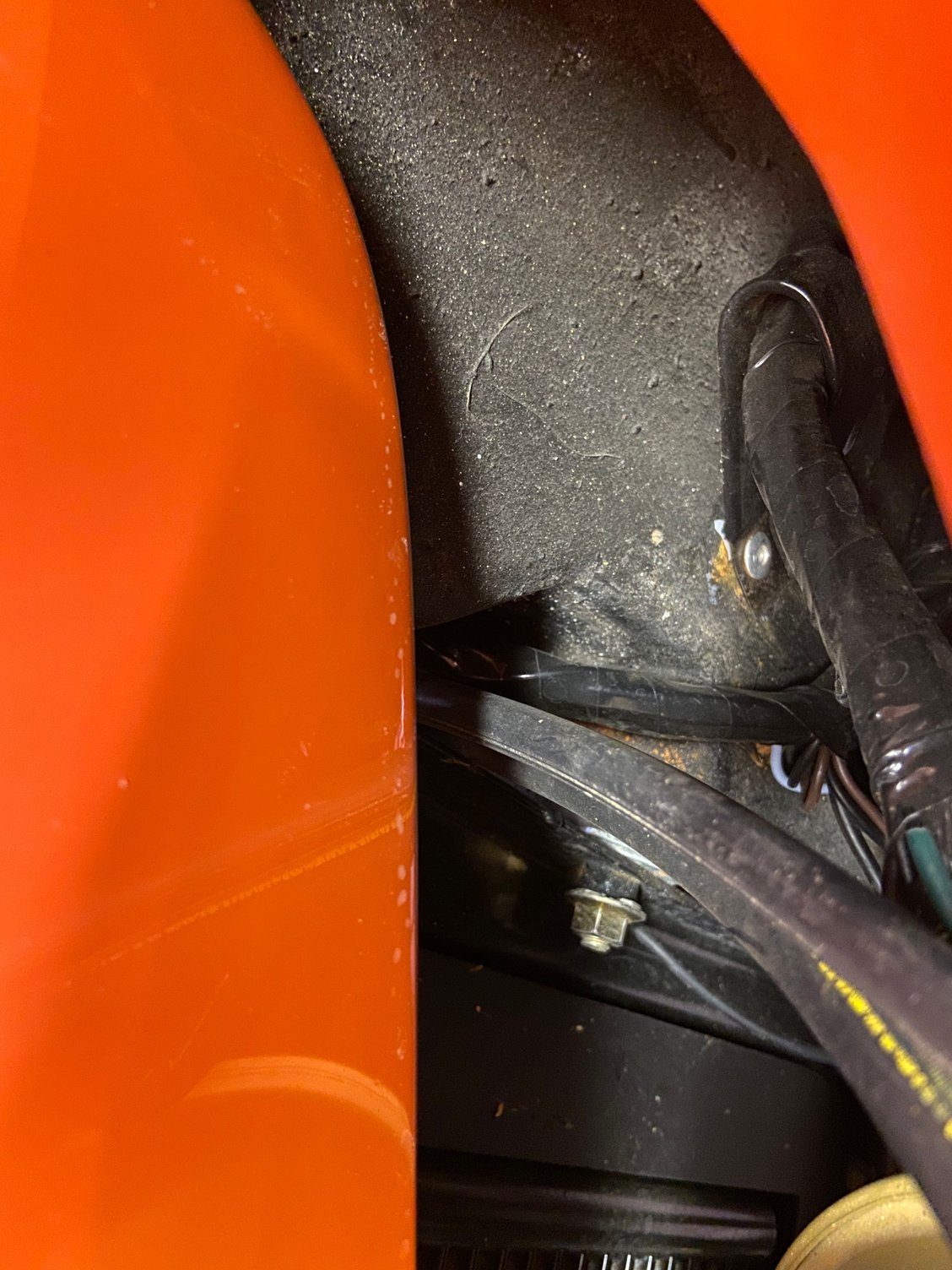

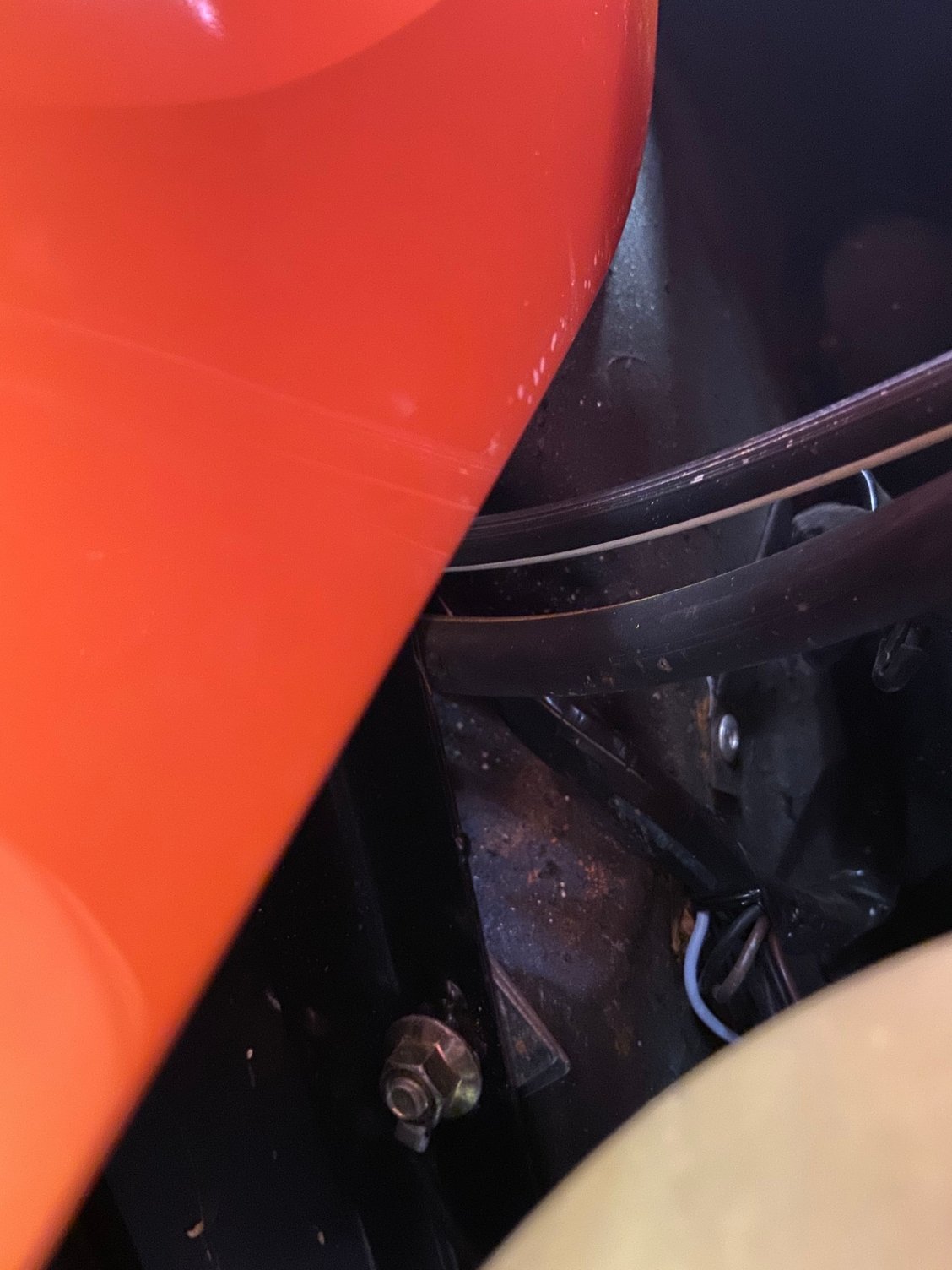

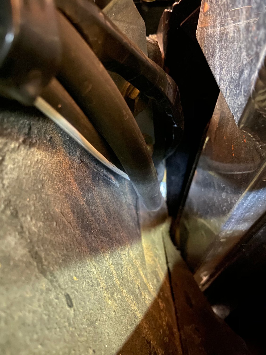

I am going home today for lunch, i will take pics of that area, as i did this about a year ago..

Actually that space looks good size. I’d pull them at The same time. Also the drivers side outside headlight wire from the harness must be pulled enough. It when you raise the headlights it will strain there.

Thanks for the pics and suggestions. I have to be very careful not to damage any of the connectors when fishing through that opening.
