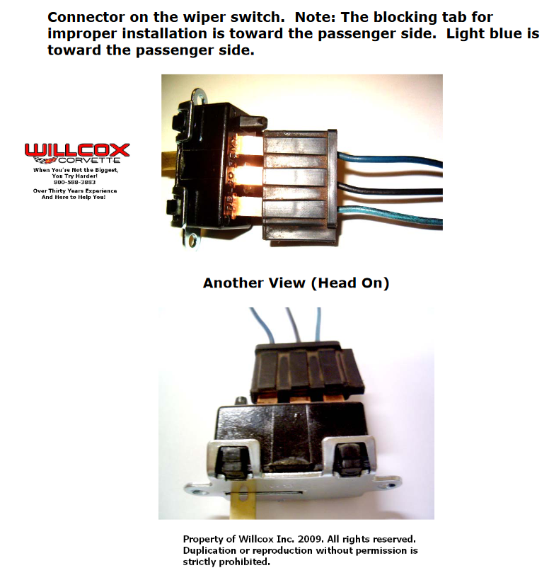

For the wiper switch- you might have it plugged in backwards-
Thanks to Willcox for documenting all this stuff!!!
http://repairs.willcoxcorvette.com/w...-with-test.pdf

Of course the wiper switch was plugged in backwards! Now it works as it should. And of course the horn was not working, just the relay clicking. You guys are good!
Have a new relay ordered, will report back when installed. Thanks!

The switch is easy enough to test.... go to this link and watch the video.
http://repairs.willcoxcorvette.com/1...r-switch-test/
Of here is the video link direct.
