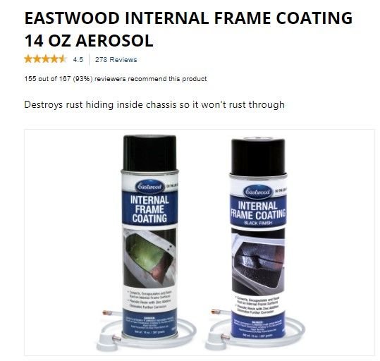

This.
Coat the inside of the frame. You can do while the car is assembled. It'll never show.
The frames on these rust from the inside out.
It has a little plastic hose that lets you get deep inside.
Get two cans.
I'll be doing mine next week.
