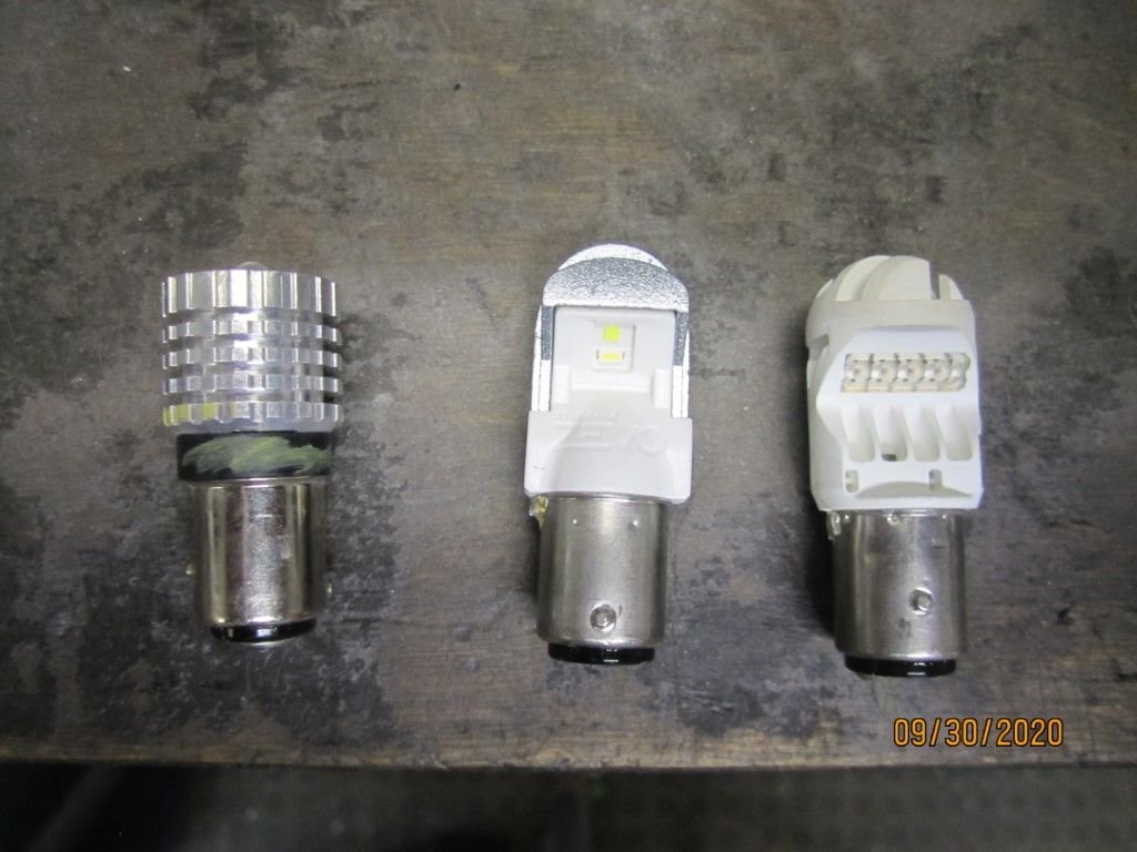

Nope, the rear LED are the same "cheap" style as the ones that don't work if they are in the fronts. Read lights are on a separate circuit so don't have that issue with the cross flashing.
Cheap one on the left, works fine if the lights are off, stops blinking if the lights are on (side keeps going)
The Zevo as well as the Phillips on the right both work properly.

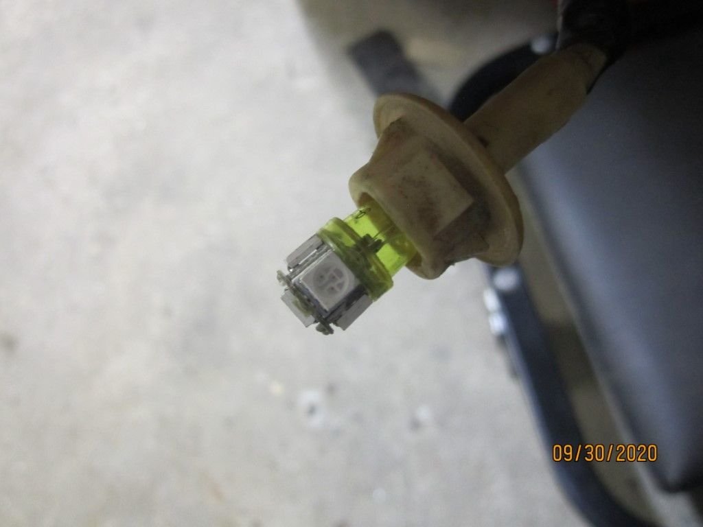

This is the no-name side marker LED
I checked and I'm running a ground wire electronic flasher with the reverse adapter

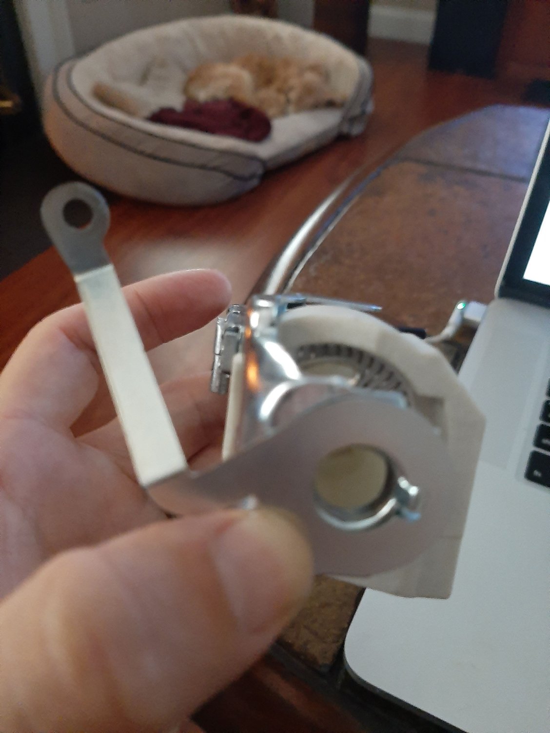

Just completed the install of my Headlight Switch with Ground strap. It took awhile to get the ground lined up with the opening in the dash and switch. The Good news it Worked! All my LED lights work fine including the signal lights with headlights on or off. The
lights look great and are so much brighter that the stock bulbs. The side lights work too. The part # is 123550 (Headlight Switch\works with LEDS) and part #392165 (Headlight Switch Ground Str.). Both from Eckler's.

Dutch that is great to hear! Nice job! Ok I will order both parts today. Any hints on where to attach that ground??? Just drill into the cage? I was just gonna order the ground strip, but for $35 it is probably worth it since my dome light does't come on from there.

My '78 had a ground screw and wire connection about 3 inches from the ignition switch already attached to the fender cage. I just ran a wire from the ignition ground over to the screw and attached it there. Worked like a charm. Good Luck. You're almost done!

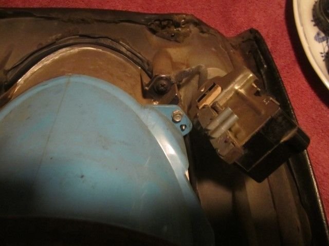

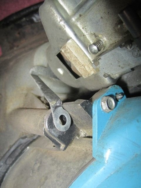

Hey So I got the parts in....this ground just sits against the switch..under pressure from the ****??
It just sits here?

Yes. Exactly as you have it shown. The small hole points towards the left fender. The ground bracket is held in place by the switch. Once installed, run a ground wire from the small hole on the ground bracket to the metal frame. That’s it. However, it did take me a number of try’s to get the ground bracket positioned correctly in front of the switch. Good luck. You’re almost there.
