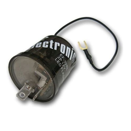

Whatever you can get locally should be fine (NAPA, etc)
This type of thing is what mine is
Mel, Richard, do you have any preference for flasher units?
M

Just to be specific-
Mechanical flashers- come originally -use a bi-metal that heats and cools- making breaking contact- causing lights to flash.
Also mechanical flashers are rated at current- so if a bulb is burnt out- less current- flashes faster.
LEDs don't pull enough power to heat up the metal and won't work with these types.
Electronic Flashers- use an internal timer that flashes the lights- will not change flash time due to type/amount of bulbs
Must use for LEDs-
There are two type- 2 prong and two prong with a ground wire.
The 2 prong with the ground are not polarity specific- the term "goes both ways"...
The 2 prong without a ground wire IS polarity specific- you must check the polarity.
