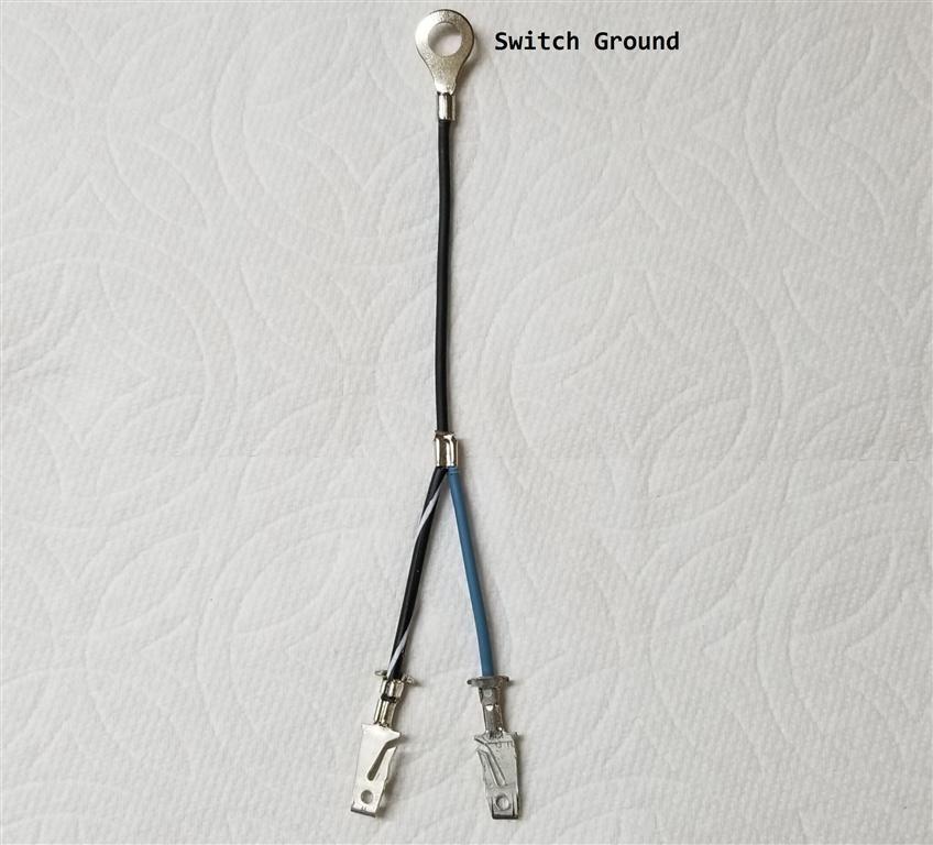

Not easy to do along side of the road but once you arrive home and until you source a new switch you can build and wire your wiper motor with a more permanent (temporary) jumper. Solider and shrink wrap the crimp connections.
If you connect both the Black/White & Lt.Blue wires to the connector housing your holding you will have Low Speed.
Pull the Black/White wire from the connector housing you will have high speed.
Never leave home without it...
Matter of fact I will change the male crimp connectors on this jumper to fit my 77 wiper harness and keep it with the other goodies that travel with me...
