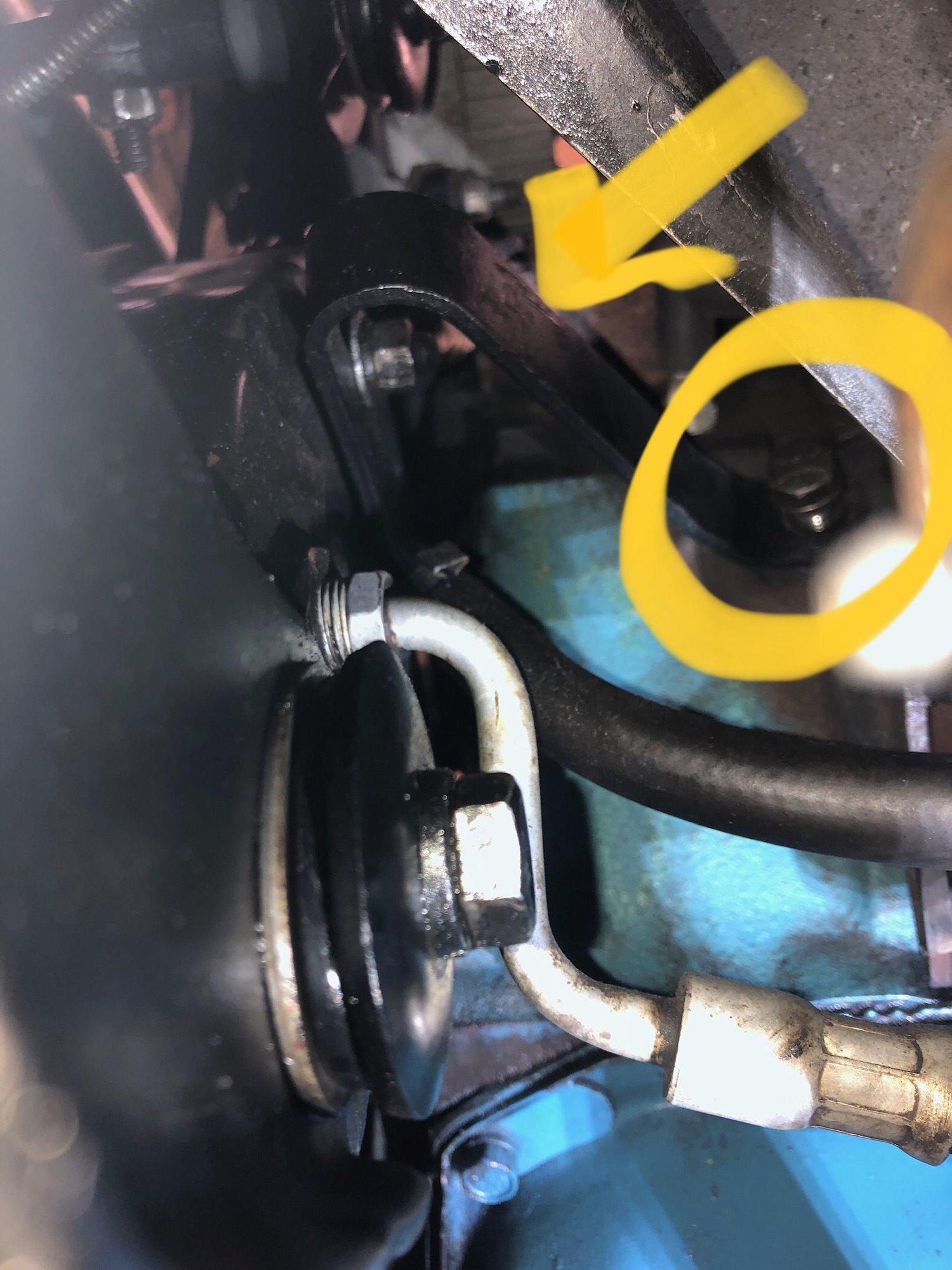

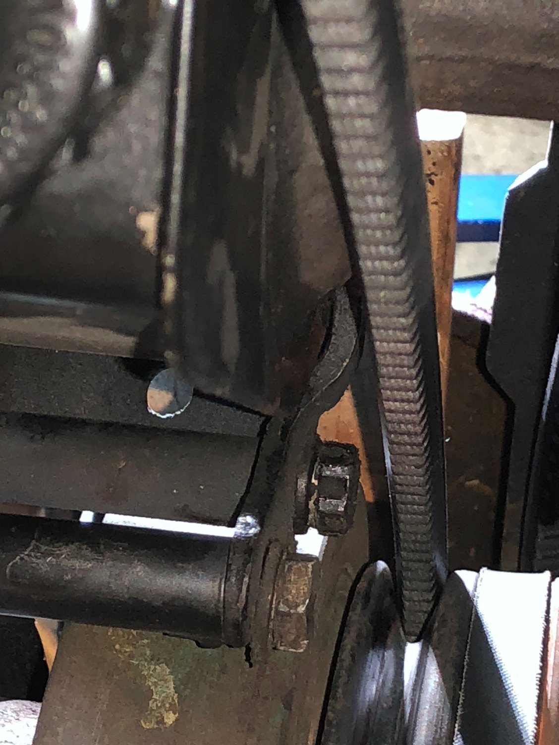

Of course the driver side is a complete PITA.
the power steering pump needs to be removed from engine so the bracket which shares the same hole as the front top mount needs to pull back to get mount to slide up.
also had to remove plug wire cover for same reason where passenger side kinda bends out of way..
btw disconnect neg battery!
also need to loosen alternator belt to get to power steering bolts..

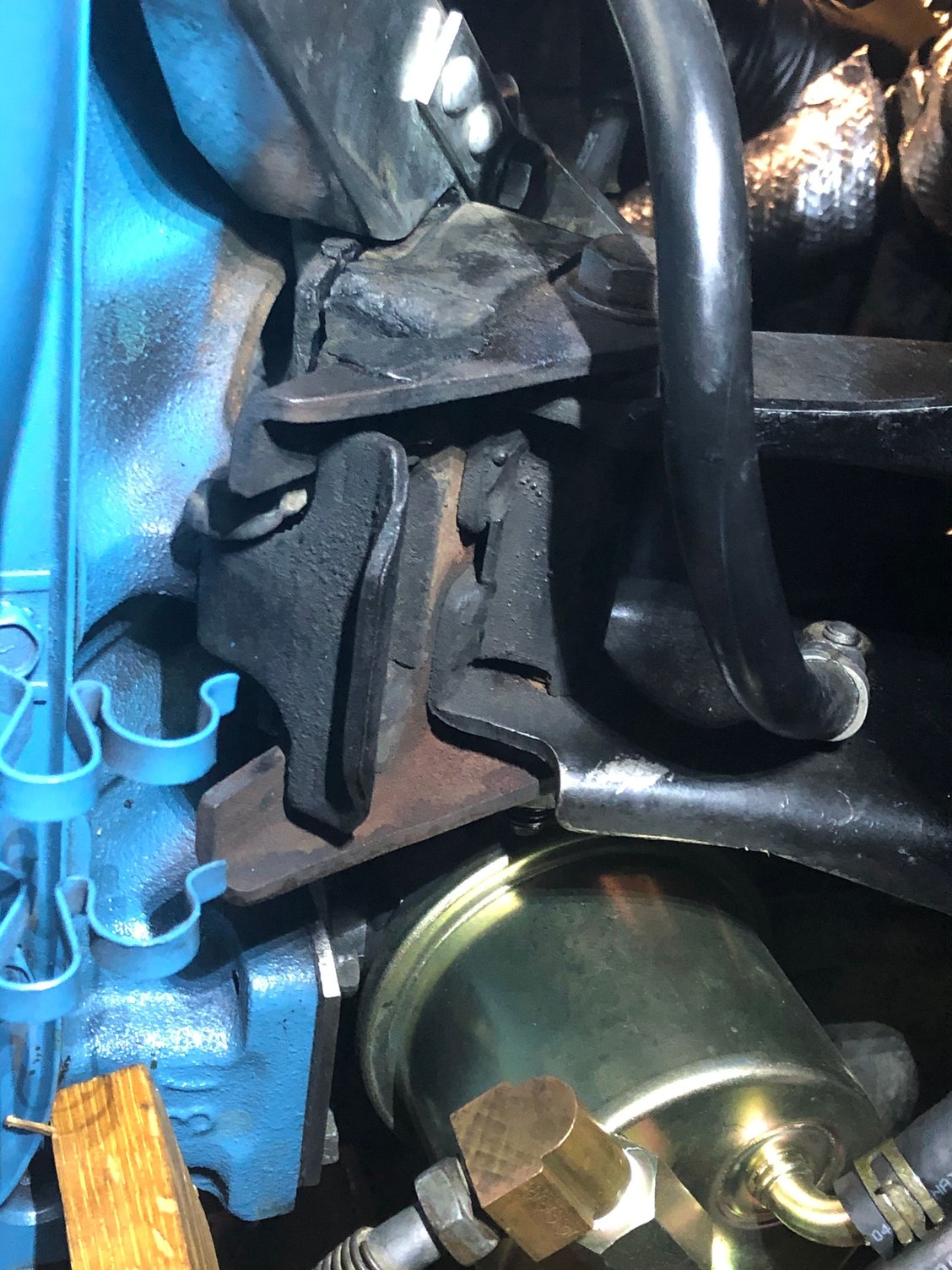

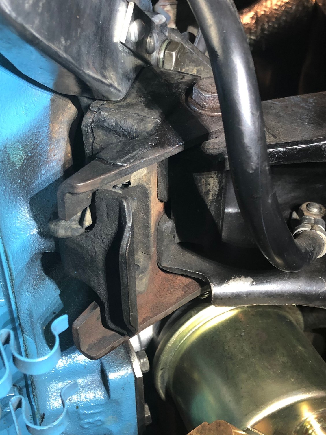

im hoping they are broke right? They look like they seperated same place..hoping this is my hard throttle whoosh sound from stop..wont whoosh sound from moving start or full throttle from other gears..

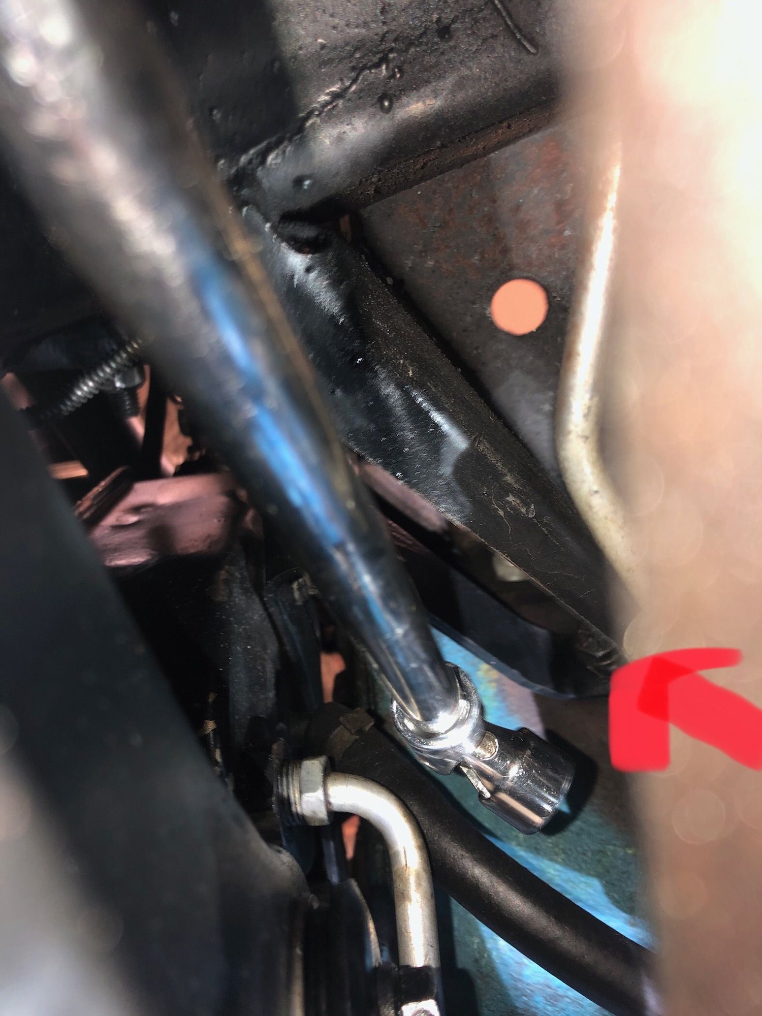

Access to bolts tight but flex socket broke them loose..not looking froward to starting the though
The infamous power steering support bracket sharing same bolt..wont slide up without backing it off
There are two bolts holding pump..i missed the lower one..had to totally remove to move pump..loosening didnt cut it

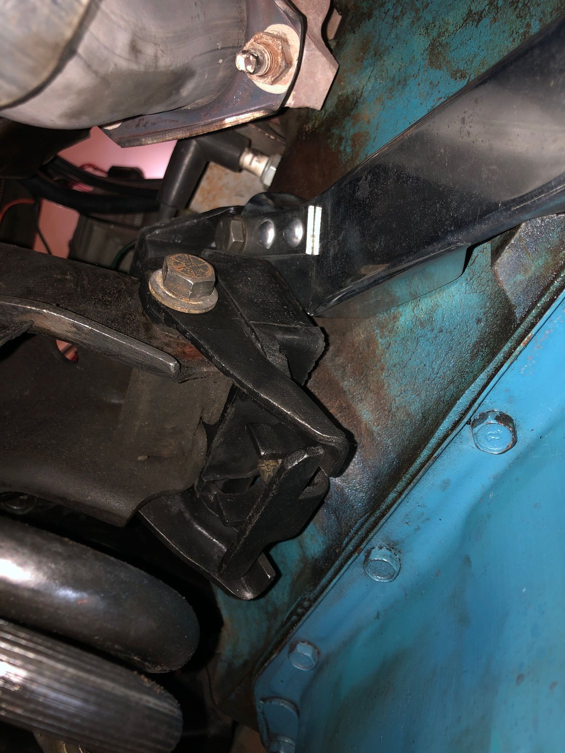

Driver top..broke right?

Yes they are totally toast! I've replaced my drivers side 3 times. Last time I did all 3. (Both motors and trans mount). Really didn't think it was at all difficult.

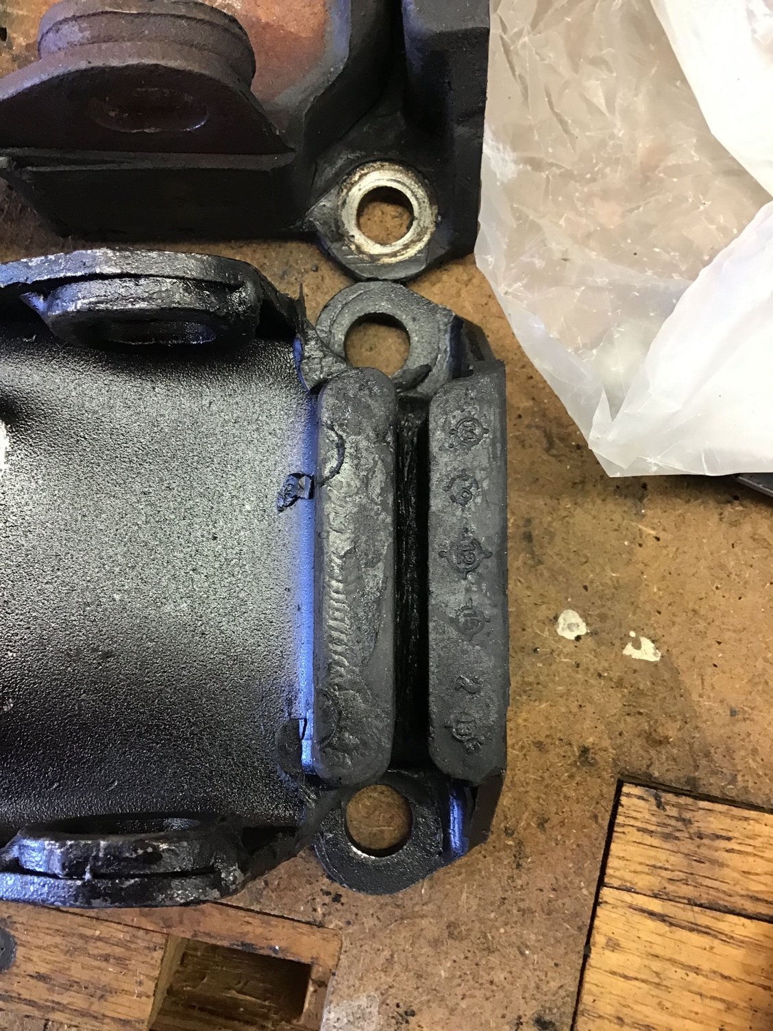

Looks like I got one made in the USA and one unknown and I have no idea what box it came in when I opened it and there are no markings on the mounts they do look similar the bolt holes seem to line up there are two different bolt head sizes though interesting if I can figure out which ones USA I put that on the driver side one might say 0MC on it.

Note the ID width difference.

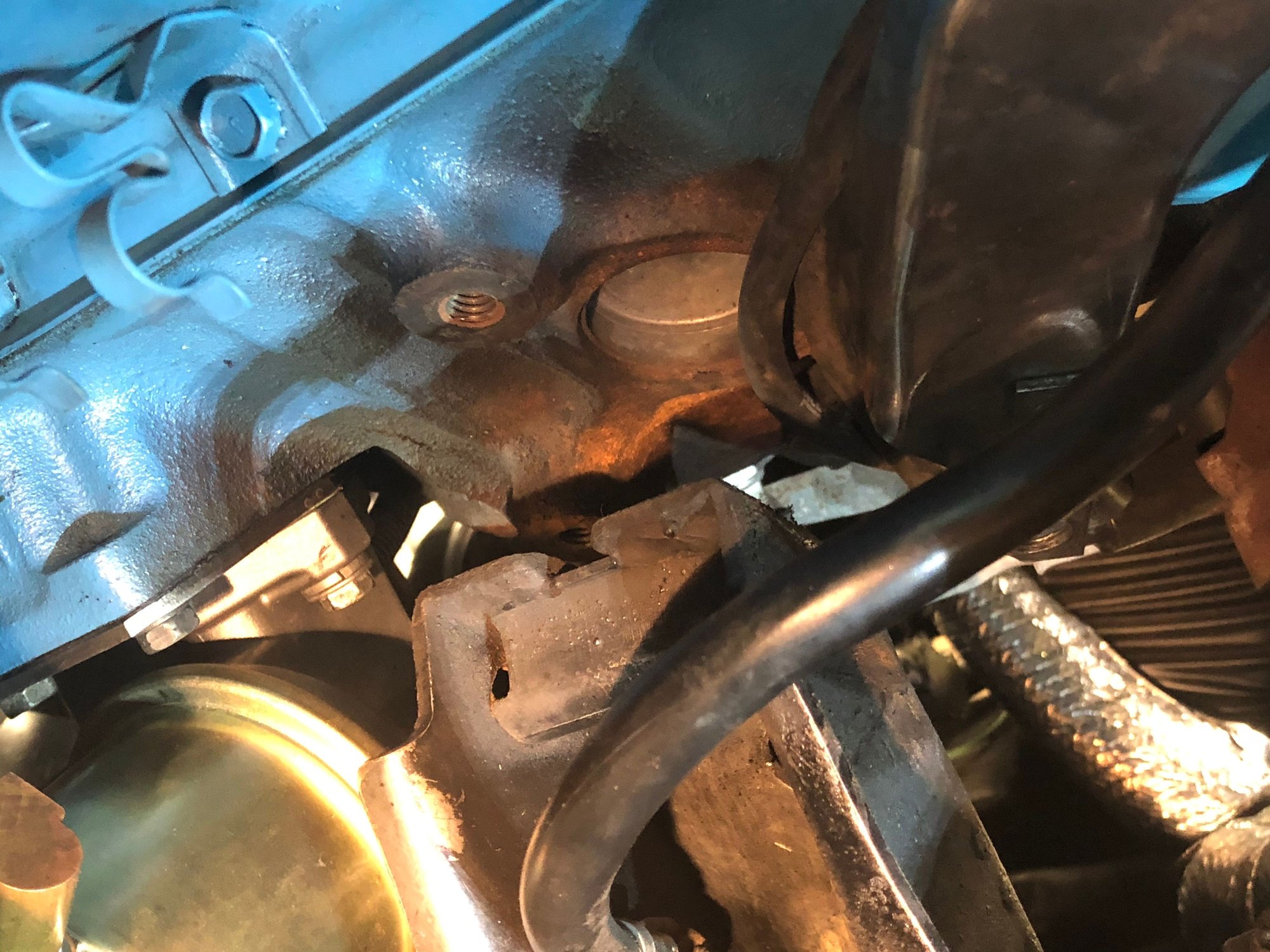

Well im stuck...taking a break..
got power steering on and the bracket etc drivers side...for me not easy getting bolts started on bracket...tghtened all 3 , wire protector..lower mount bolt slipped right in and sits loose with room to spare..
finally got passenger side on , struggling to tighten the top bolt to final tightness but a problem...
cannot get bolt to line up..
tried pounding down on the bracket from the top of the engine with a wooden stick and a hammer I tried jacking it up again and letting it drop down fast I tried grabbing the motor trying to move it down nothing the brackets appear to be the correct size everything seems to be good I can’t get that last on one side half inch on the other side pretty close do I stand on the engine?

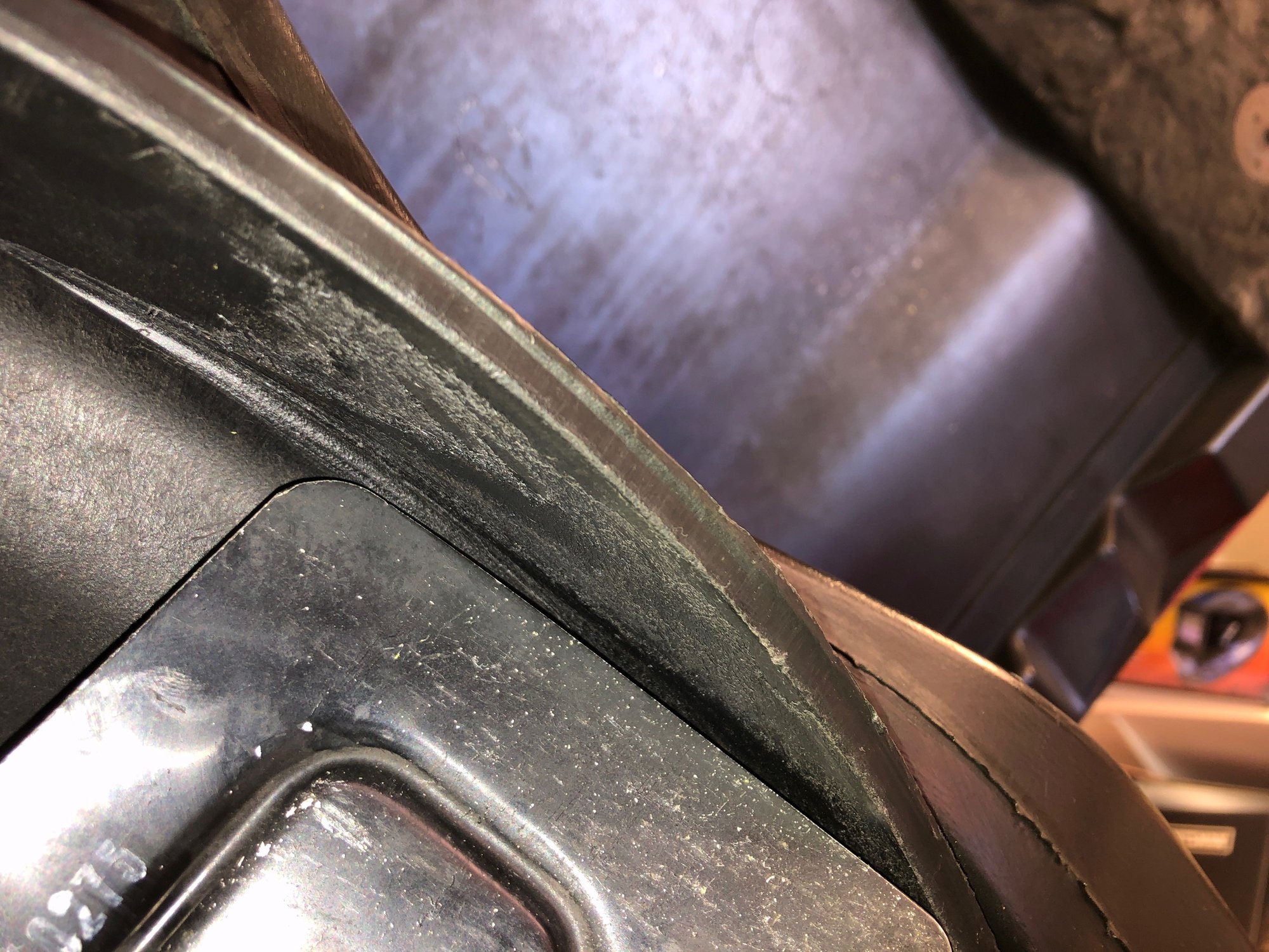

drivers side remains perfectly lined up and loose.. the fan is scraping so i know it has to go lower..its not hung up on bracket there is 1/4 on each side...
thoughts?

Back out couldn’t get socket on the one bolt from rubber...infuriating..
will trim and try agian this time loose bolts on engine but I don’t know
**** poor clearance couldn’t get socket on the lower one

i do think the whooshing sound hopefully was fan but that may be from prior..will see...clean up and test drive..

trim the rubber around bolt holes...
26 bucks at napa but if i planned i would go USA vendor to be sure..one was USA..the other? No clue..

Upper right..who knows how long mount broke
