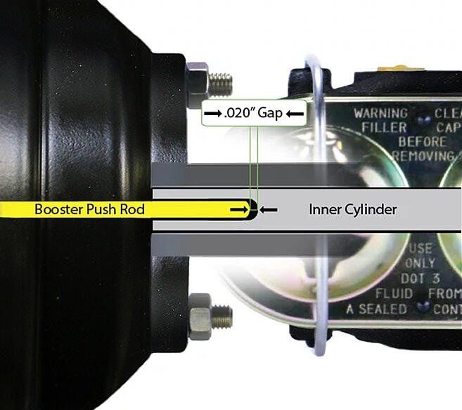

Haven't tried to lock up brakes, but i'll give it a shot. I blocked M/C and removed. the shallow hole in the M/C would make it correct and the short rod with it barely sticking out indicates the booster is correct. Both new but it's anyone's guess if the are worth a crap.

Have you seen this?
Got a soft brake pedal? Don't forget to check the brake booster pin clearance.
Brake booster pin clearance
