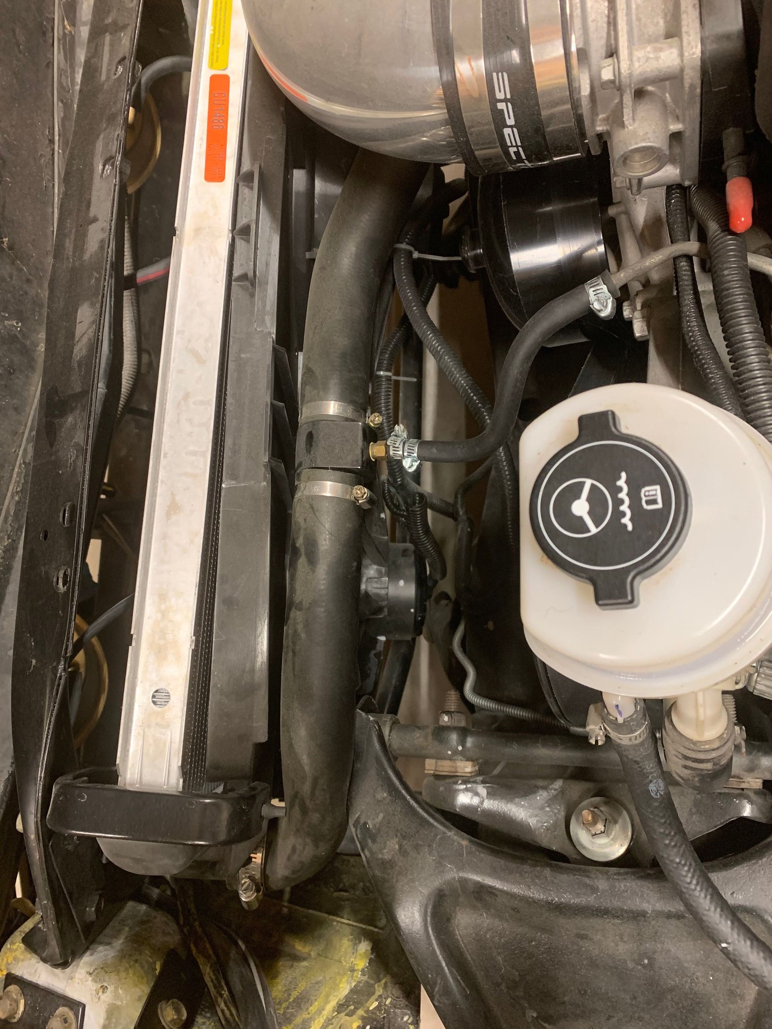

Steam port- how high up on the on the hose do you have it placed-the higher the better.
Here it is, I tied in where it was the most convenient, not the highest.

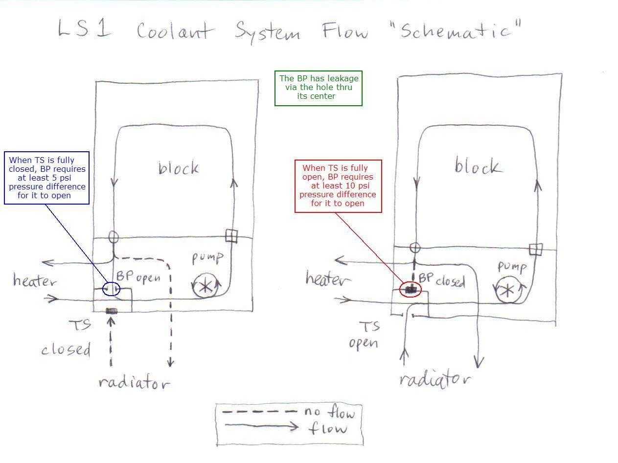

Here's a great explanation on why the air pockets will affect the LS differently-
So is the thought that there was enough of a void in the pump it could not build enough pressure to pop the thermostat?
