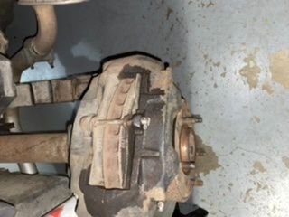

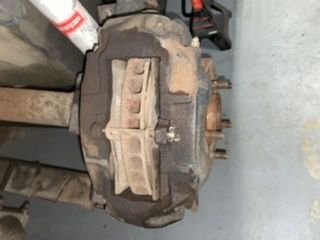

Interpol, here are pics of my rear calipers. I bleed the brakes some time ago but now I have to pump first before they grab.

look on side.. it should have markings..like this.. if not reaplce away..
https://www.zip-corvette.com/65-82-r...-lip-seal.html
yes they look bad as far as leaking..probably from piston seals
take them off... if you want to look inside loosen the bolts that hold them together first (before removal) on car as they are TIGHT..

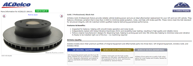

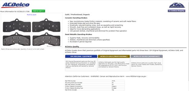

Thanks for all of the advice. So here's where I stand. Unless someone comes out and says these parts are a big mistake, it looks like I'll go with these.
Front and rear rotors will be AC Delco and pads will be organic (ceramic/organic mix) AC Delco from Rock Auto (pics below). My car will be mild with manifold, carb, headers and mild cam.

Thanks for all of the input. Just purchased these pads and rotors on Amazon. Same total cost as Rock Auto but with Amazon Prime, returns if necessary are much easier.
