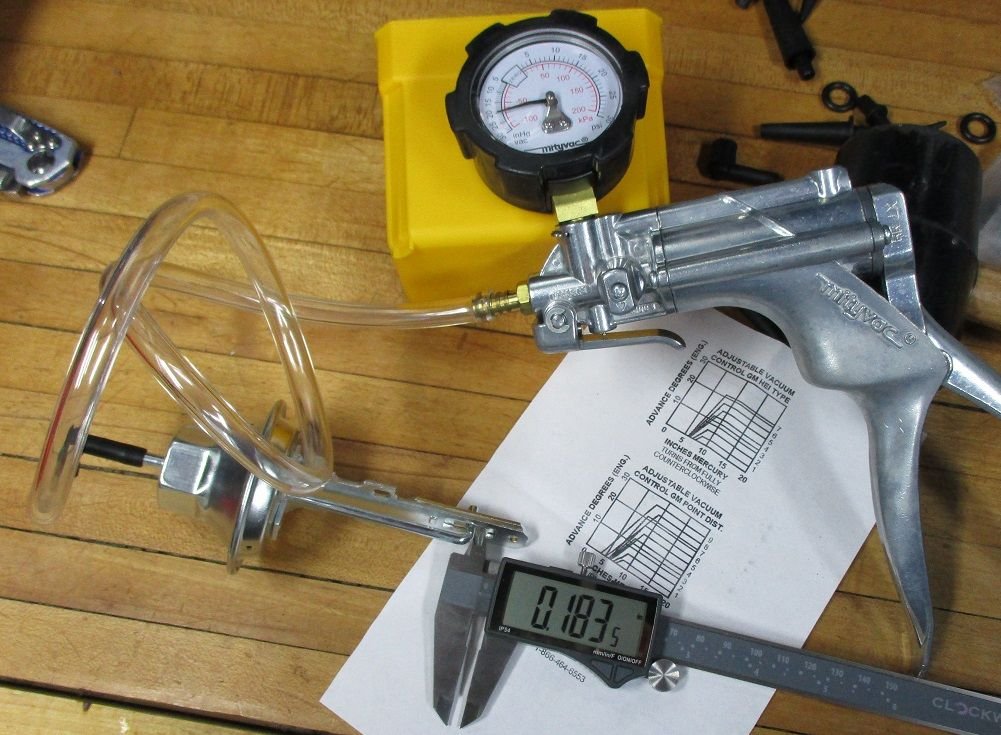

Have you confirmed that the vacuum advance is connected to manifold vacuum using a vacuum gauge (this was where I messed up, super obvious when I pulled out the gauge to set idle mixture). Have you confirmed that the vacuum can is functioning using a vacuum pump? Perhaps the vacuum can has the wrong range for the vacuum your engine actually makes at idle, or it has failed internally.
At idle, the engine shouldn't know the difference between a dist set to 30 degrees initial with no vacuum advance, and one set to 20 or so with a functioning vacuum can pulling another 10.

My 69 427 runs best at around 19 to 20 initial and the original MS360 advance can adds an extra 12 degrees. Are you sure your vacuum advance can is working correctly and checked with a timing light? If your vacuum advance is frozen I can see how your engine would like 35 initial at idle but not if everything is working properly.
Stop being so logical. The OP is out of ideas, but insists on not discussing vacuum advance.

We all want to help (why else would we haunt this Forum), but please give us something to work with. We can't see what you see, and we can take measurements on your car. Lots of folks asked simple questions. If you can provide some more information, the real experts on this Forum will figure it out.
Do you have a vacuum gauge and/or pump? Can you tell us what your vacuum reading is at idle? My mostly stock L48, with 8.5:1 compression or whatever, will idle just fine at (effectively) 27 degrees initial advance. It is very rough and hard to start with less than that. Other than your hot engine, and three degrees, the only difference is that my initial advance is half mechanical, half vacuum.
