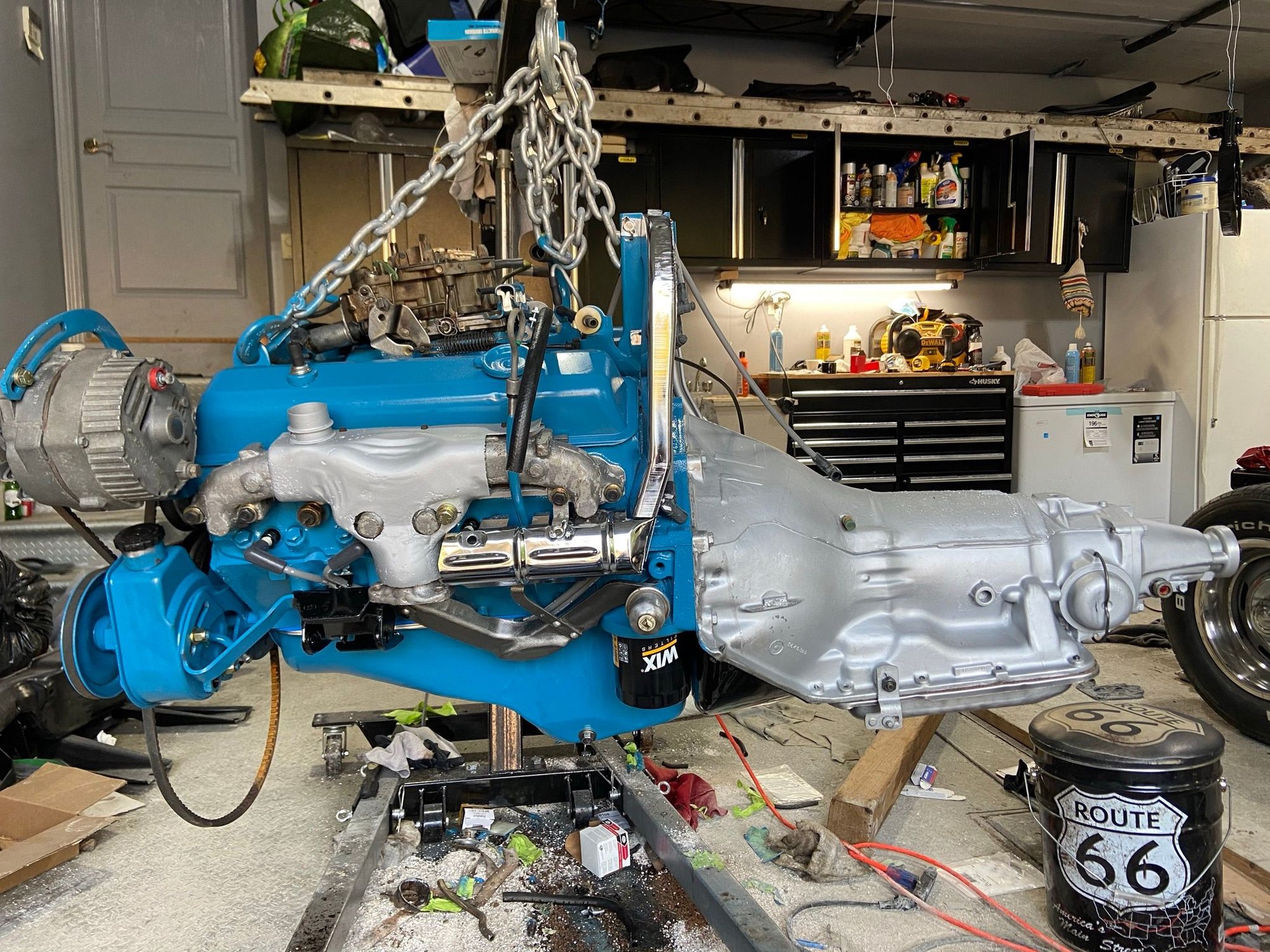

Hello engine expert,
I need help. I'm doing a frame off on my 1977 and now I'm reassembling everything on my new frame.
The engine was sitting outside my garage for the last 5 months. I had a cover on top of it but, I had not reinstalled the air cleaner bowl. So I cleaned and painted the engine and everything that comes with it (see pictures). Allot of hard work and time but very satisfying. Before putting back the body, I decided to do a compression test. This is when I realized that bit of water pass through the cover and got inside the engine, not a good thing I know. I removed the water, blasted air through the cylinder. And put a bit of oil in those cylinders to moist the seal. It did increase compression. The passenger side of the engine (cylinder 2,4,6,8) are all around 130. However the driver side (Cylinder 1,3,5,7) are at 110, 100, 80 and 80. What could cause this? I don't want to tear up the engine..too expensive. Can I run with it and maybe after a while things will get better:-)

A compression test on a cold engine that has been in storage as you stated is not very meaningful. The numbers are not indicative of a problem. Put the engine in the chassis, stick a radiator in front of it, hook it up, and start it up - it's easy to do. Let it warm up, and then do either a comp test, or better yet, a leakdown test on it. It would take you half a Saturday and 6 good Canadian beers to mount it and fire it up with some jumper wires - worth the minimal amount of time it would take to do. Make any decisions based on that relevant data.

If your motor is stock and has no performance improvements then you have nothing to loose just buying a GM crate motor "Hecho in Mexico" to replace it - less than $2000. Otherwise your gambling with your time and labor you can make that old motor work. Don't you think your frame off car deserves a new motor? That or re-ring and re-bearing with a valve job on the stock motor while out of the car.

Lars, yes it was cold and not running for 5 months, so I will do as you say and hope for the best. Sorry for my ignorance but what is a leak-down test?
I want to keep the numbers matching so the worst solution would be to do a completed rebuild of the engine.

A leak-down test is a method of evaluating engine "health" by blowing a known pressure of air into each cylinder and measuring the amount of leakage present in each cylinder. The leakage can be isolated to valves or rings, and provides a quantifiable measurement independent of the engine's compression ratio and cam duration (which will affect a normal compression test).
You can see the process here (there are many other You-Tube videos out there - check out a few of them and you will get the idea):
The video indicates that a leakdown less than 20% is in the "acceptable" range, but I would say that the "good" number is 15% or less - if you are below 15% leakdown on all cylinders, you have a good, serviceable engine. Obviously, if you're over 20% on any cylinder, you need to bite the bullet and do some work...
The video shows the guy doing the leakdown at TDC. I have found this is not always the best idea: Putting the piston at TDC with 100 psi of air injected into the cylinder will usually result in the piston being forcefully pushed down to the bottom of its stroke, which will open the exhaust valve (a 4-inch bore Chevy 350 has a piston surface area of 12.56 square inches - when you put 100 psi across 12.56 square inches, you are applying a total force of 1,256 pounds to the top of the piston, and it will be pushed down...). To avoid this situation, I like to pull the valve covers, remove the rockers arms, remove all spark plugs, and then do the leakdown, just allowing the pressure to push the pistons down to the bottom of their stroke.
Summit Racing sells some reasonably priced and good leakdown testers with instructions. Summit ships to Canada:
https://www.summitracing.com/parts/otc-5609
https://www.summitracing.com/parts/wmr-w89729
The numbers provided by a leakdown test (after having run the engine) will provide you with the real data you need to determine the health of the engine, and whether or not to spend time & money on a rebuild.
