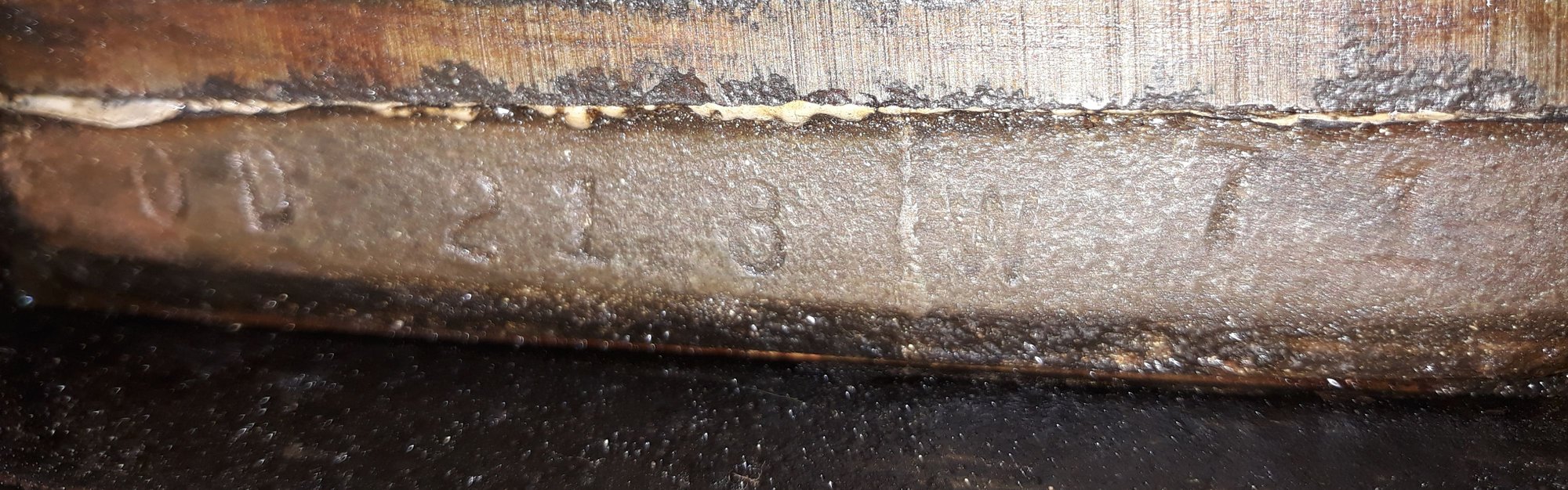

OK, so I've been under my car a fair bit lately. And mind you, I've owned this car for over 30 years now. Fairly early on I found the diff cover had been changed out to a heavy duty unit. Never gave that much thought. And a number of years ago, long before I was even a member of this forum, I put in hardened yokes. But today, I noticed these numbers stamped into the bottom of my diff that I never really paid any attention to before.
Now I'm wondering if the 71 on the end might mean this diff is out of a 71?? Anything here tell anyone anything? Ratio? Am I just looking once again at useless numbers? Thanks much for any insight.

Looks like OD 218 W 71
If correct,
OD: 3.36 posi, 1977
213: Julian, Aug 6, (1977, not a leap year)
W: Warren plant
71: Don't know, 7 could reference the year year, since it decodes to a 1977. 1, Warren shift 1?
https://www.ecklerscorvette.com/asse...ette/43825.pdf
Best guess

Agree 7 is for 1977 the 1 is first shift

The OD code was used only in 1976 and 1977 so at least the case dates to 1977. Concur the “1” indicates assembly on first shift.
