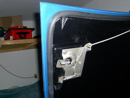

Yep,,, The 68's are different. This is a pic of the pax,,,, right side latch. There is nothing to hook a wire to. There is a hole in the fire wall covered with a rubber plug. This side you can get a screw driver through the hole to unlatch this side. The other side I think you can run a wire straight down to the underside of the car that can be reached. Has anybody done this?

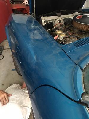

You can lay on your back and reach up to toggle the driver's side release that, because of the cable, releases the passenger's side also. This is 68. Can you see the fingers of my left hand?. (The driver's side door is open, hence the gap.) To get your hand in here you have to remove a triangular dust shield that's attached to the body and the inner wheel fender. It's very easy to take off and re-install.....4 bolts I think. Same for the 69.
If you have a 70 - 72, you're better off. Remove the egg crate louver grill and stick you hand up there to toggle the driver's side female latch lever. With the louver grill removed, it's easier to get your hand in the right place with the 70 - 72.
Whenever I'm re-installing a hood and fussing around getting it aligned, I tie a plastic coated wire on the driver's side hood female latch lever. When I close the hood, I leave the wire dangling out so I can pull it to release the hood if the hood release handle doesn't work. Works fine. I guess you could just tuck this wire up under the wiper door and hide it so you'd never have to remove it and have an easy second way to release the hood.

Here's my 68 hood, notice the V in it? It lines up in front of the latch.
If the handle cable snaps , remove the grille along the hood and slide a long thin screwdriver down there to push that tab and pop the hood open, (providing the other cable is ok)
