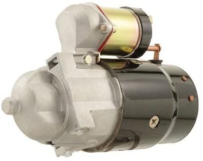

I would like to try a different mini style OEM starter than a "Hitachi style mini starter" on my 421 CI SBC. Its a Dart SHP block, with a 700R4.
Im getting occasional grinding after a lot of shimming and starter nose pinion replacement.
would this fit? Or is there one that will fit? I think I want to try one with the support on the pinion end.
this one is for a 1995 corvette application:
https://www.amazon.ca/ACDelco-337-1016-Professional-Starter/dp/B007QBSYHC/ref=pd_lpo_263_t_0/139-7440095-6150524?_encoding=UTF8&pd_rd_i=B007QBSYHC&pd_rd_r=c27e0edd-f173-4828-98f2-deb9550d9982&pd_rd_w=dygTD&pd_rd_wg=mjWzN&pf_rd_p=256a14b6-93bc-4bcd-9f68-aea60d2878b9&pf_rd_r=T3PP7CE2HTJ4HJZ4BFJ5&psc=1&refRID=T3PP7CE2HTJ4HJZ4BFJ5 https://www.amazon.ca/ACDelco-337-1016-Professional-Starter/dp/B007QBSYHC/ref=pd_lpo_263_t_0/139-7440095-6150524?_encoding=UTF8&pd_rd_i=B007QBSYHC&pd_rd_r=c27e0edd-f173-4828-98f2-deb9550d9982&pd_rd_w=dygTD&pd_rd_wg=mjWzN&pf_rd_p=256a14b6-93bc-4bcd-9f68-aea60d2878b9&pf_rd_r=T3PP7CE2HTJ4HJZ4BFJ5&psc=1&refRID=T3PP7CE2HTJ4HJZ4BFJ5

FYI, that is not a mini-starter and it is not a stock style replacement from a 95 Corvette since that is a 153 tooth flywheel application and would be the straight across bolt pattern.
A mid 90's pickup application would get you a 168 tooth starter. Lots of people like this one, which looks pretty similar to a stock starter.
https://www.dbelectrical.com/product...sdr0019-l.html
If you just want to experiment with a cheap starter then get this one. Make sure you get the right bolts too. The application chart does list engines like the 454 and 8.1L which I believe is correct so GM expected that design to spin over a big engine which means it ability to start your engine might just surprise you.
Just throwing this up since I believe all of the starters recommended so far are of the design type the OP has posted he wants to avoid.
