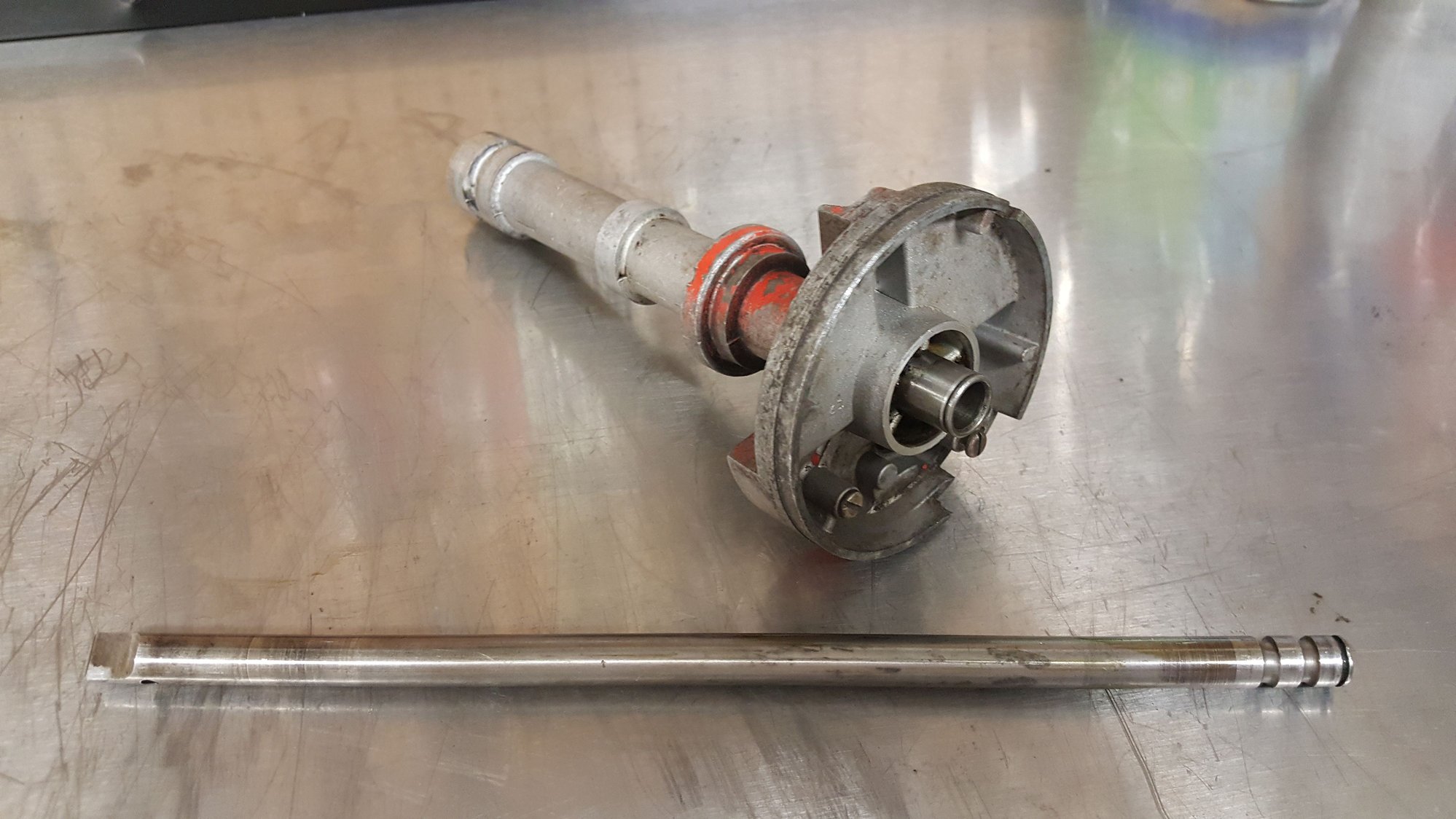

This is what I have been using for as long as I can remember. Just need a core, a hammer, a punch, and a screwdriver. No real need to destroy a gear this way. Obvously you can improve on it but it does get the job done.
