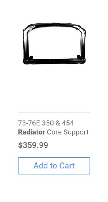

Same core support big block and small block!
This is the small block rad cushion. Note how it's real wide on one side? The big block cushions are narrow on both ends for the thicker rad.
I'm telling you all you need are the upper and lower cushions. Many,many guys have done this.
