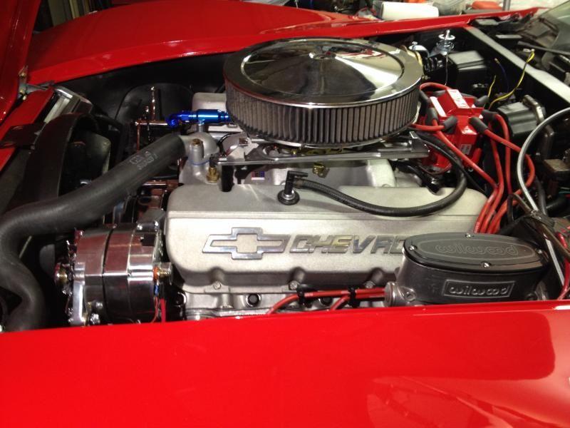

This car was running fine when I parked it this time last fall. I replaced the fuel sending unit O-ring and it sat, without fuel, until today. I put fuel in the tank, filled the carburetor fuel bowl and gave it a couple good shots of gas from a bottle and tried to start it.....NOTHING. Ok , next I checked for spark on number one plug....Good. Couple more pumps of fuel at the carburetor... hit the bump starter...Nothing. Maybe the plugs are fouled...New plugs ,correctly gaped and try it again,....NOTHING. Next I ran a wire straight from the battery directly to the bat terminal of the distributor thinking maybe poor voltage and tried to start it once more....NOTHING WTF, NOTHING. What am I missing here? It was running perfect and doesn't have more than two hours on it since installation.
