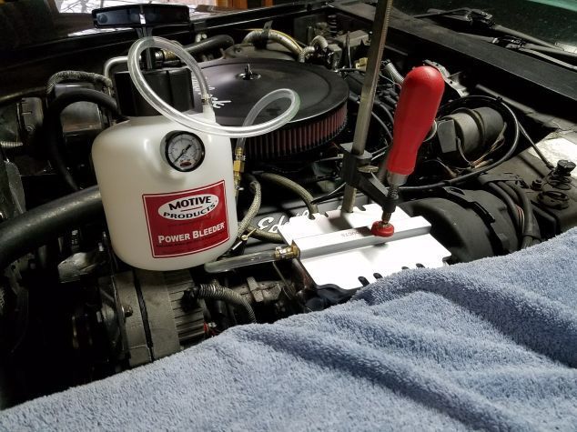

While we're spending the OP's money, pick up a Motive Pressure Bleeder, with the correct cap. I also have a pair off their bleeder bottles. There are lots of Forum threads on this item. Some use it with fluid. I only use it to add pressure. But it may save you some time, and yield better results.

If you pressure bleed it, (highly recommended), and keep the pressure at about 7-10 PSI, it's not enough to move the spool inside the prop valve. You'll get good flow at this pressure, without taking any chances.
It worked well for me when I pretty much rebuilt the brake system, changing almost everything except the front callipers and all the steel lines, which were fine.
I don't think pedal bleeding is recommended for this system by anybody. I tried it and got nowhere.
