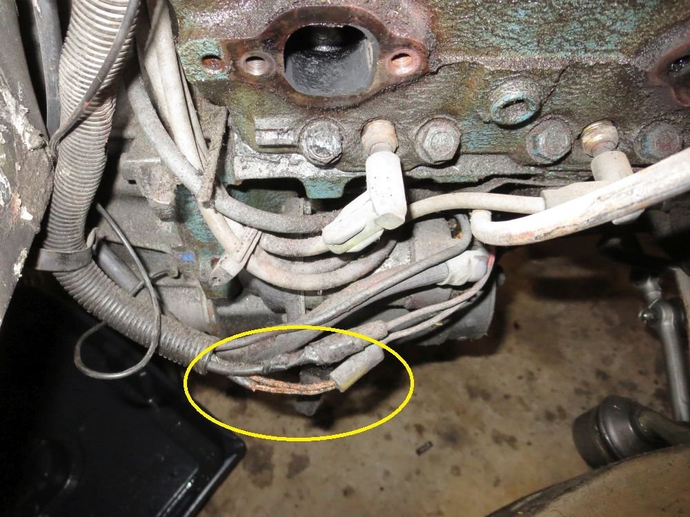

Do you have a multimeter with a current measuring circuit? How much current is being drawn?
With the alternator disconnected, and all fuses pulled, all that is left is a short within the starter, or possibly the starter extension harness.
Do you have any other wires tapped to the battery, starter, or elsewhere, possibly added by a previous owner?
Here's what the starter extension harness looked like in my 80, before I replaced it. If yours has also melted away the fusable link insulation, but hasn't yet failed, you may have a short there. In my case, it was a lot easier to see with the exhaust manifolds removed.
