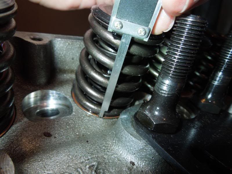

Originally Posted by speedreed8
I talked to a tech at Howard’s cams. They set me up with a matching spring / retainer set for my cam and spring locators & seals. Hopefully it will work well. I’ll keep post updated after repairs. Thanks for everyone’s advice it was very helpful. Especially about the spring locators. 👍
The pockets are probably 1.46 inches. the larger the diameter of the spring the cooler it will run and the longer they keep their listed pressures. Tell Howards that you would like something like 130 -135# on the seat. But you need to figure out the present installed height when you talk to them. This isn't as exacting as a micrometer, but it is very close.
The galling on the taller ARP studs is from the .700 + lift cam with 240# closed pressure and over 700# open. Dart race ported 227cc heads with 2.10 in and 1.625 Ex. My vette heads

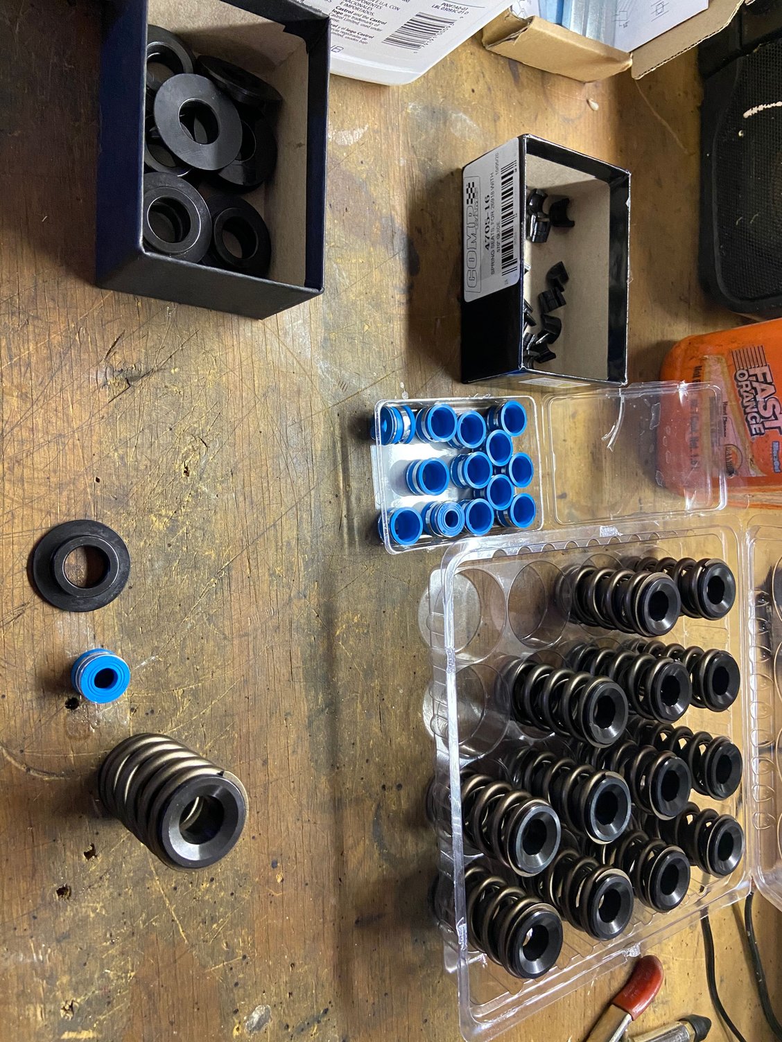

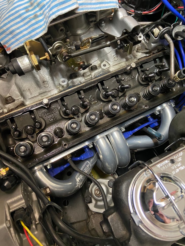

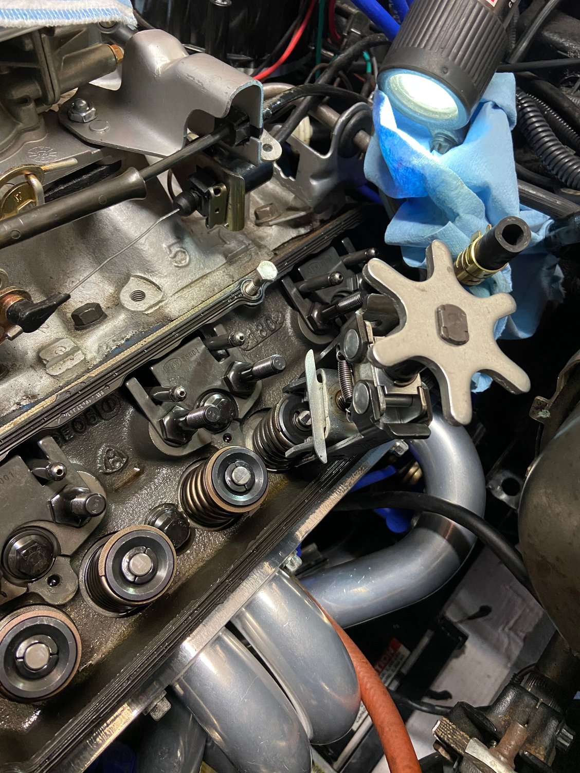

Update: I called Howard’s cams and Dart machine (thanks Jeb for the ph. No. ). Dart said to run Howard’s recommendation for spring. Dart tech said don’t get hung up on spring día. Just run a locator and it would be fine. So that’s what I did. Howard’s 1.25 spring kit and seals. 130 seat press. 380 open press at 1.808 installed height. And a spring locator. Everything fit perfectly. Oil change. Cut open the oil filter and no metal. Up and running great. Thanks for everyone’s help. A few pics of the install. I think the old springs may have had a seat press of 90lbs. They were really weak compared to the new ones.
