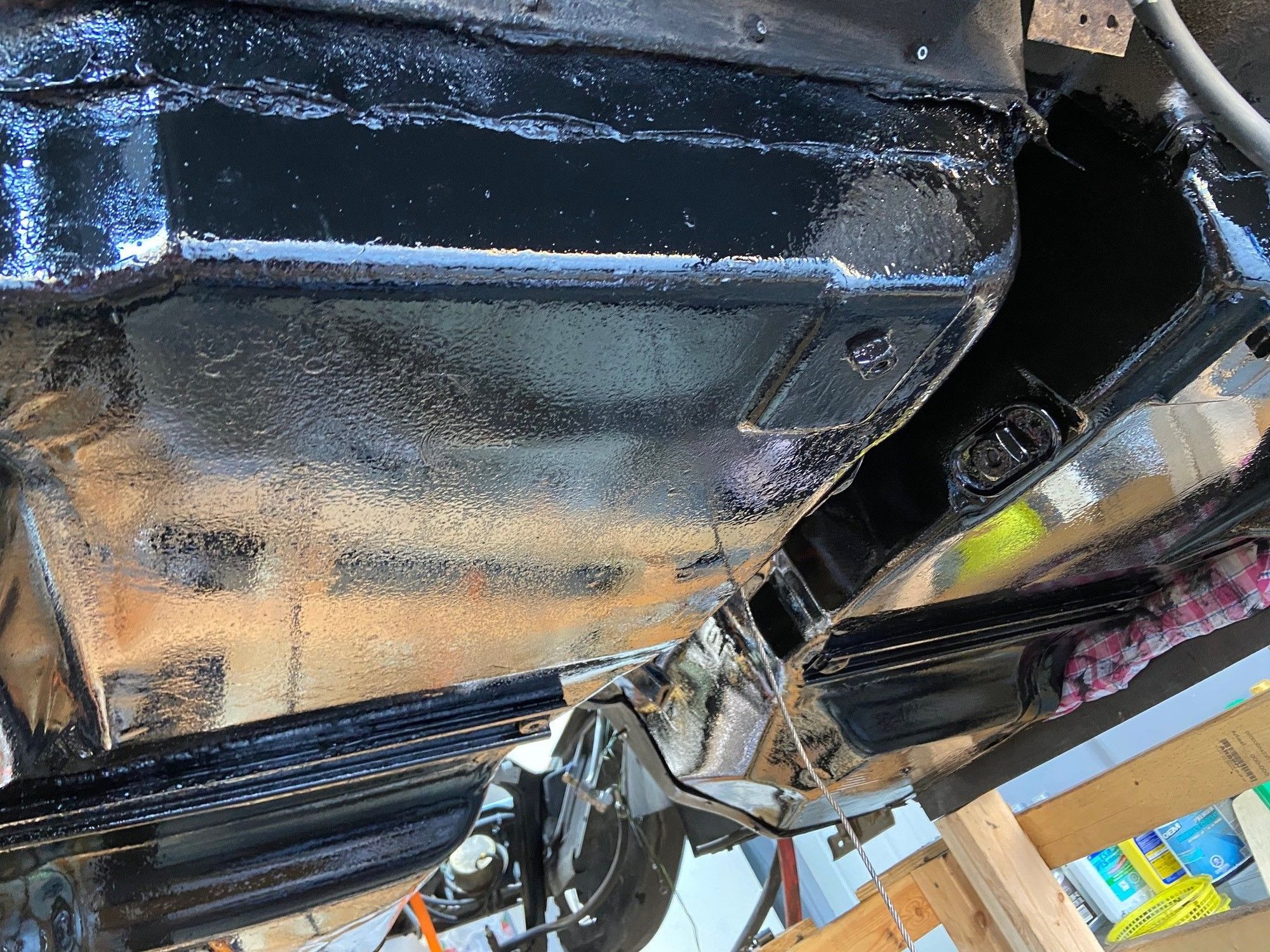

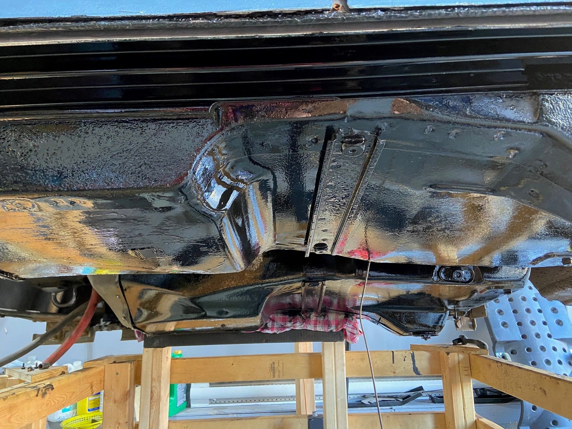

Hi Corvette lovers,
I'm almost done with my frame off.
Putting the left side Chanel Insert, as well as #4 insert. It is weird because the hole in the Chanel and the hole in #4 doesn't perfectly match as you will see however, the hole on # 2 does.
Everything has been cleaned. From the front to the back, all birdcage undercarriage was cleaned and painted with POR15 gloss black. Looks very good. Thinking of putting a coat of clear paint on the rear section to make it easier to clean in the future. Not sure if it will stick to fiberglass.
My question is regarding the engine bay. I would like to paint it with POR 15 gloss black as well. Just not sure if it will stick to fiberglass. I have read in previous threads that it should be in flat black paint. In any case, I want to make sure that I can keep it clean without removing the paint every time I'm put a cloth on it.
Feedback /suggestion?
Denis

did you brace the cage at a higher point before you cut the rocker channel out ? I remember DUB saying some cages have a built in force that's released when you cut a section out .
I replaced both channels on mine , with parts from a 74 wreck and all holes lined up perfect .
Have you measured to see if there's any difference in the door gap area ?

Thanks gents,
Yes, the cage was attached at a higher point however I did not cut the Chanel as I also had to replace #1. The insert to replace #1, comes with #2 with it (it's all in one piece). So I put in the (#1, #2) insert first. Welded-in place and then put the (#2, #3) Insert and welded this one as well. I knew that it would not perfectly match in lenght. Seems like the (#2, #3) insert is 3/4 of an inch short. But it was either that or I had to cut a piece of the (#2, #3) insert, which I did not want to have more strength.
