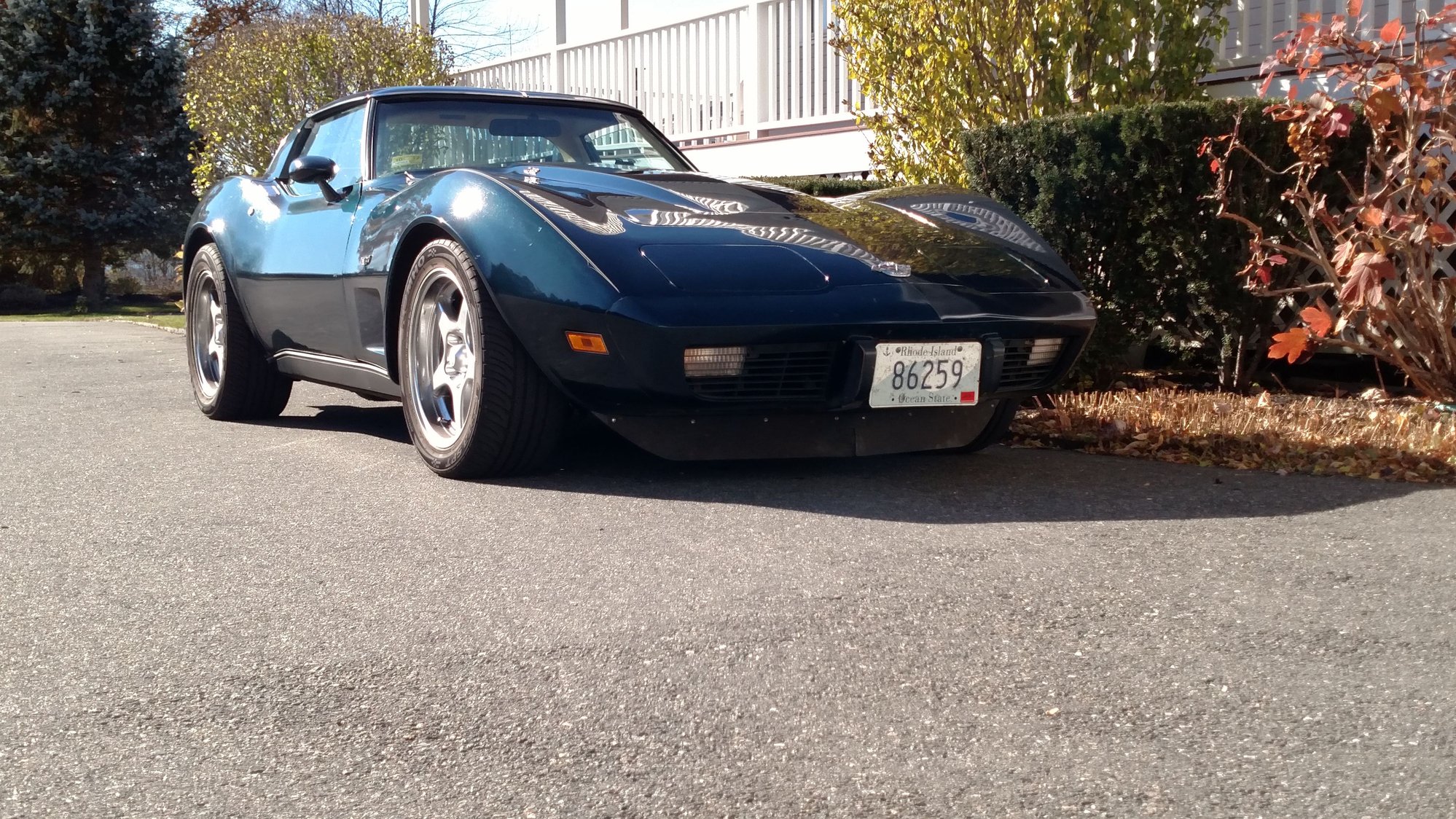

A solid C3 rear suspension with composite spring, like new axle shafts/rear diff, Bilstein Shocks competition heim jointed struts ius pretty tough to beat on the street for a C3 AND will ride much better than the C4. C4's ride very stiff and are not great riding for the street...just saying..my car below:

My 78 above is far superior to any stock handling C3 BY FAR. Does it handle like my 10C6Z06? NO! It will smoke just about any stock lightly modified C3 in the curves..no contest.....and no Stock SBC C3 of any year or engine designation can even come close to the rebuilt/upgraded 355 L-82.
