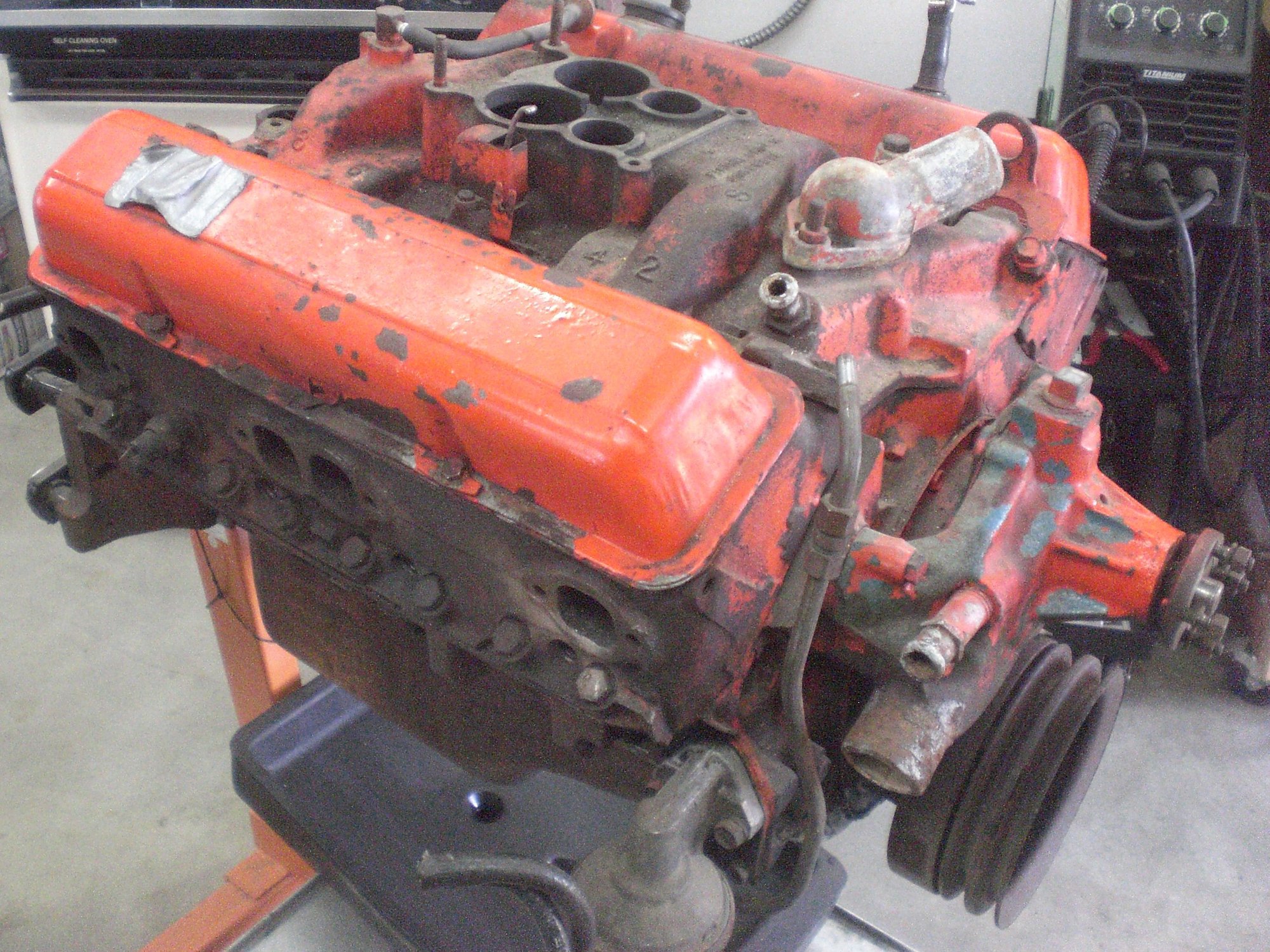

The old gave way...

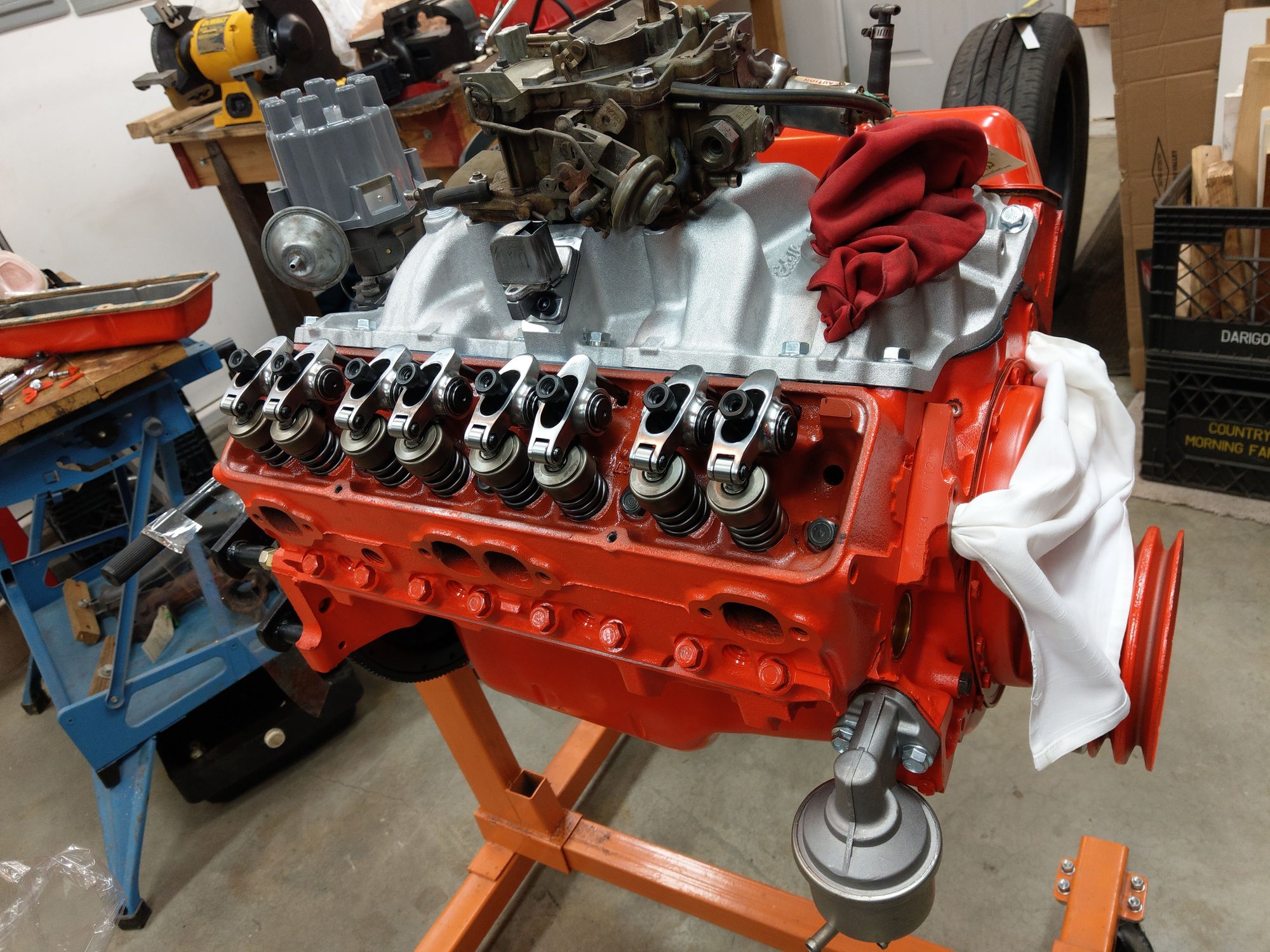

...to this "new" baby
The engine now has a COMP CS 270H-R10 roller cam with 215/215 duration @ .050; lobe lifts of .3340, and separation of 110*. It also has hydraulic roller lifters and full roller 1.5 rockers with a double roller timing chain set. Also put in an Edelbrock Performer 2101 dual plane intake. A new Carter fuel pump, the original Quadrajet (hopefully to be overhauled by Lars), and an overhauled & recurved distributor will all feed the engine fuel and spark. It'll be connected to the basic 4-speed and will be used for normal street driving (normal for a CORVETTE ) using pump gas. No racing or autocross.
