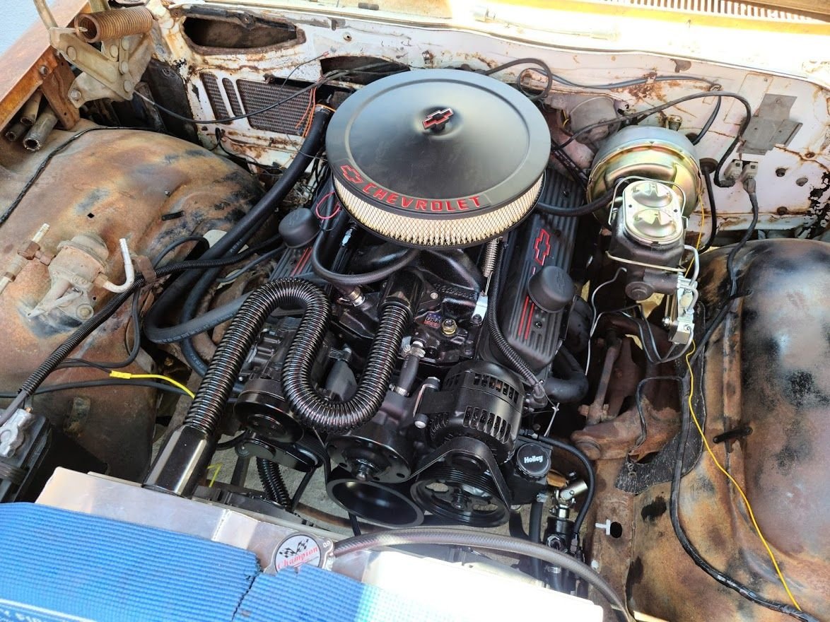

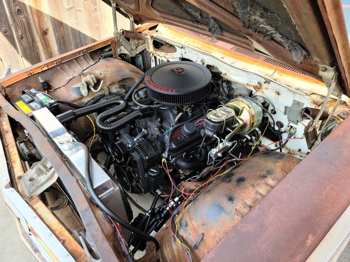

From: Torrance Ca
I'm currently installing the Vintage Air system so I'm removing the old AC compressor (in photo) and installing the Sanden with their bracket. I'll post a pic when installed

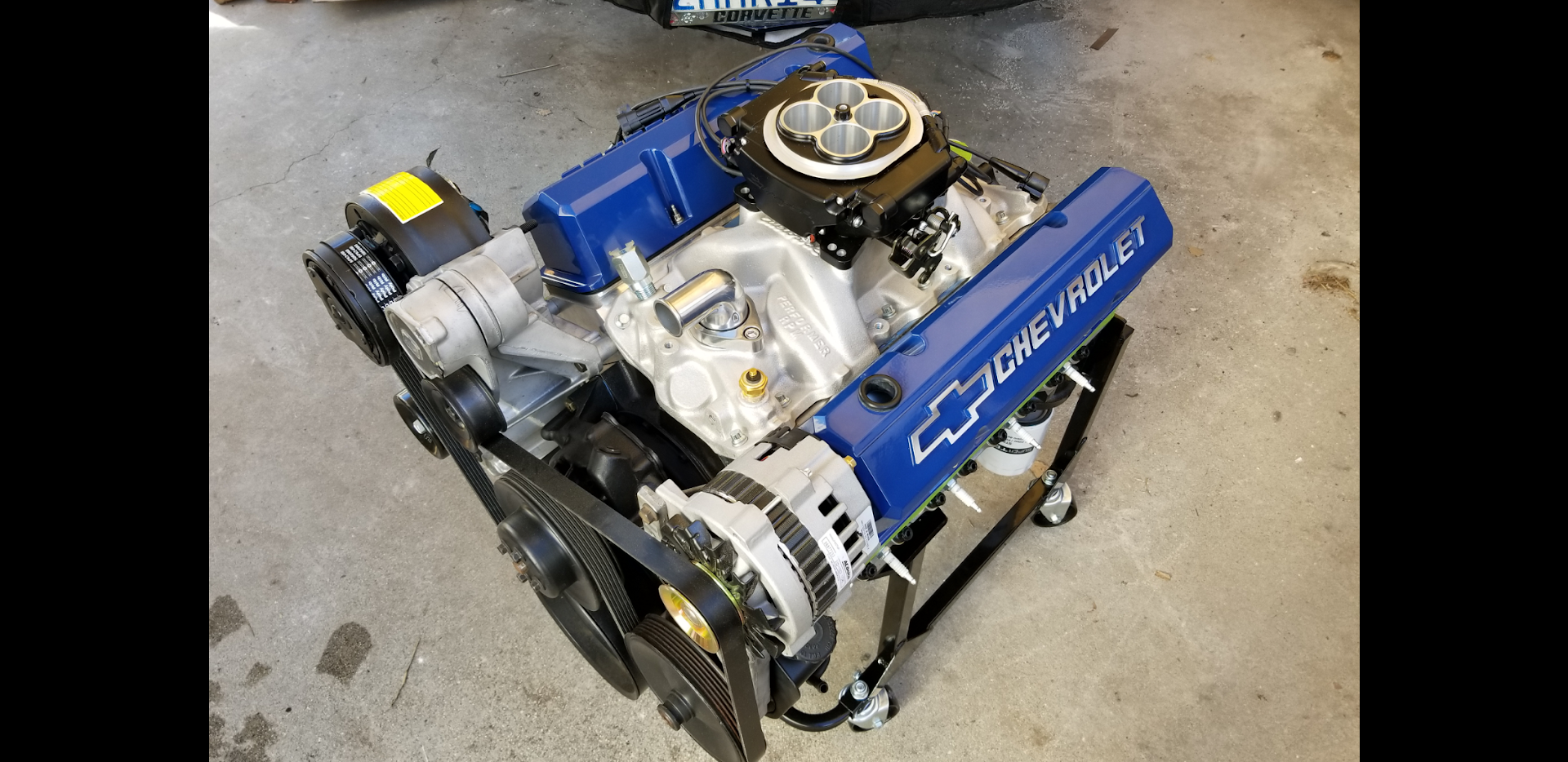

Annnndddd THIS is the Holley frontrunner system we installed on a customers car. Expensive but includes everything AC ALT PS etc, and everything attaches to the water pump.
