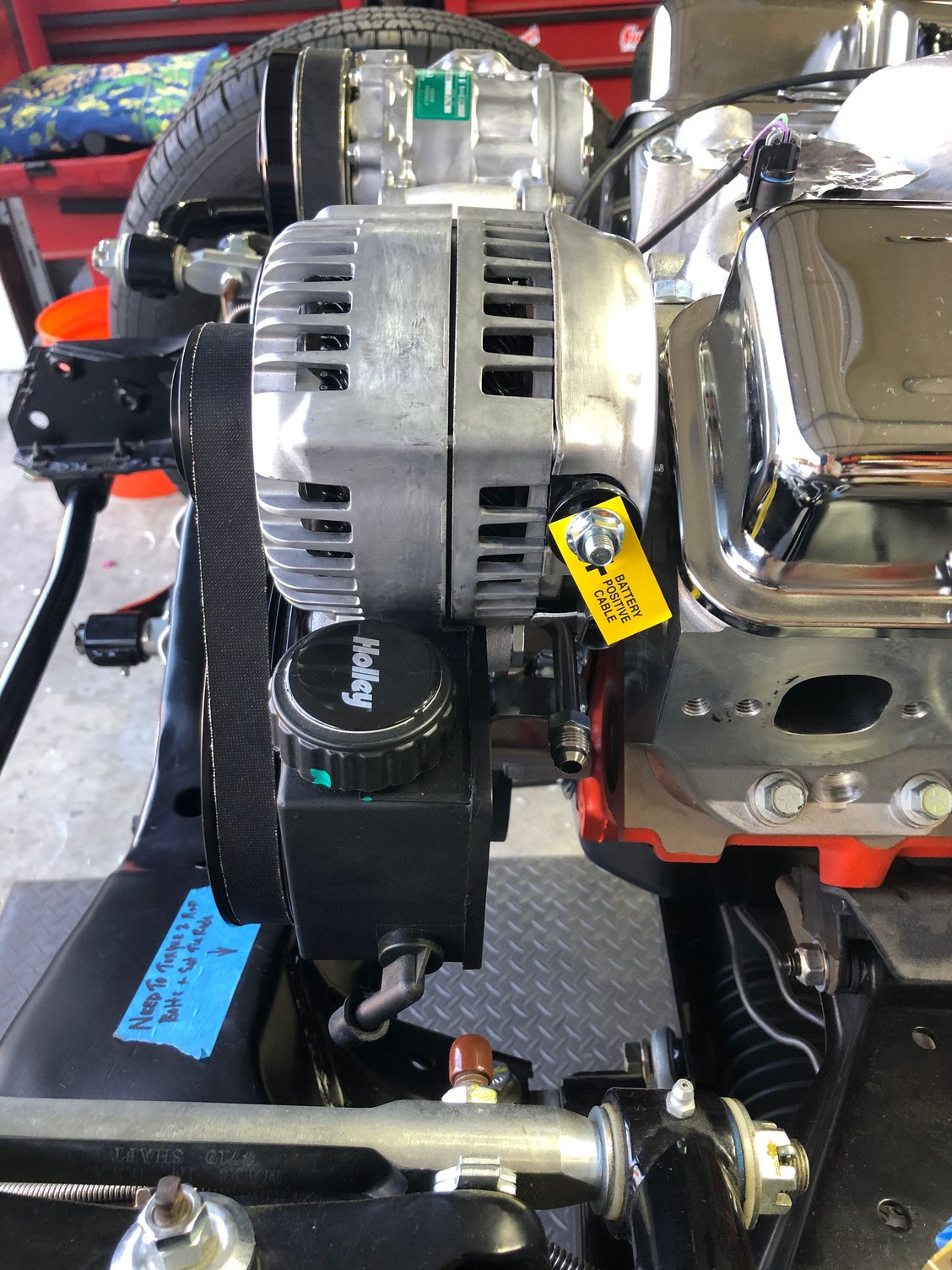

I chose the Holley for my SBC 400 with A/C, 150amp ALT and PS for my R&P in which I had to make a 90 degree hose connection from Gottashow.com . You have to be careful of what you by or use because of the limited space on a C3. Check all dimensions. I chose the Holley because there no clearance issues. Worth the price with no headaches.

Caskiguy, That system looks really great. Was there enough room to get a spreader bar in there? Looking at where mine sets compared to the pictures is pretty hard to tell.

I had ordered a Speeddirect spreader bar before I installed the Holley serpentine kit and No this one doesn't fit. I may after the radiator and body are installed devise a way to use the bar with a new bracket if possible. But my crossmember is in good shape so I'll see what I come up with if anything.
Holley SBC Serpentine Kit

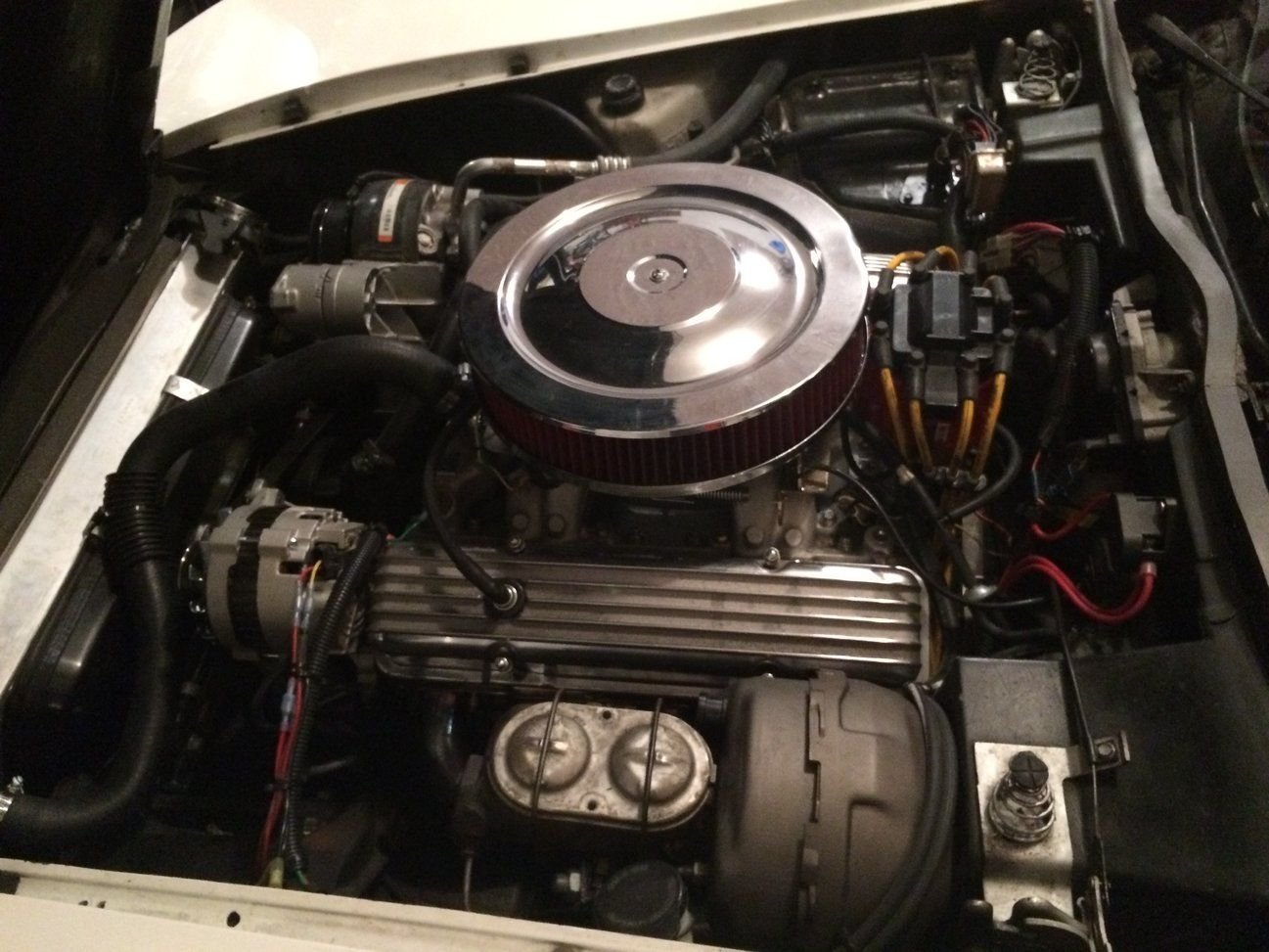

This is the only pic i have handy. this is the same as the kit DC3 installed - just sourced from other vehicles vs new.
