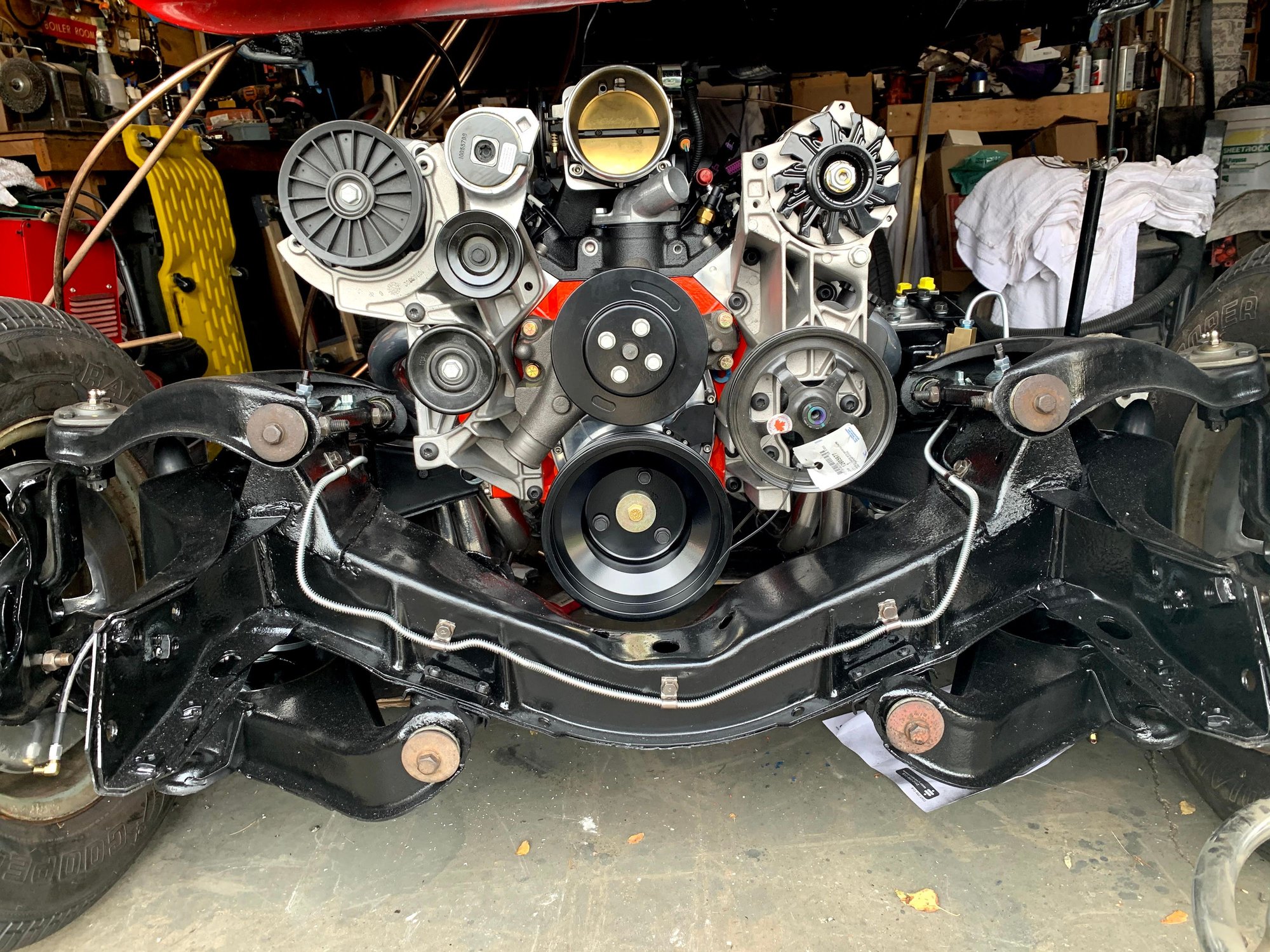

Old Jan 6, 2021 | 05:25 PM
raycam01_au's Avatar
raycam01_au
Joined: Jun 2020
Posts: 353
Likes: 310
Old Jan 6, 2021 | 05:45 PM
Kidster71's Avatar
Kidster71
Highway Man
Joined: Apr 2019
Posts: 445
Likes: 188
From: Ca
Nice and compact. Excellent!
