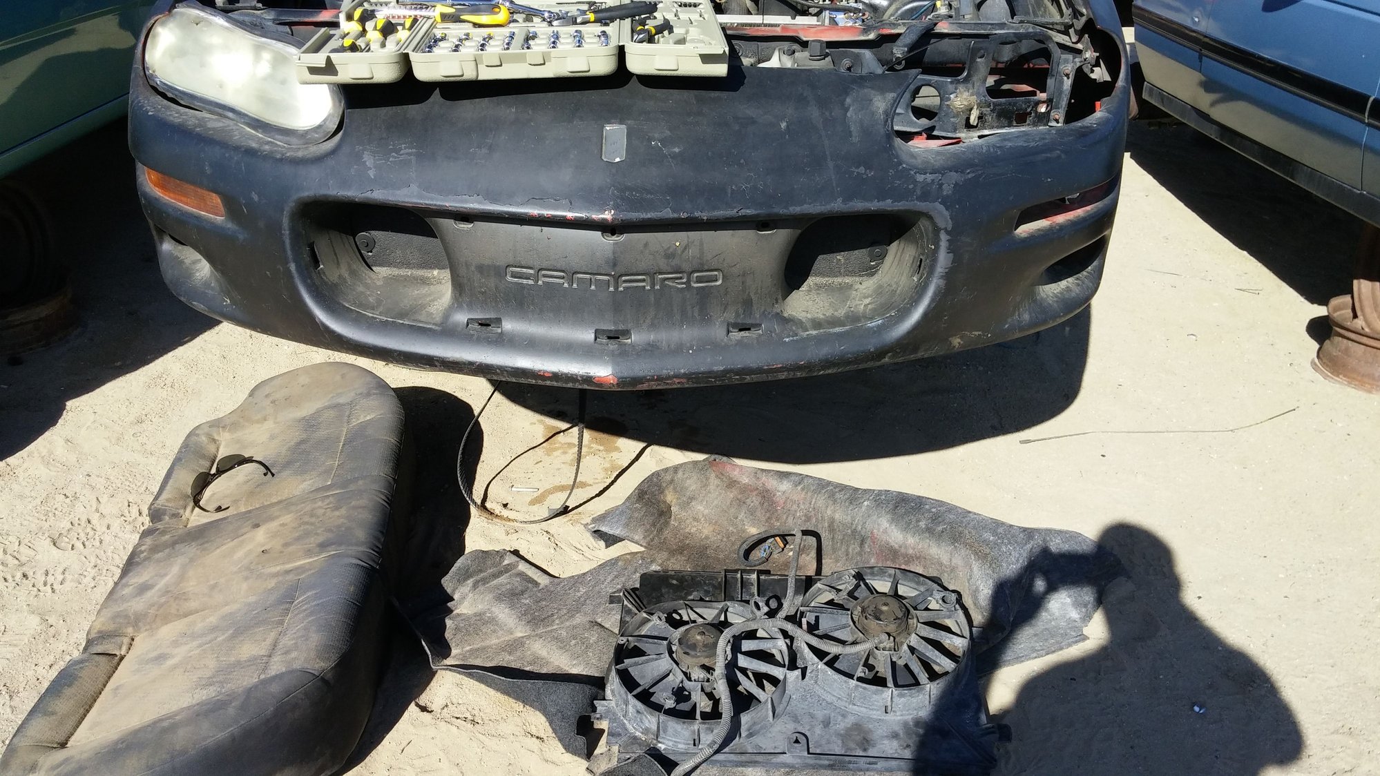

Five years later, the fans are still solidly running. They spun easy when I took them off the car and then ohm'd them out, to make sure the windings weren't open. $40 on a half off day and my '74 with a built 383, never goes above 200 degrees. I cleaned them up and it sure felt good on the wallet!
