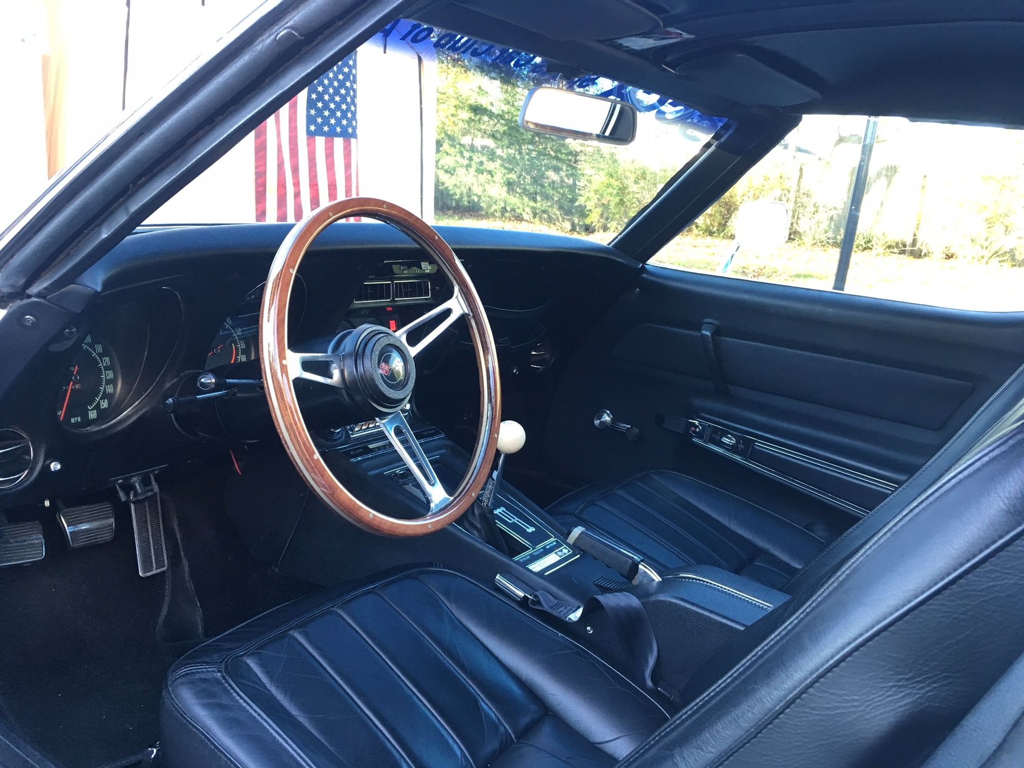

I searched the forum for info on a good looking, period correct wooden steering wheel that would bolt right on a C3. I bought one and figured I would share in case this helps anyone. All of these Volante wheels bolt right on. The quality is GREAT. They are a little pricey at $150-$200 depending on the wheel. Summit sells them buy the Volante part number. Ecklers assigns their own number. Direct bolt on for my 1969 Tilt/Tele column.

Thanks for posting this! I love the Volante steering wheel in my 80. It's slightly smaller than stock, and looks like it belongs there. I'm glad to hear their other wheels are just as good or better.

I was curious why you used a straight column horn button instead of the horn button made for the tilt/tele column? Just curious, not criticizing in any way--you have a great looking wheel!

The wheel you purchased is very nice looking and does a pretty good job of replicating the appearance of the factory wood wheel.

Holy COW!!! You know I NEVER even noticed that! That's Crazy since I have a 1980 corvette and that DOES have the larger (correct) horn button for Tilt/Tele. The 1969 came with that (Wrong) button, and I just figured it was the correct one. That is so funny!

That's looks really nice. How does the grip compare to the leather wrapped wheel?

Our friends at Willcox have the correct horn button for you car
https://willcoxcorvette.com/corvette...escopic-69-101 paint to match
https://willcoxcorvette.com/corvette...lescopic-69-75 painted black?
1977-82 tilt/tele horn buttons are shaped different and have different emblems, but will work
1976 horn buttons are a whole different animal

I really like it. Nice finger grooves and not as think as some of the modern Grant wheels. Reminds me of a AC Cobra or Shelby Mustang wheel

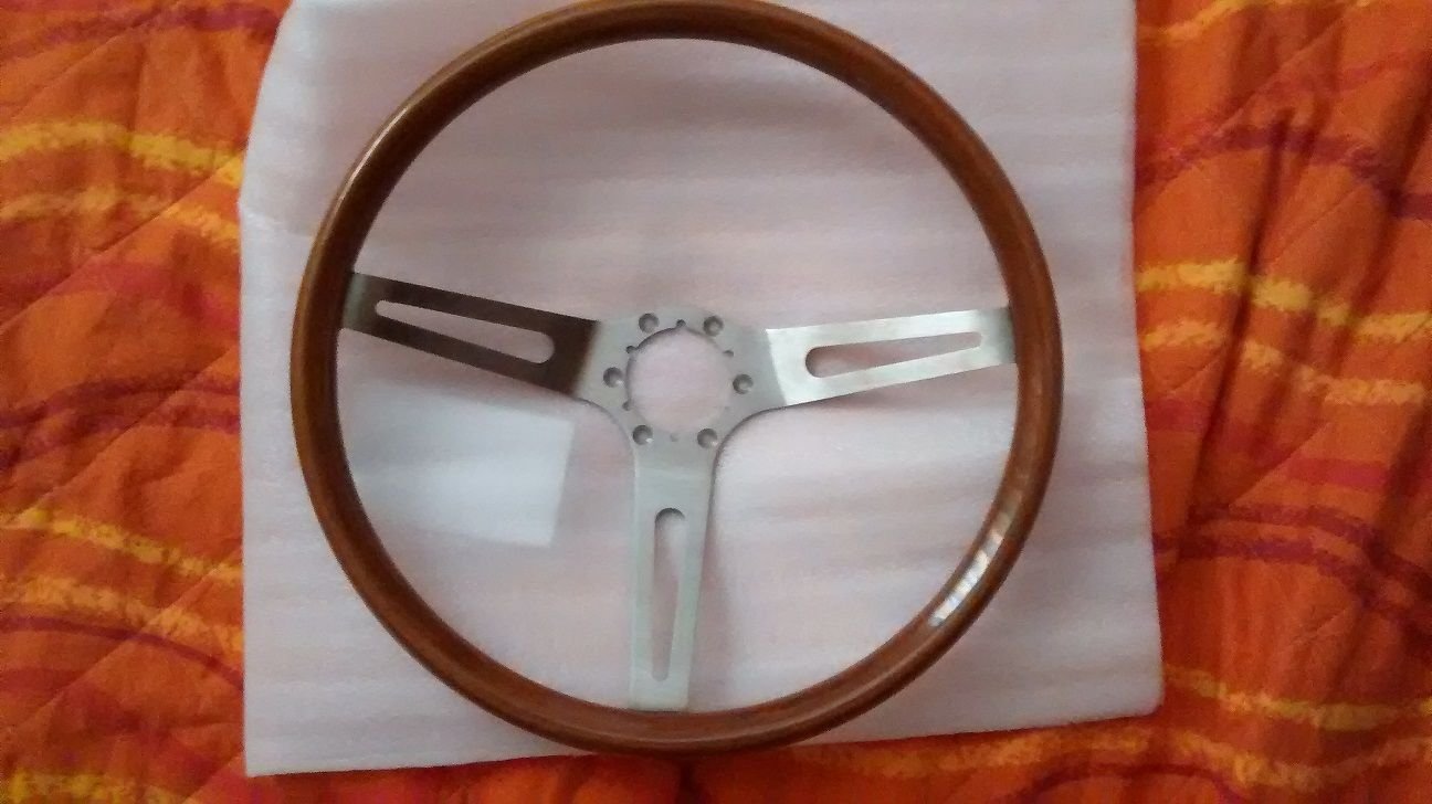

Grant 930. Not installed yet!

I usually don't like aftermarket wheels on a C3, but this one and the Grant one shown, I definitely do. Nice job!

I am considering purchasing the Grant 930 also and was curious if an adapter kit or anything else is needed to install this on a 73 or do I just use the original parts to install this wheel.

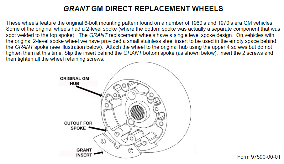

Terribly sorry but I didn't install it yet. I'm waiting to the very end of all major works before I install it. I don't want to mess it up with greasy hands.
But with the wheel came the adapter to install it. See the attached picture. These are the installation instructions found on Grant website.

If you don't have a telescoping steering column you may find the grant 930 wheel to have too much of a dish.
This moves the wheel closure to the driver and can make it difficult to get in and out

The Grant wheel is also smaller in diameter by 1/2". Grant 930 is 14" 1/2.
Original sizes are (thanks to the member Easy Mike for the information):
16" 68 only
15" 69-75
76 Vega wheel is one year only
77-82 14" leather wrapped.
