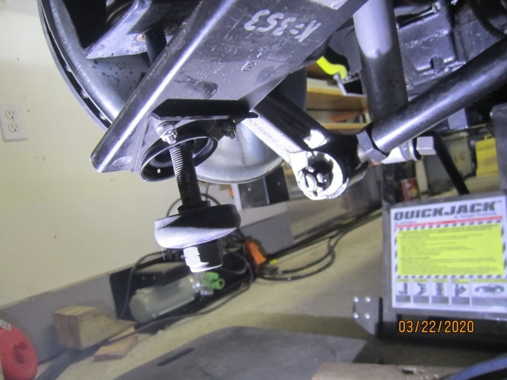

My rear spring bolt doesnt even put any tension on the spring. Is this right? I think the previous owner may have been a bit of a shady mechanic.

you don't say, in this photo is the car on jackstands or a floorjack??? if so, looks normal for a car with extra length bolts for lower ride height.

The car is on jack stands but even when its on the ground they sit about the same. Should they at least be somewhat tight?

if the car is on the ground, they WILL be tight. or your sitting on the bump stops.
should look like this on the ground. if not, what's holding your car up??

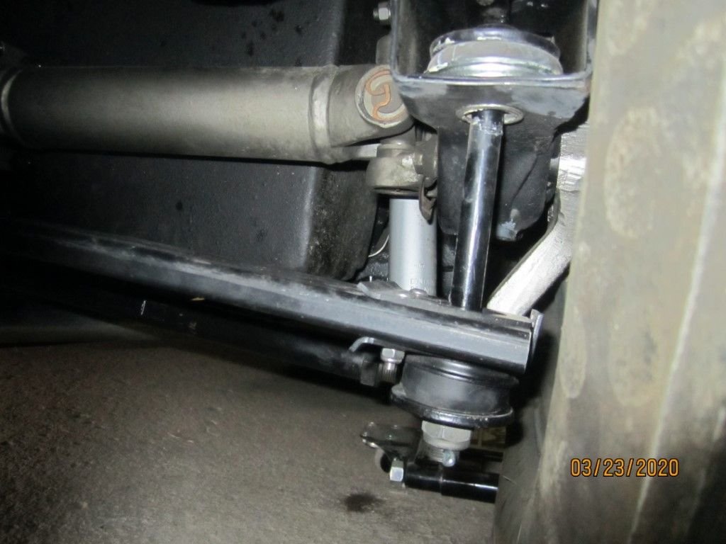

That's a "low arch" spring so they are fairly flat when resting (compared to the stock steel spring or a "regular" glass one) and when lifted, the TA hangs down far enough to take the pressure off
Here's mine on the quickjack
And then with the car on the ground
If you have that bolt loose when the car is on the ground then something is really screwed up with the shocks or something that is holding the car up instead of the spring

So how do I know how far to tighten it while in the air. I guess I can just match the other side for now

Yeah pretty much, make sure you use new nylock nuts or that there is a cotter pin in the bottom of the bolt.
Once it's on the ground with a tank of fuel you can adjust it, putting the nut on farther raises the car
