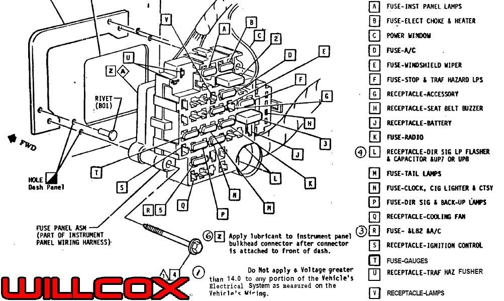

Where can I connect the power line from the retro mod radio in my 79 to?
This is the "ignition" wire coming from my radio for power.

You should have a spade available on the fuse panel for ACC which you could hook to, that would be powered in the acc or run key positions
M
here at item "G" I believe
http://repairs.willcoxcorvette.com/1...te-fuse-panel/

Look around the back of the radio for a Yellow wire.
The original 3 wire radio power plug (most likely long gone) in your 79 had a Yellow wire (switched power circuit 43) a Black wire (chassis ground circuit 150) and a Grey wire (instrument lamps circuit 8).
The Yellow radio wire is fuse protected marked K in the diagram above.
The Grey Instrument lamp wire is fuse protected marked A in the diagram above.
Just to throw in a extra step, MAKE SURE that the single Grey wire shown in your photo has continuity to one side of the Instrument lamp fuse A.
Why? because one wire to the original Left side front speaker was also Grey.....Could it be that speaker wire???

You were right about the grey wire. It’s the left front speaker which isn’t even hooked up.
