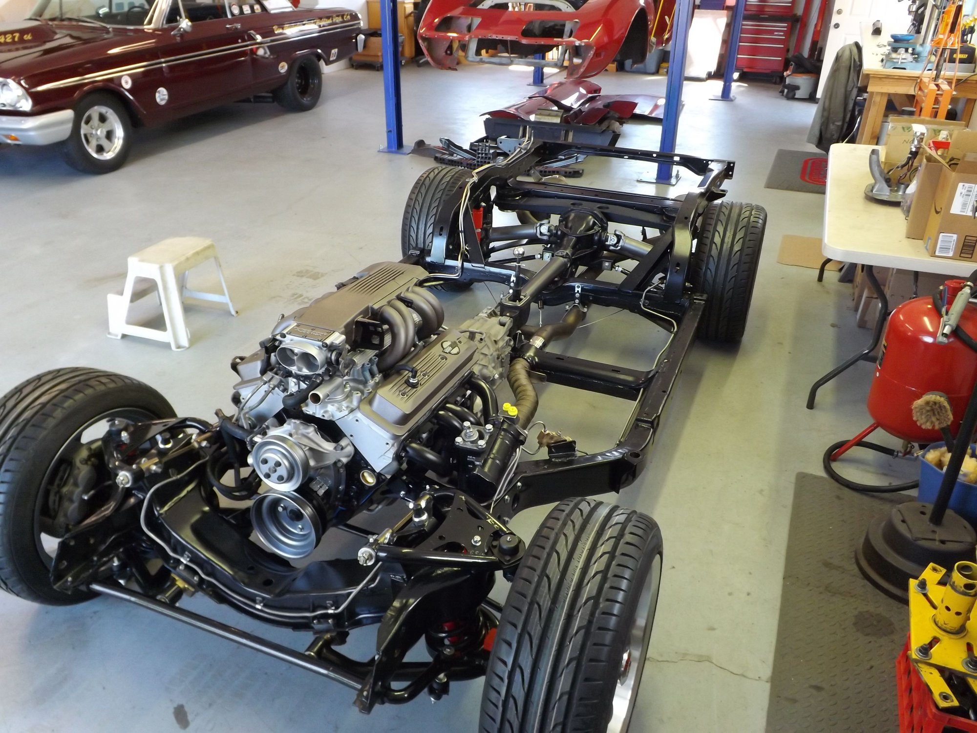

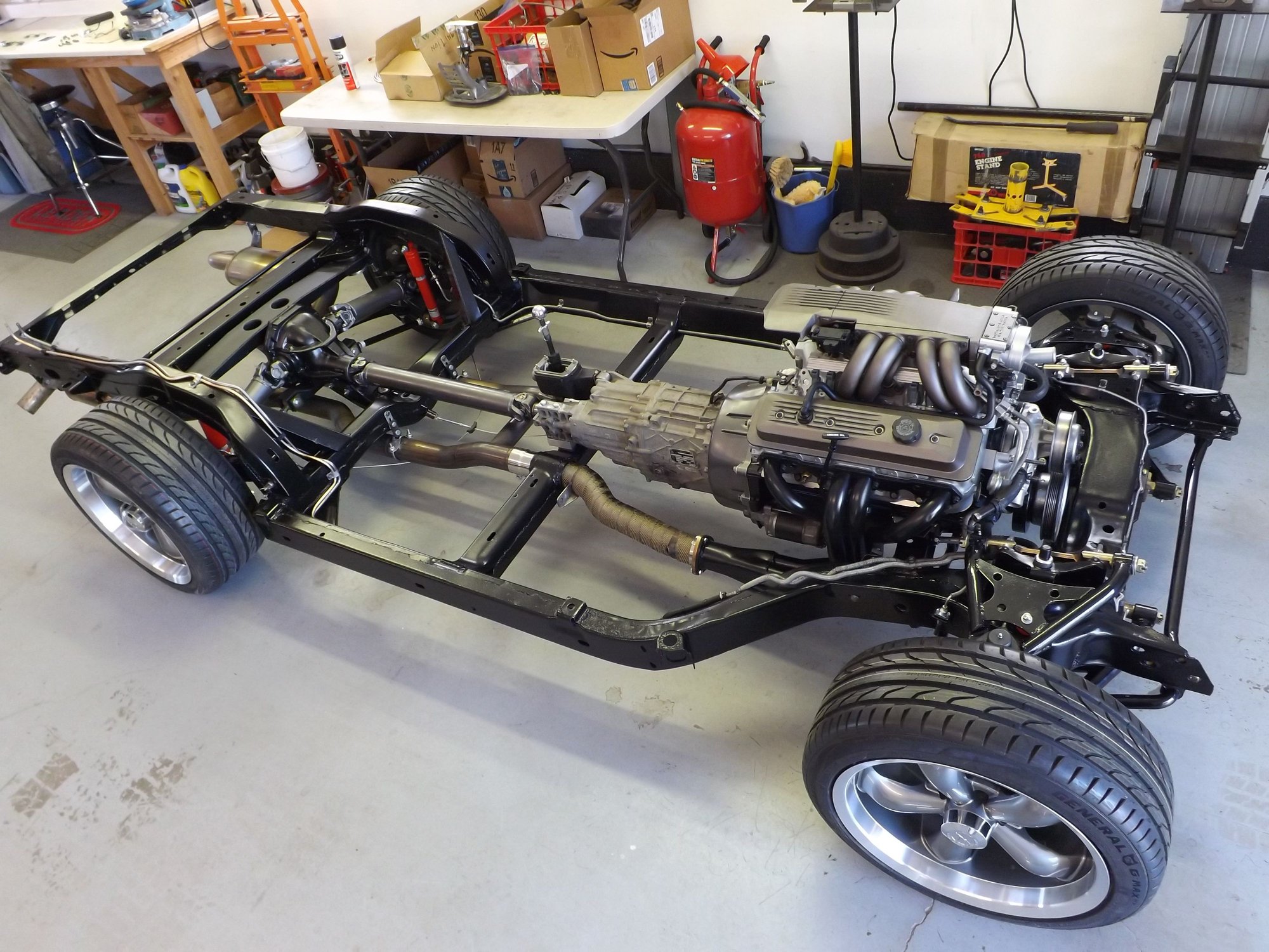

Yeah, I went with 255 40 18's in the rear and 225 45 18's up front in order to keep the overall diameter close to stock, like 26". I also had to go with those widths to fit the rims I choose, which are 9.5" X 18" rear, 8" X 18" front. So it is a compromise. I thought the tires looked too skinny when I received them but I am getting use to the look. Still, I would prefer a little taller side wall. The wheels you choose will dictate tire size if you want them to fit properly under the fenders.

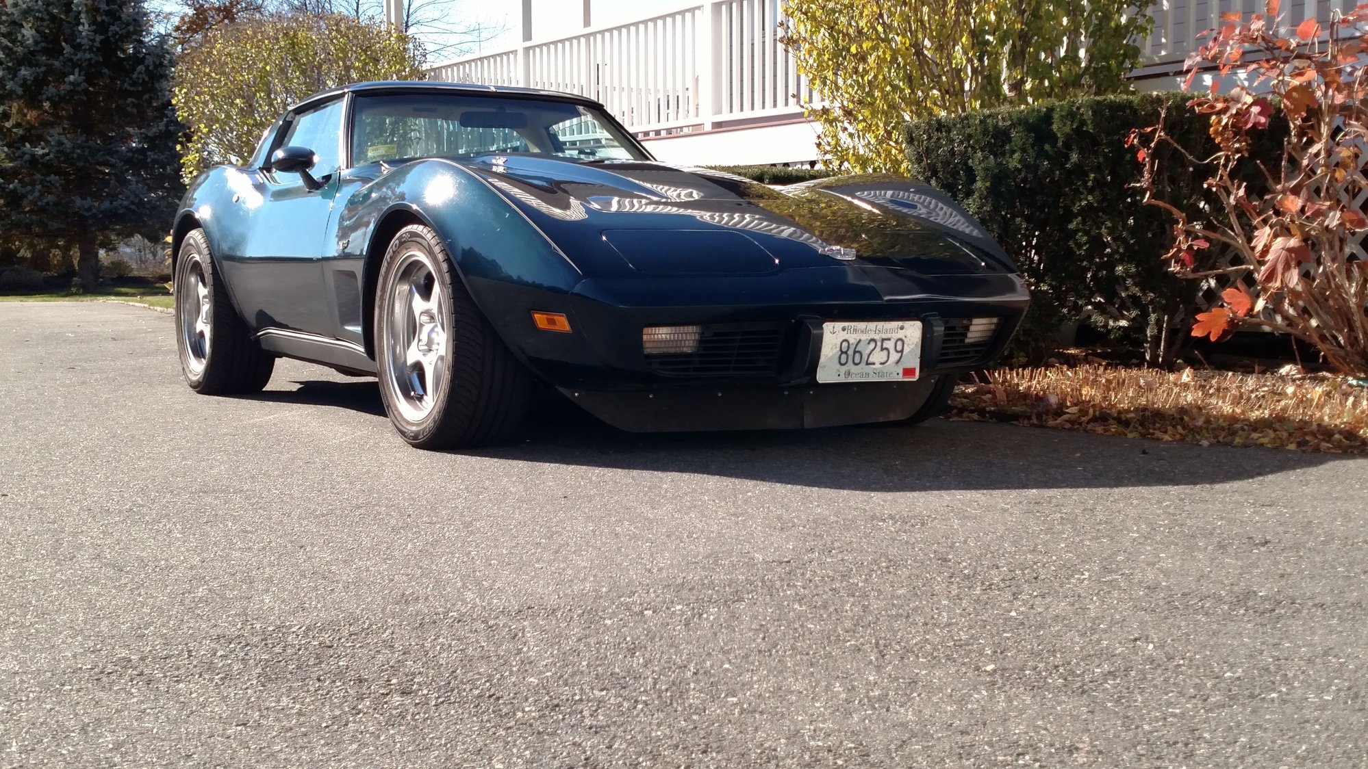

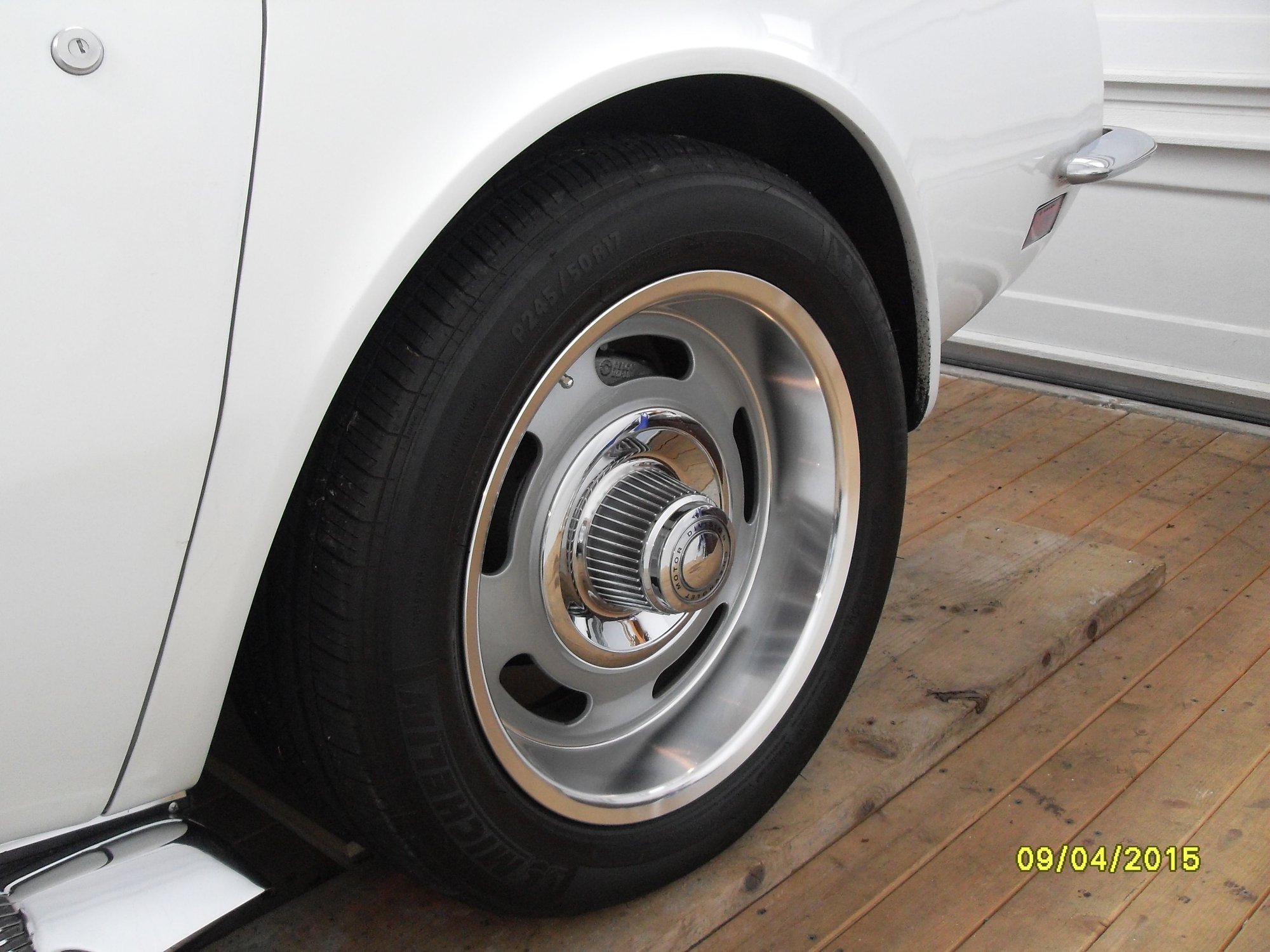

245/50-17 on all 4 since 2015. Michelin Pilots, works great for me.

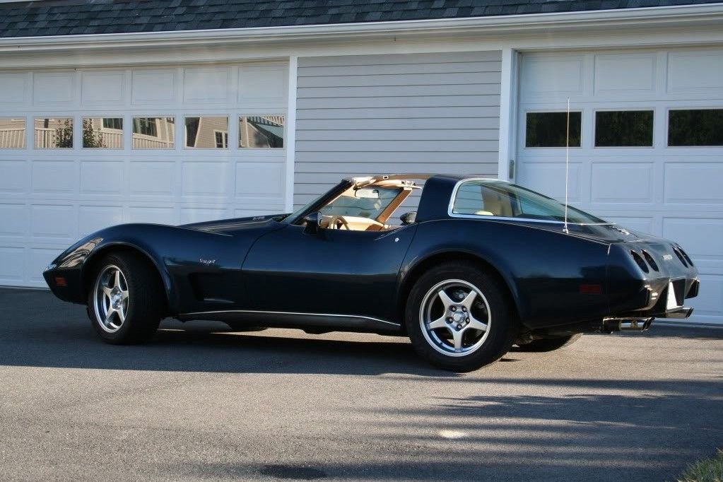

255/50/17 ZR's in back and 255/45/17's in front. I prefer the 255/45/17's in front for looks and handling but with 3.70 gears and a 4 speed I needed to preserve the 27 inch diameter of the OEM 255/60/15.
The 255/50/17 has the exact overall diameter of the 255/60/15...27 inches..

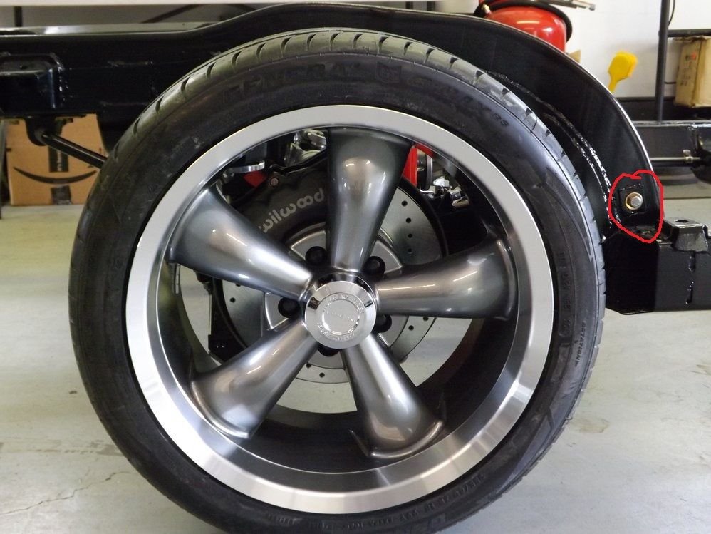

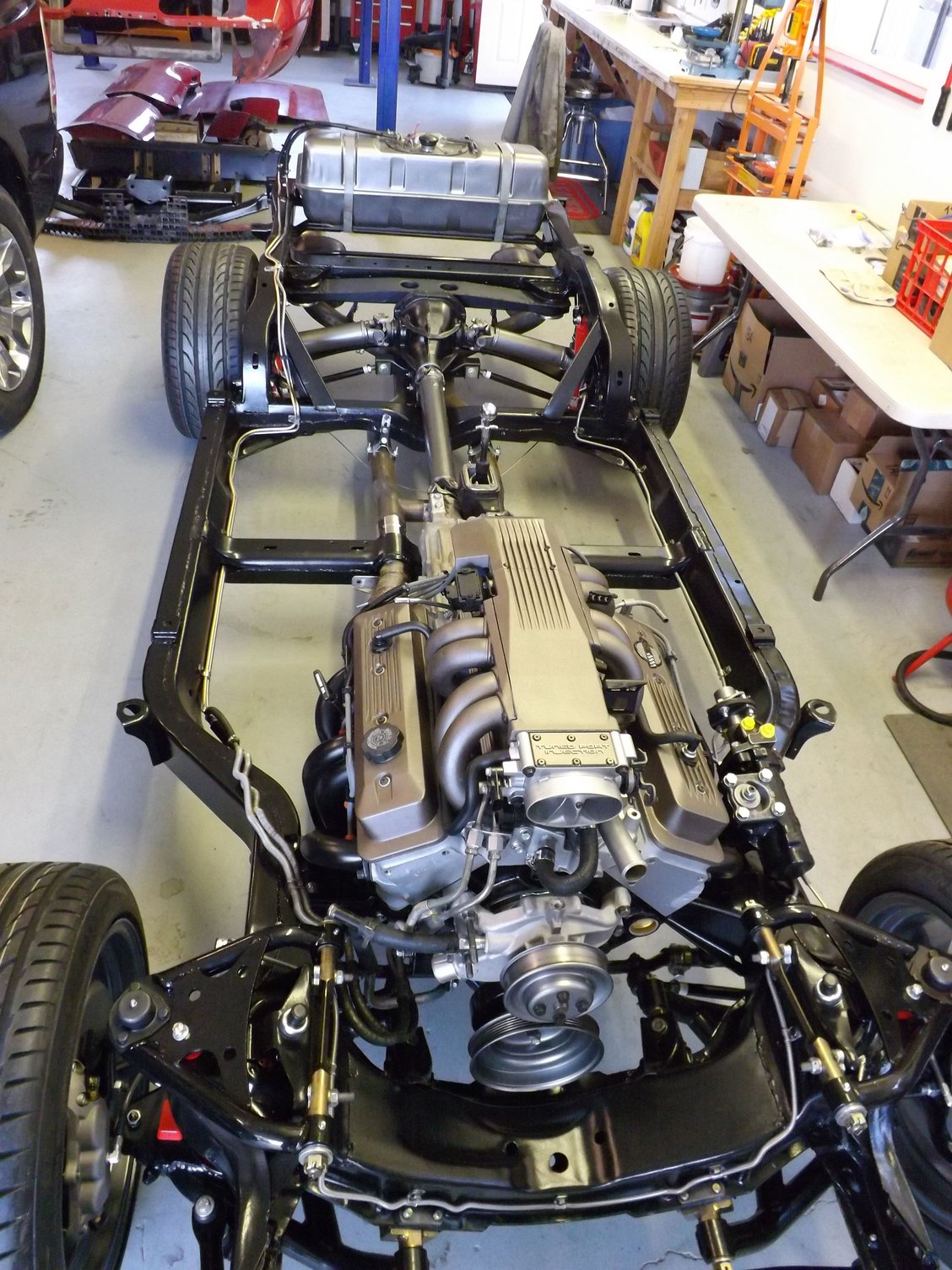

Not meaning to hijack the OP thread but C3TPI, is that the the trailing arm bolt that I circled in red? Shouldn't the nut be on the outside of the frame and the bolt head on the inside of the frame? I just took a look at mine and that's how they are oriented. By the way, your chassis is absolutely gorgeous!

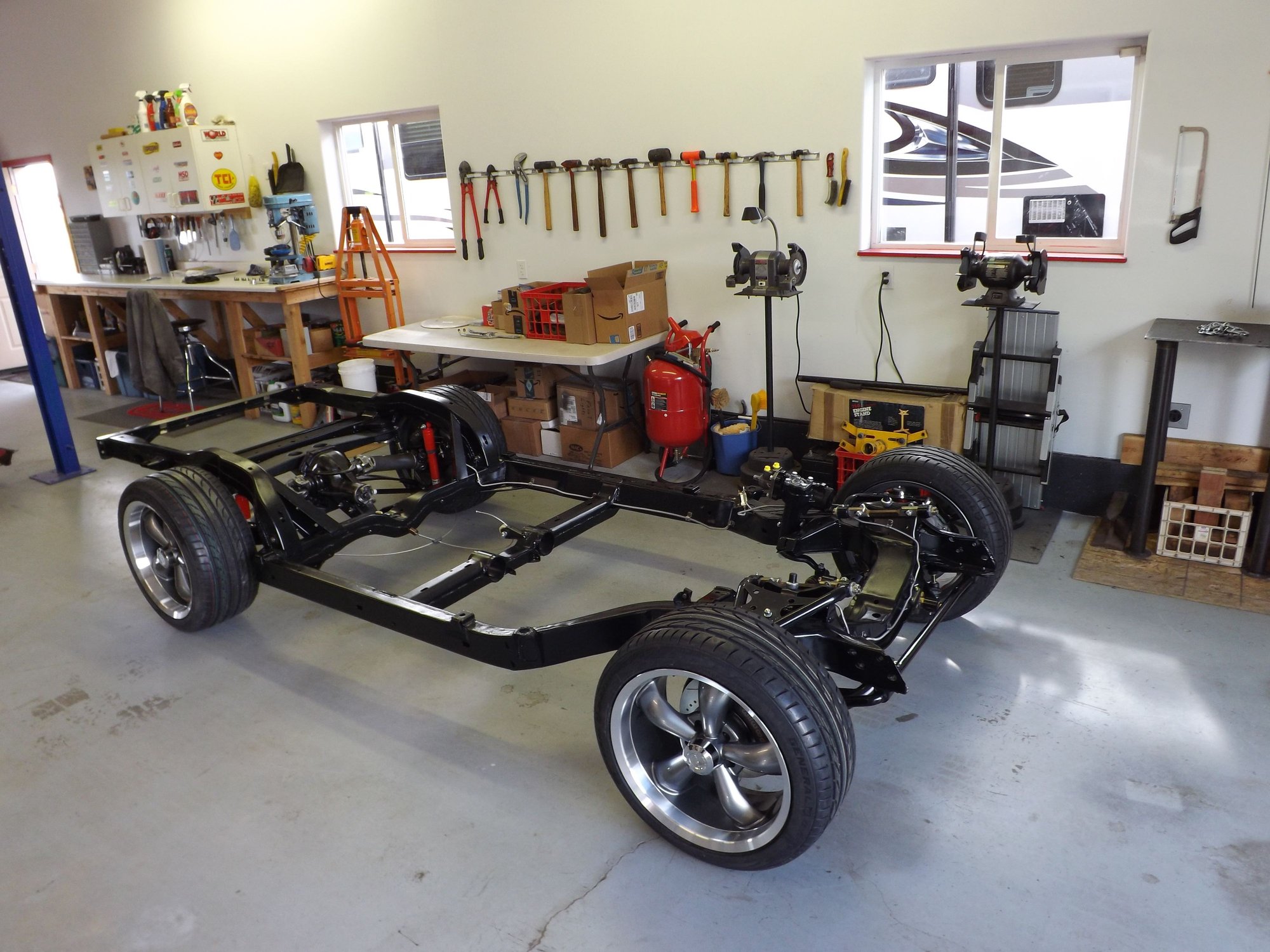

Good eye, Sunflower, that was corrected months ago, but thanks for the heads up and the compliment! Here it is in its' current stage, body is ready to go out to paint next month.

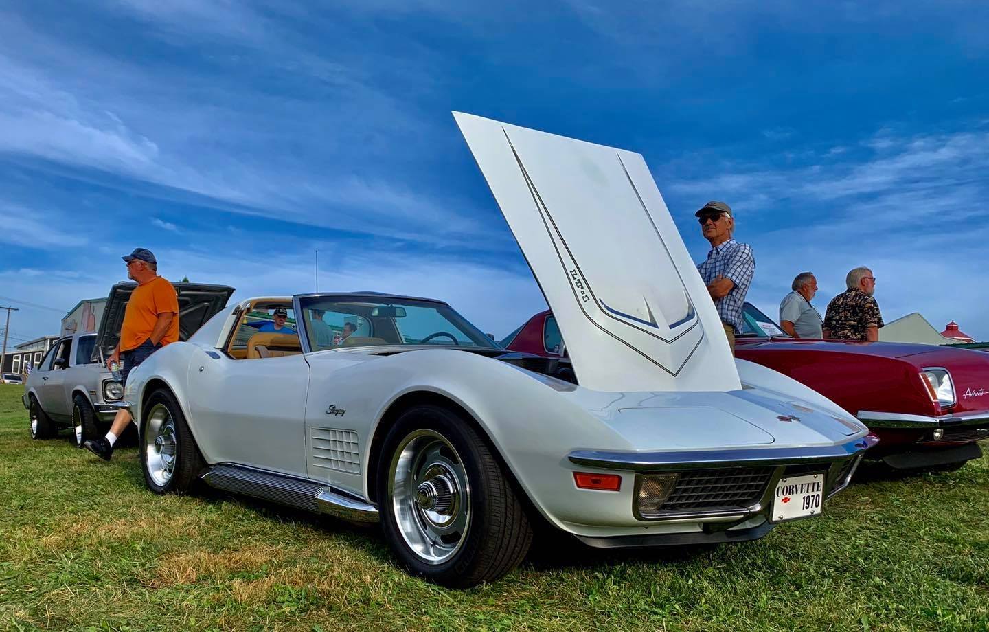

255/50-17 all around, also. Same 27" diameter as the 255/60-15s that came off.
still working on getting the ride height correct
