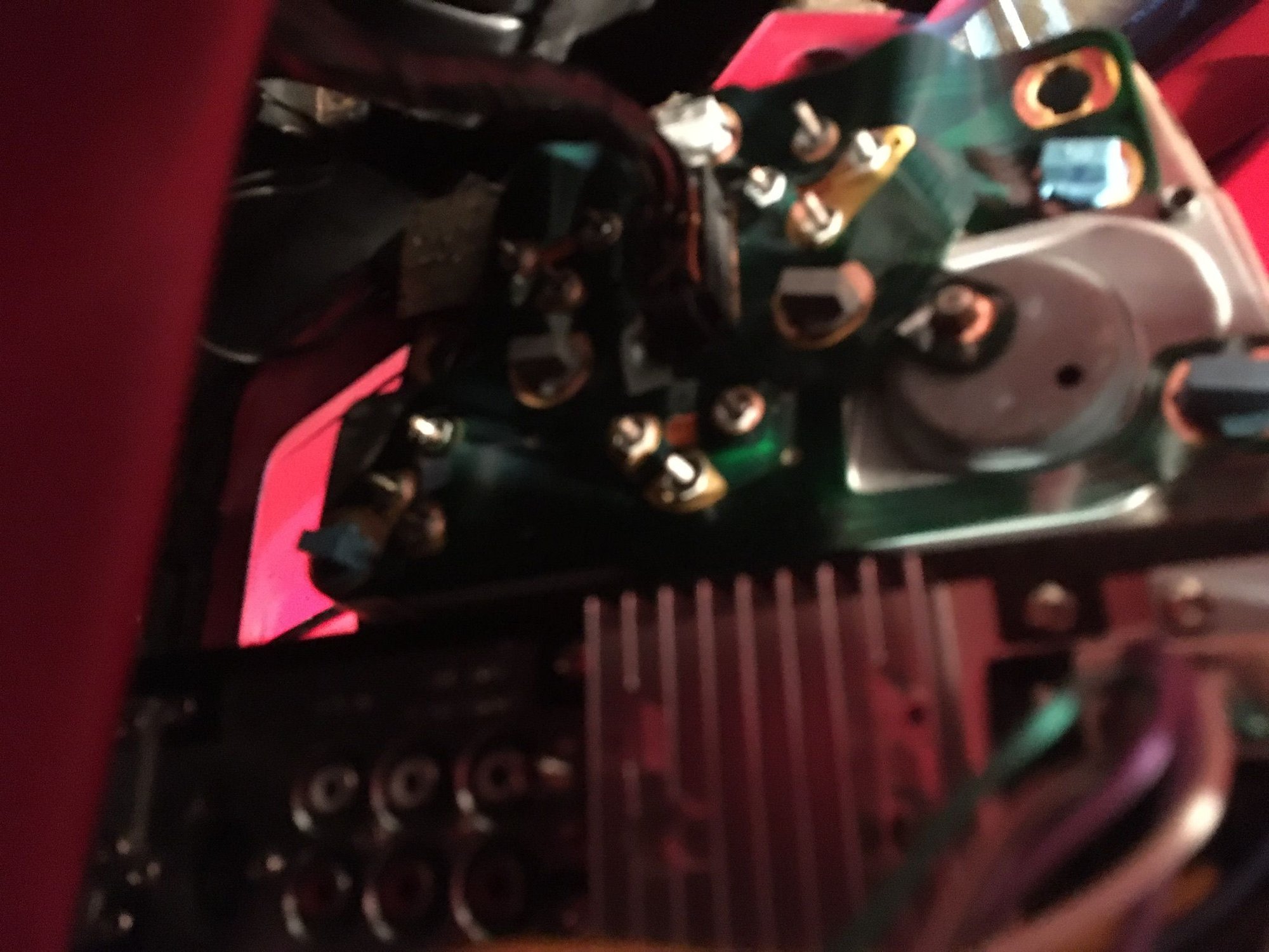

Why would only the driver’s side of my 79 only be working with headlights and rear lights and all but two lights in center console? I recently replaced the circuit board on the console and all new lights. This is the back of the center console.

With the 'plastic' Corvette, nearly ALL electrical circuits NEED to have a separate ground wire to complete the circuit. Chances are that you 'lost' ground when you worked in the dash area. If all but 2 lights are working in some area, there is a problem with those 2 bulbs, their sockets or their wiring. If you installed LEDS, some of those bulbs are polarity sensitive and must be oriented properly....even though they are NOT marked so.
If the bulbs at rear are good, then your issues back there are related to wiring, sockets, or grounding.
