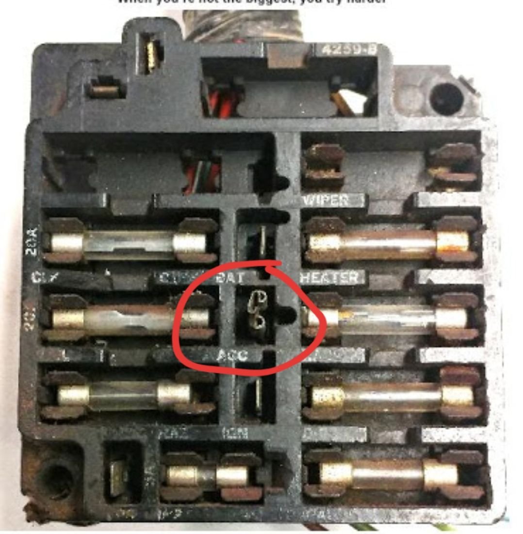

Can't remember the color but whichever wire on your ballast resistor is hot 12V when key is on is the hot wire you want to use on your HEI68 and older models only

Yup, I took mine 12v from the same ACC output you marked. Works just fine

The C3 corvettes that I have seen with points did not use a ballast resister, they used a resistance wire instead. The wire from the firewall connector to the coil was designed to do the job of a ballast resister, so if switching to HEI, do not use the original wire because you won't get the needed voltage/amperage to the distributor. Either run a new wire from the IGN terminal in the fuse box( not the acc terminal, it only has power in acc and run, not in start), or remove the resistance wire from the bulkhead firewall connector and run a 12 gage wire to the distributor.
