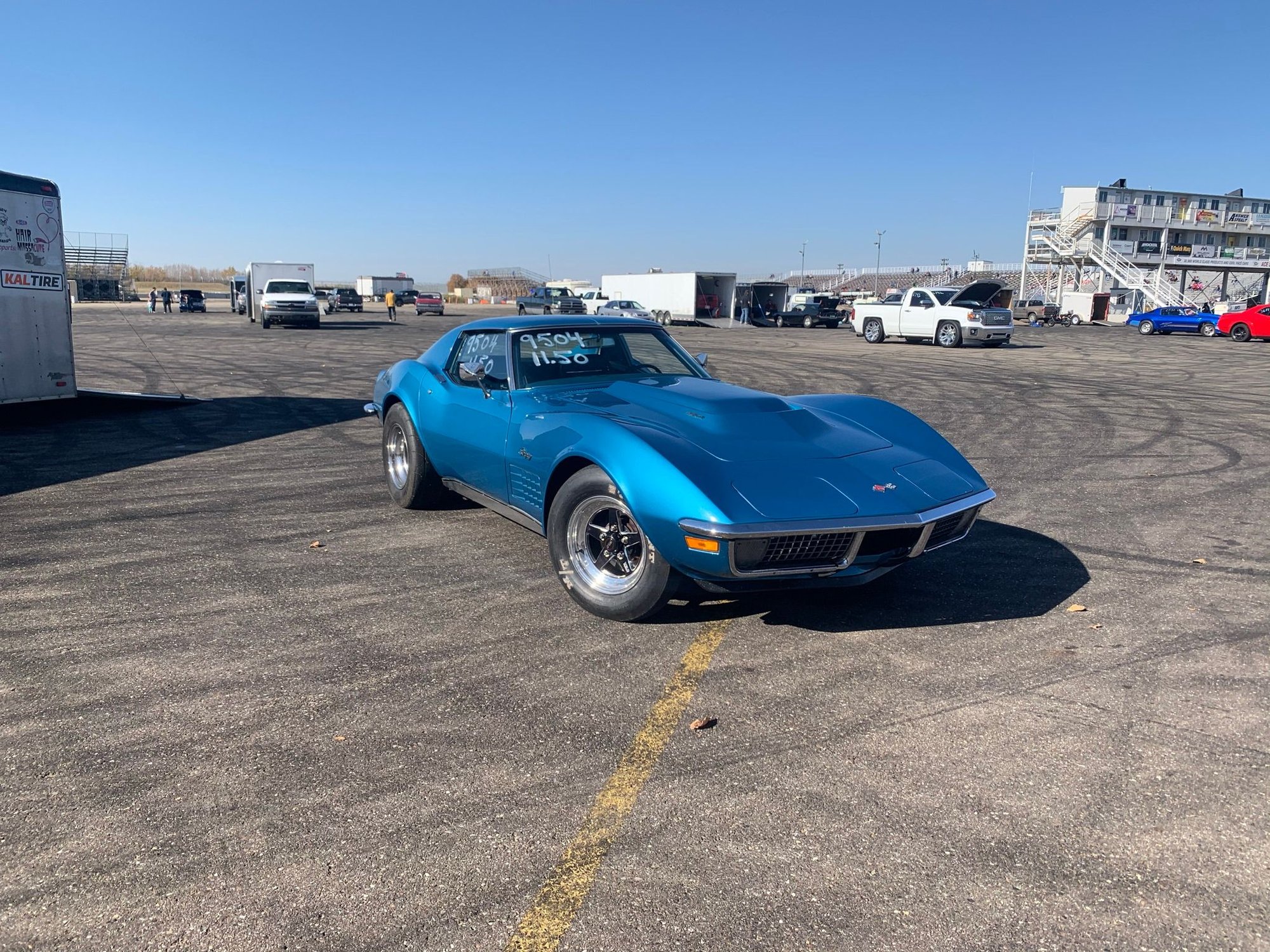

About 20 years ago, I purchased a very nice numbers matching LS5 365hp Vette. Over the years, some bolt on upgrades were made in the quest for more power, but I was never satisfied with the result. Following this forum, and more specifically Alans (ajrothm) 71 vette, I knew what had to be done... Call Mark Jones!
Mark was able to build me exactly what I needed, a 496, and told me exactly how the car would perform.
The first time at the track, immediately after installing the engine, the car ran 12.0 @110mph. I could tell the exhaust was killing it. Then, on the third pass with a 1.60 60', the stock axles exploded. It may be worth noting that Mark also knew this would happen!
So with an exploded differential late 2019, I had to get Gary to build me a Super 10! When that was complete and installed, I also ditched the 2 1/4" chambered exhaust on the car, and went dual 3" with an X pipe and Hooker Aero Chamber mufflers, very similar to Alans setup.
With that, I put a few hundred miles on the car in the spring and summer of 2020, breaking in the new gears and just cruising. I could tell it was a different car from the one that went 12.0 the previous season.
I took the car to the track this fall hoping to get some good air. The air was terrible. 3700' DA
My first pass was 11.09 @120.13mph! Zero additional tuning had been done to the engine from when I had picked it up from Mark, other than setting the total timing to 34 degrees!
I was warned by the track officials immediately that I was too fast, and I would have to let off at the 1000' if I was going to stay under 11.50.
Letting off at the 1000', I was still running 11.29 @ 104mph!
Best 60' of the day was 1.48 with both wheels up! Best et of the day was my final run, 11.04@120.10mph, with the only change being 36 degrees timing.
Next year, the car should easily run 10's in some decent air, and with a couple small tweaks.
I couldn't be happier with the engine built by Mark @ Vortecpro. Everything he told me to expect with this engine was bang on.
Can't wait for 2021. Already planning a trip to Mission!
First pass of the day. Left lane.
Letting off at 1000'. Best 60'. Right lane
Best et of the day. Right lane.
Wheels up!
