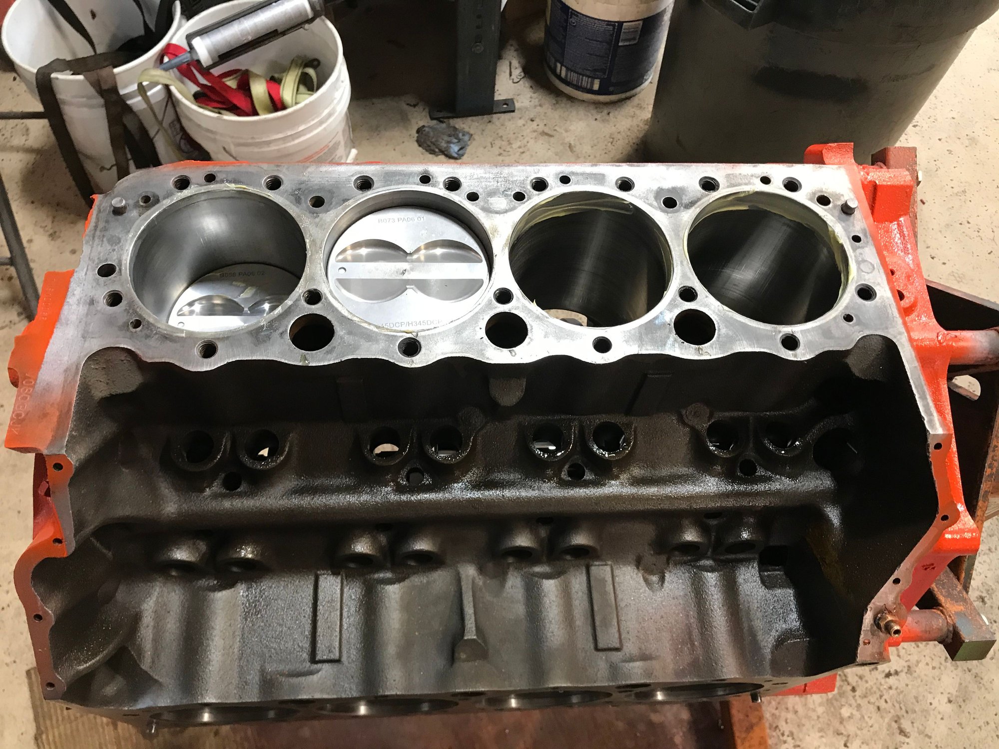

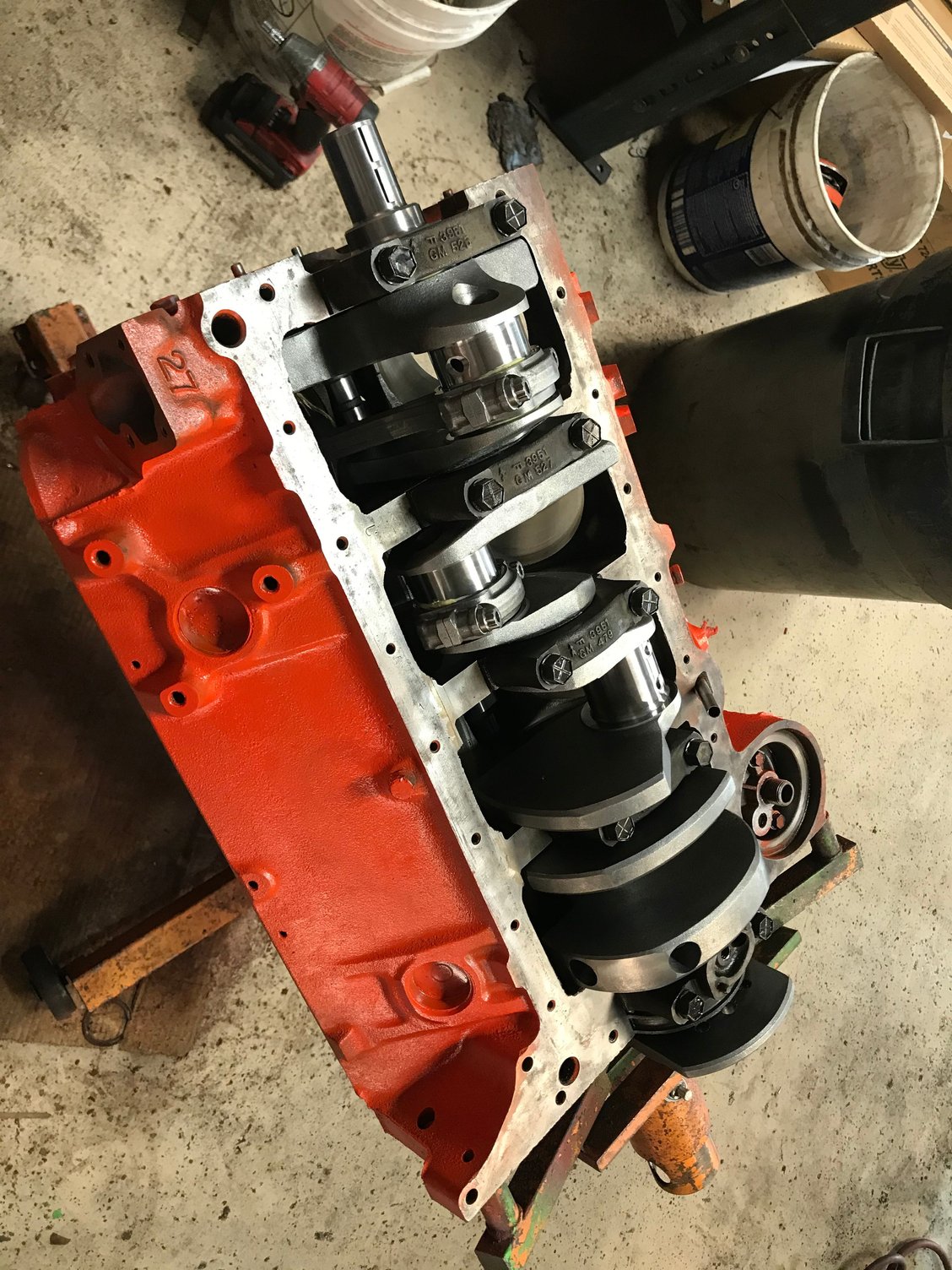

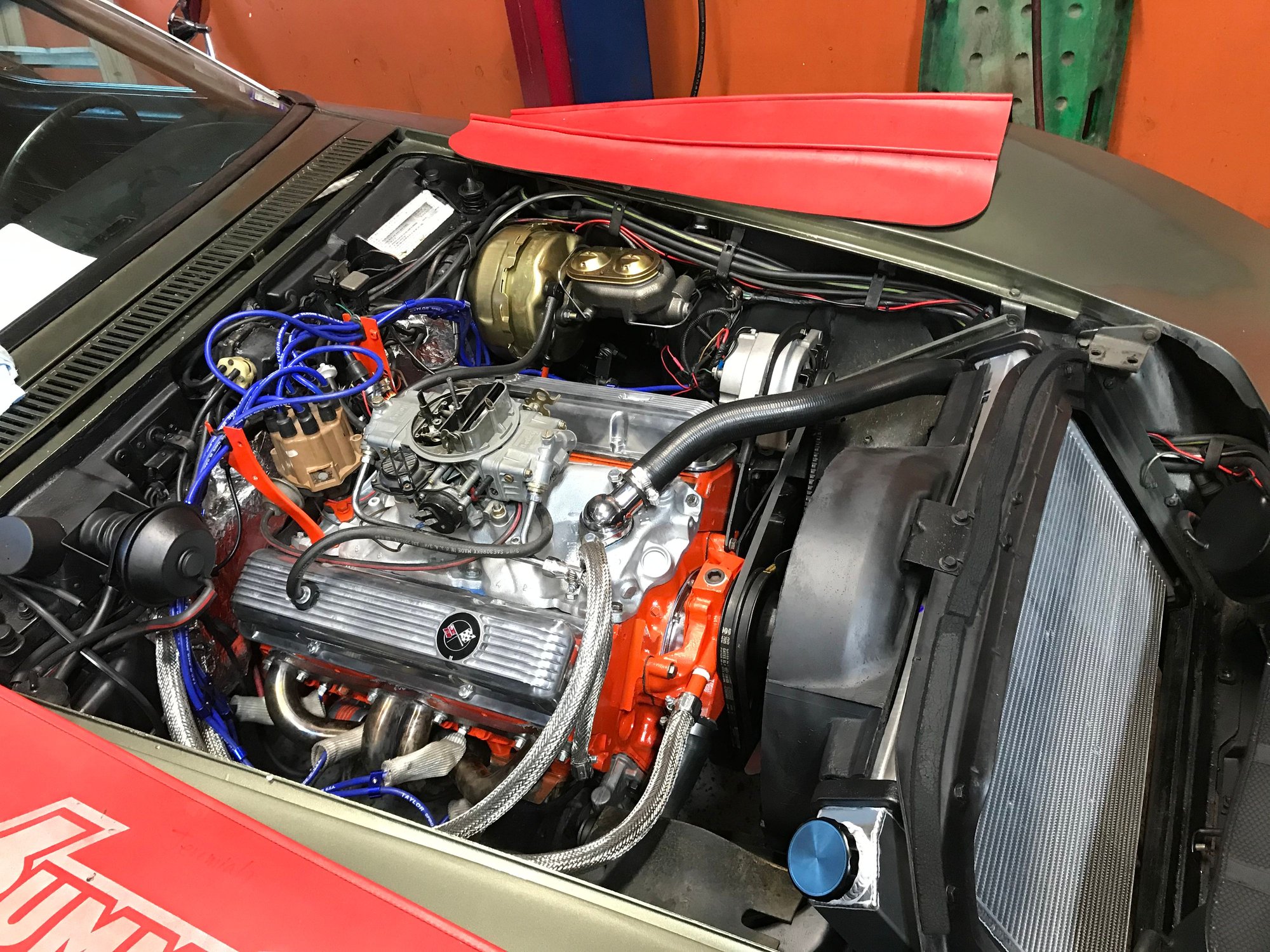

I cant thank you enough for sharing your work. That is impressive. I put an aluminum radiator in and it has greatly helped on the cooling. I have also added a roller cam and upgraded the pistons to improve my HP.
