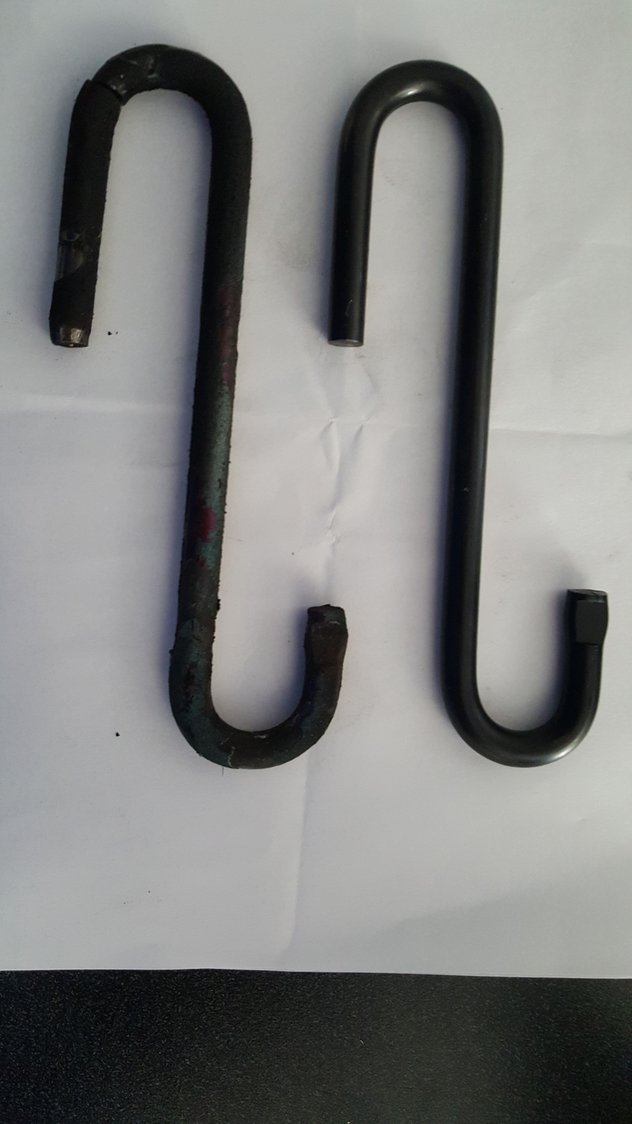

Mooser, does this help? mrvette started his thread the day after I ordered mine from Corvette Central.
Just got it today. I can take more photos if you'd like.

I think so

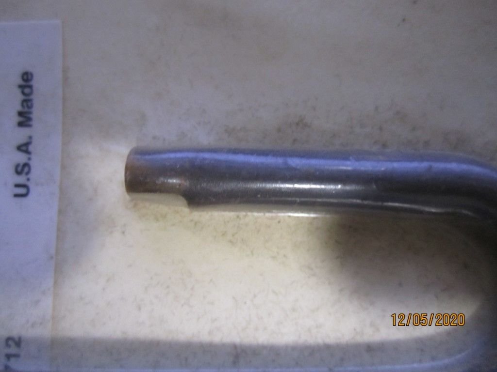

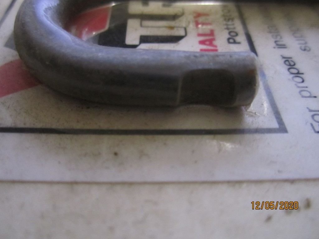

I have a spring here that was manufactured by a company that seems to be long gone and on the package it says "specially designed to alleviate a defect in the original door hinge spring assembly" and is patented so I was trying to see what was different than on a "stock" spring
This one has a notch near the end of the short end
and the flat on the long end is not on the side but it's on the inside surface
The patent statesMy method contemplates a replacement spring of the kind in question which is structured so that it eliminates the cause for the breakage of the original springs and has single keeper notch adapting the spring for the use on either the left or right hand door.
The spring of the invention is a wire form having the same S-shaped configuration as the original equipment spring except it has the improvements of special keeper notch on the top bent section which conditions the spring for use in either a left or right hand door and a clearance foot on the end of the lower bent section which corrects the problem causing breakage of the original spring by providing clearance for the end of the spring to move without binding on the walls of the rear keeper slot.
Seems like it could be done on a normal spring in a couple of minutes with a grinder...
Thanks for the picture, couldn't see it on mine while it's on the car
M

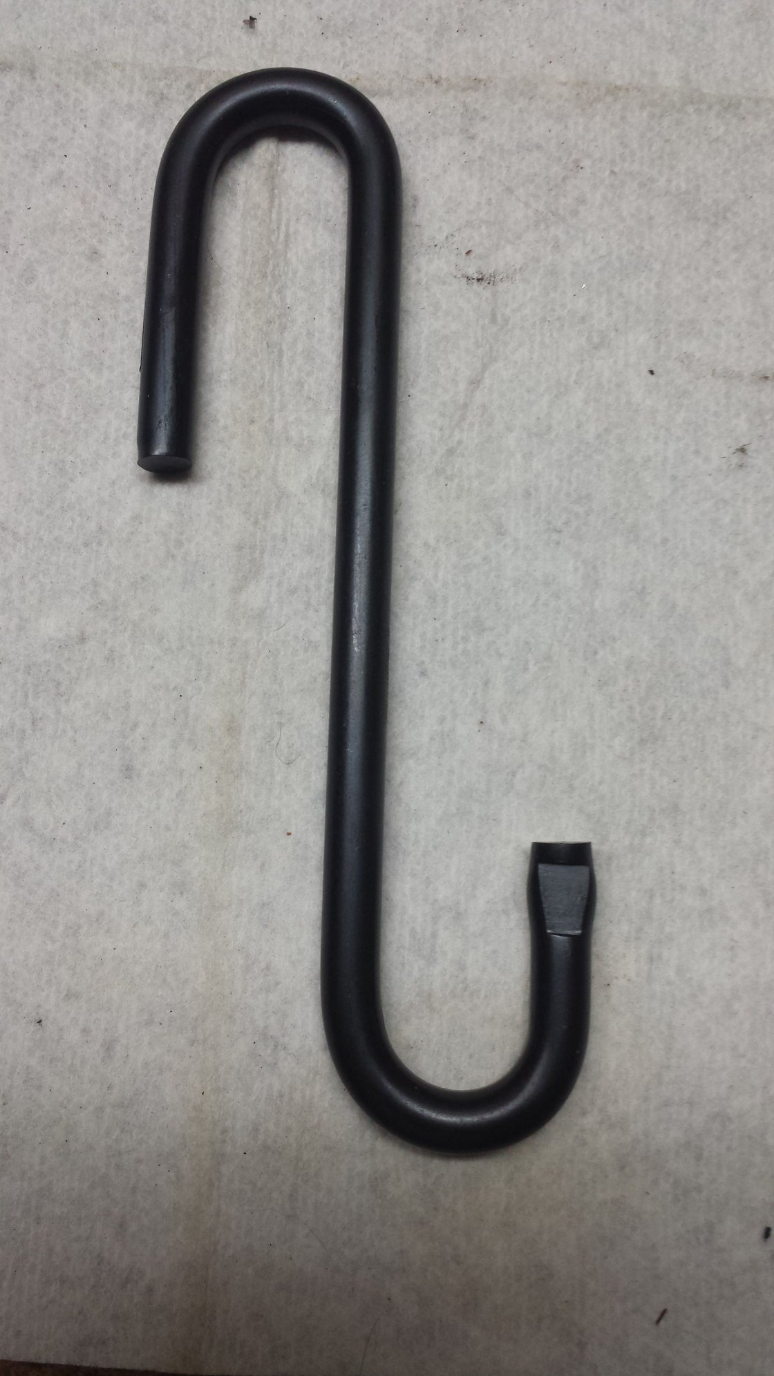

Here go, got it yesterday, and find it tough to install, not used to it, fender glass seems to sag too far down to let spring go in vertically, it looks like a purrfect fit.....but tried a few times, can't get it in right....hate to pull the dash, and it's cold out there, damnit.....so may just try removing door and go from there...damnit.....
Old Dec 8, 2020 | 01:23 PM
Mooser's Avatar
Mooser
Joined: Apr 2011
Posts: 11,183
Likes: 3,334
So no notch on the end, guess that was their "patent"
Thanks
