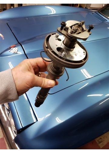

As with my other post about the really weird engine vibe, I want to eliminate possible single or multiple ignition miss or weak spark by testing with a known good distributor. Yep, I can get an HEI cheaply but don’t really want to mess with electrical. And, nobody around here tests this old junk anymore.
350 non-TI
obviously will pay shipping both ways. Anybody have one that is willing?

If you want to eliminate all your worries about distributor problems install a Crane fireball or Pertronix ignitor. Yes you will have to upgrade your ignition coin. You can bowwow my OEM 1969 dist, but It has the Crane ign in it if you so desire. T
P.S. If you want I could take your dist to my favorite shop 'C&S Preformance and have them check out your dist. They can rebush it change the curve if you like.

It would be cheaper to buy a HEI off ebay then to pay freight. I have bought two they are cheap billet have a tach drive and work great. One wire hook up a monkey could do it. well a trained Monkey

I may contact them as there are no race shops in this area. Also, throwing in a Petronix in my current distributor may be a less expensive way to go.

Sammy, If you haven't already taken Rescue up on his kind offer, I have an almost new distributor that you can have. At least it will save you the cost of return ship. This is a standard GM distributor from the era, no tach drive but a good test mule. If you've already made the deal, no worries.

Pretty sure he wants to use it as a tool to test and verify the original distributor to eliminate it as an issue....Actually a reasonable and intelligent way of verifying a problem. Theres many ways a distributor can fail

totally agree with not using cheap distributors...I just want a test mule to eliminate my current distributor as an issue. If it is the problem...first I will break out the bourbon and celebrate because I will have found the problem I am dealing with...then have it rebuilt.

The one Im sending you is an HEI. But it will just need a tremporary 12 volts to get it running. You wont need any difficult wiring changes, if that works still

Thought for you, and maybe not totally resolve the problem (assume you are running a points distributor). I had intermittent spark and sometimes no spark when starting my 68 327 rebuild (should have rebuilt the distributor before cranking up) so I hooked up the timing light so I could see the flash while I ran at different rpm's. I found out (of course, Ha!) when I had a nice steady flash, it ran great. When the coil got hot (think it was weak), and unsteady flash, of course, it was missing. I also hooked my volt meter between + on the coil and ground to see what my voltage was doing during starting and running.
Hope this might help. Rebuilding the distributor and new coil resolved my problem.

I do see intermitting loss of flash when I tested each wire a while back. Ohm'd each wire after that to ensure they were patent. Tested the coil and it was out of spec. Got a new coil. No change. Also, the timing mark seems to jump plus or minus 2 degrees or so when idling. Thus, I am thinking that the distributor, which is basically the only thing on the ignition system that I haven't rebuilt, MAY be an issue. That written, I am having a hard time making the intellectual leap that a miss at 3500 RPM and higher could cause the vibration that I am experiencing. But, worth eliminating.

Not sure what your original problem is, but the timing should be rock steady at idle. Certainly not a 2 degree bounce.....
Perhaps too light on the centrifugal weight springs?
