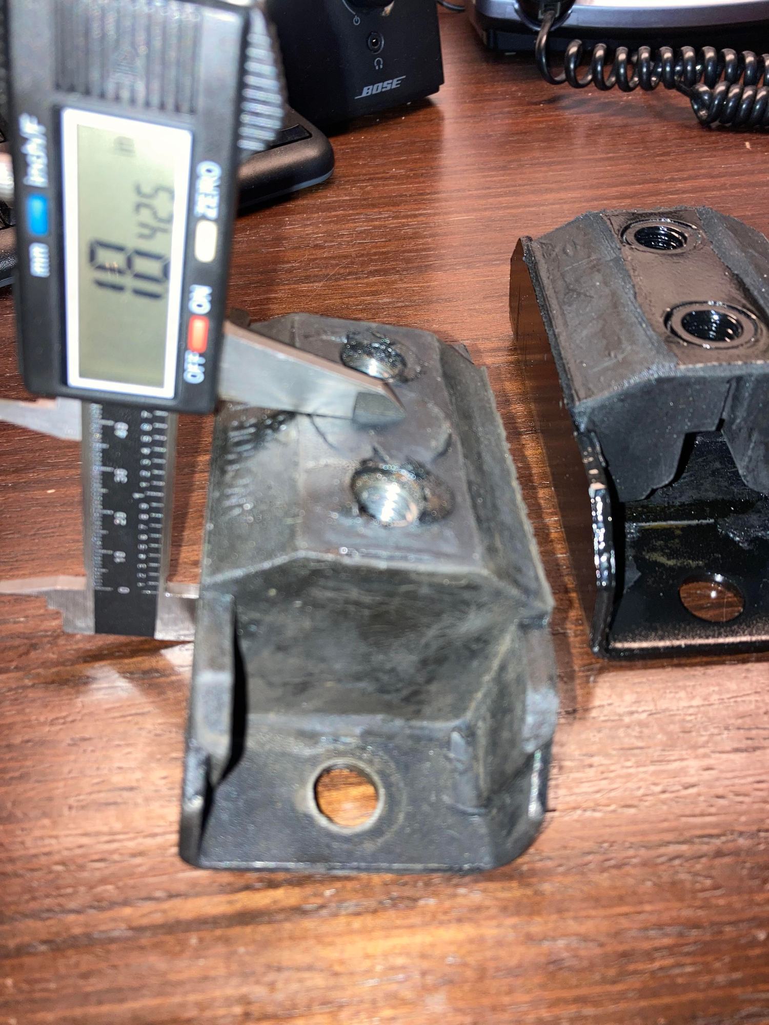

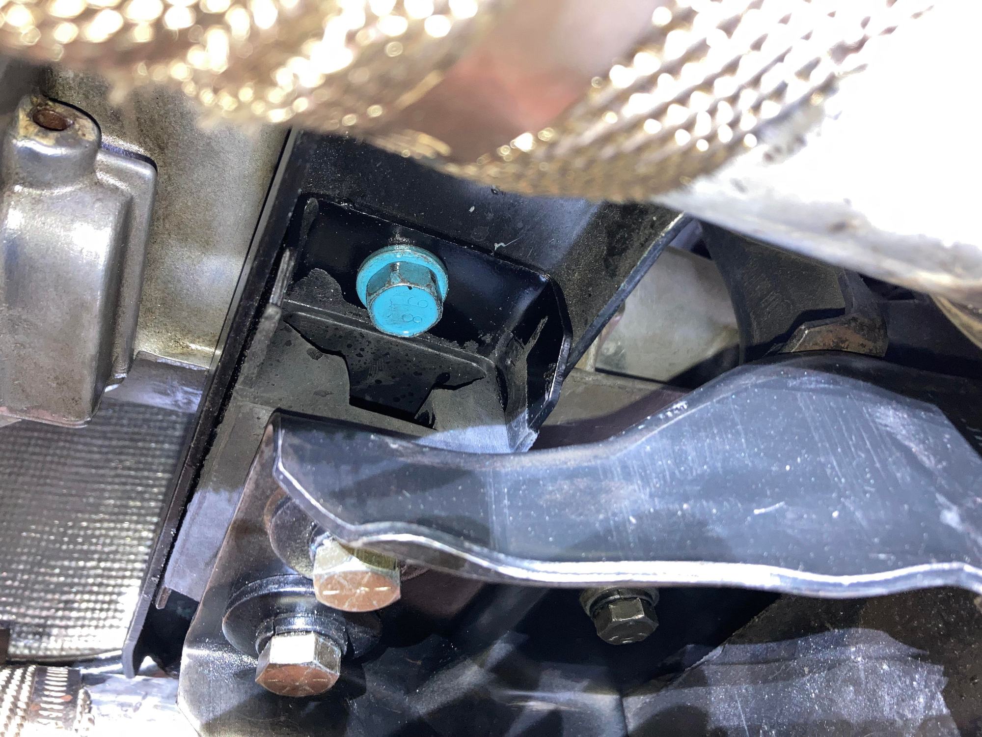

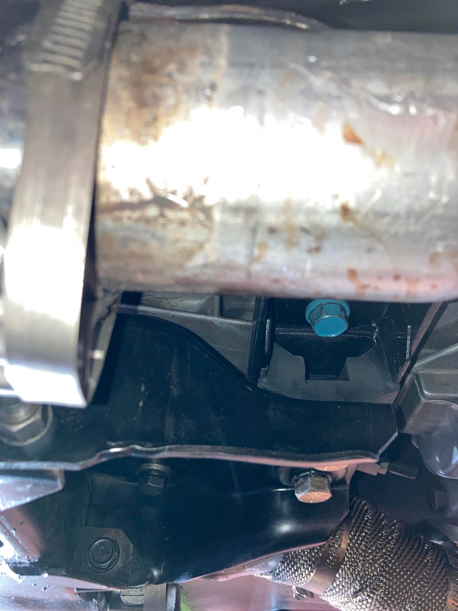

yes post 4 anchor 2378 from rockauto..note picture shows hollow..it is NOT…and used it was over 1.8..but not over 2 like the napa one.
boltted up even squished a little when letting tranny down..exhaust looks dead center now!
vibration still over 80 but MUCH better than that solid mount, and best improvement for vibration yet.
i really think they wanted this attachment to flex ..no way did that solid one allow movement..
it is quieter.
Looks centered!
