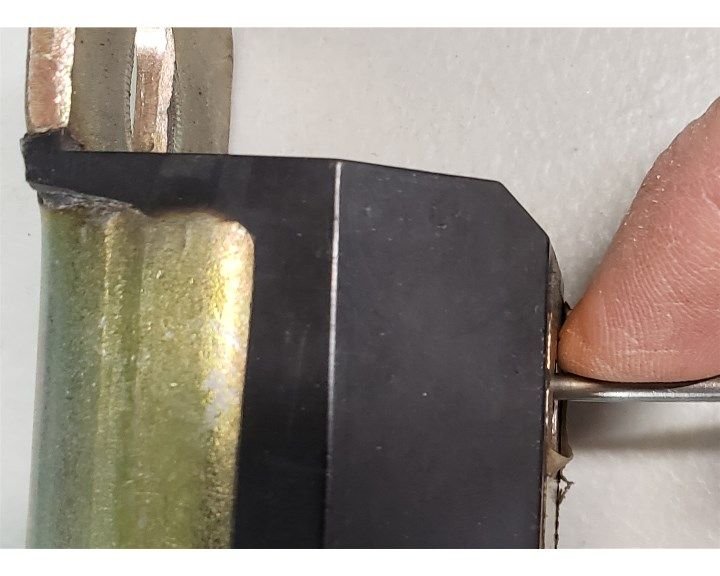

Hey Guys,
I wanted to share this info with all of you. I did a lot of searching for answers and found this subject had come up many times over the years here on the forum both in C3 and over in C2. It may save some of you a lot of grief in the future. If you have to replace your transmission mount, which is a fairly common wear part on both automatics and standard transmissions, check for this design flaw before you install. GM no longer offers the original 3792133 mount, so only aftermarket is available to us.

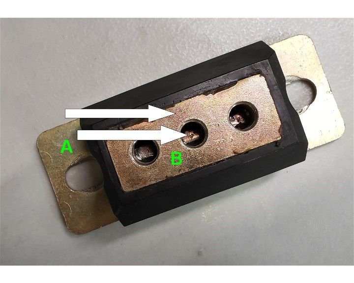

Just got my car back on the road last week and I was trying to run down a noise transfer that I would swear is a bad transmission mount. But it's brand new and looks like a good quality after market piece.
So I start to do some homework and decide maybe this mount is a bit too tall, and it's pushing the exhaust hanger bracket up to the point where the exhaust pipes are touching the cross member ports.

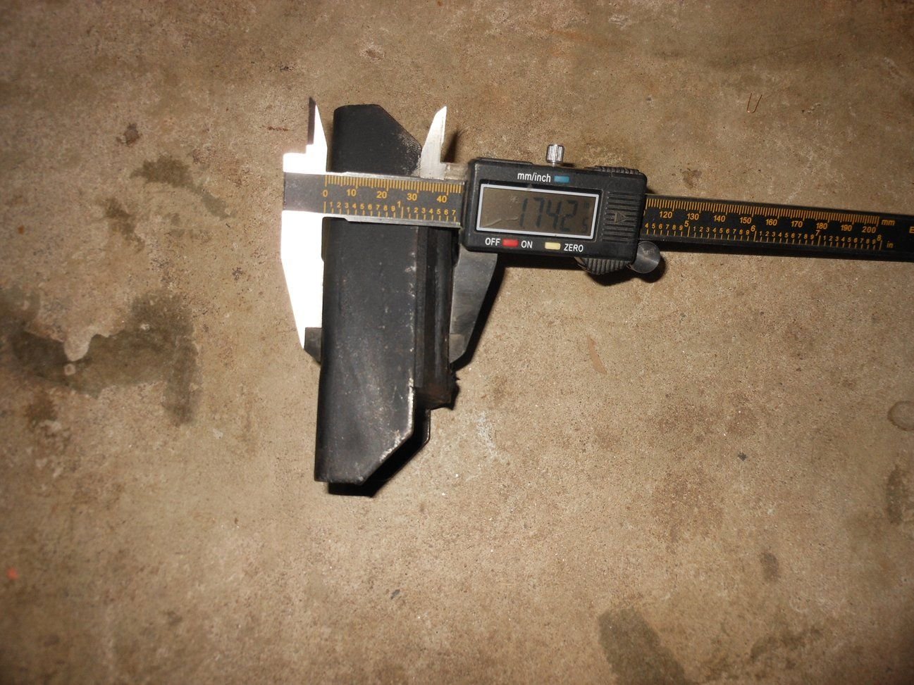

I check it and the pipes look pretty close. I remove the mount and measure it, it is 1 3/4 tall. So I reach out to the forum members here for a measurement of an original mount and almost instantly Richard454 (many thanks brother) sends me this pic of his almost new, original mount and it is the exact same height as my after market piece, so I have to rule that out.

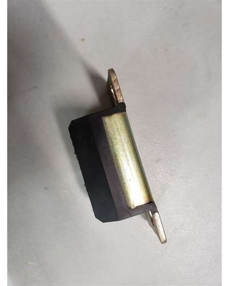

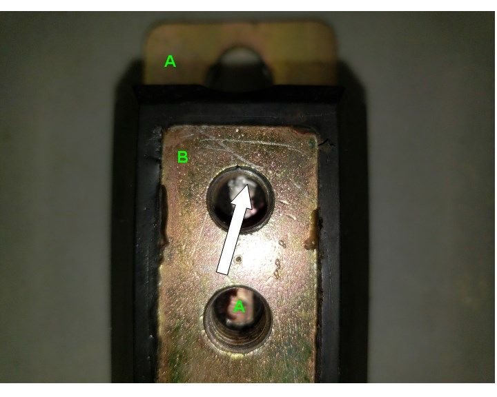

I start to look closer at the part I have and check the separation of the two steel pieces. I will call them steel part "A" and steel part "B" here just for clarification.

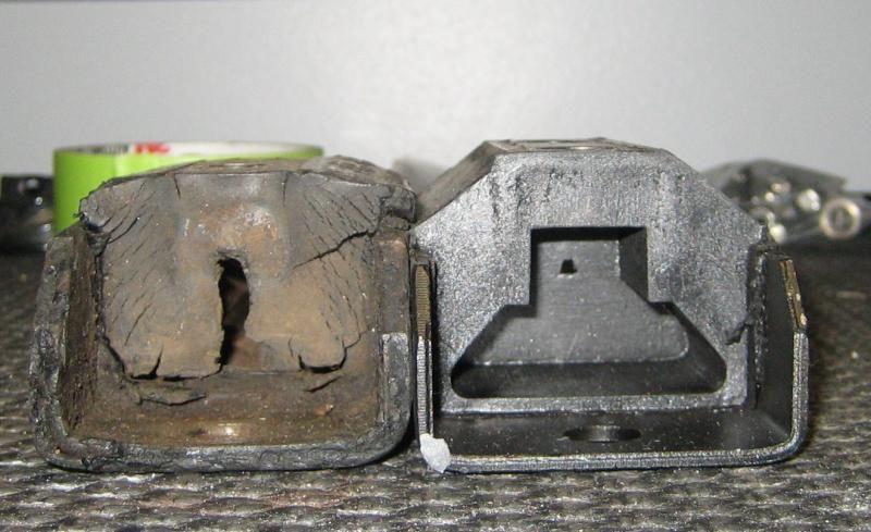

I know that the orig. mount did not have a bottom to the threaded holes as this one appears to and it looks like both of the arrows point to part of steel "B'.
I use a slim punch to tap steel B and get the expected bounce. I tap the bottom of the hole and it is rock solid. So the bottom of the hole is part of steel A. This looks bad as I use a pick to determine there is literally a hair's breadth between these two pieces of steel.
What looked like extra rubber flashing at the bottom of the hole is actually the only area NOT in contact from steel A to steel B.
I can see the mounting bolts have actually scraped the bottom of the bore touching steel A together with steel B making them one solid piece ! How can this be?
So I check the bore depth.
And find I only have about a half an inch.
Difficult to tell by this pic as my camera focused on the higher plane, but there is a mark from the stock original mounting bolt bottoming against the lower piece, where the white arrow points.
So I've been able to determine that although this looked like a very good quality part, it's design is completely without research or test fit as to functionality.
In short, it is junk.
I will order another mount from a different source tomorrow but I'm convinced I've located my problem.
Cheers, Greg

rockauto made in korea it said on side..seemed pretty accurate when i put it in..remeber OEm was hollow under it too.. this one kinda carved out?

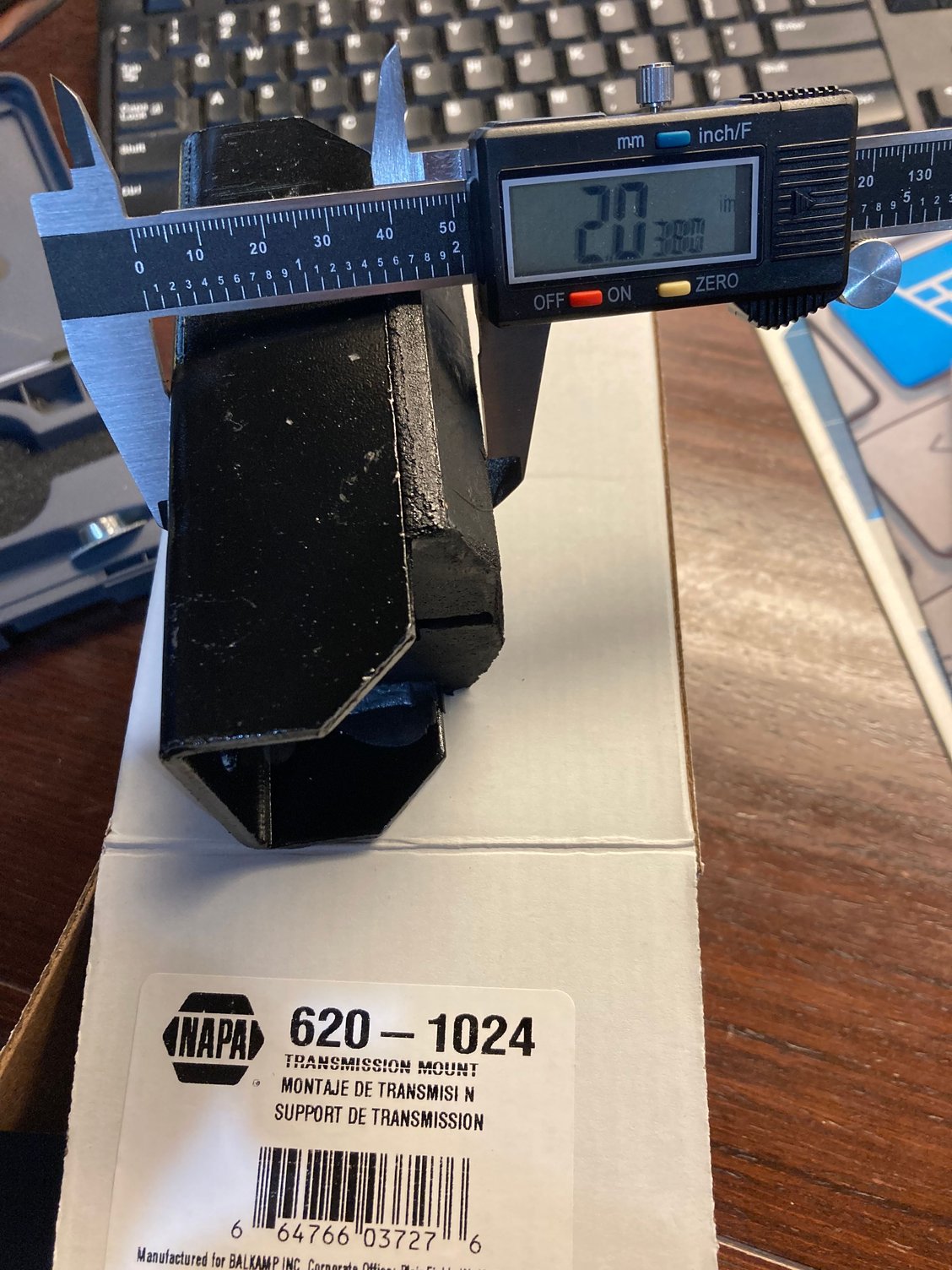

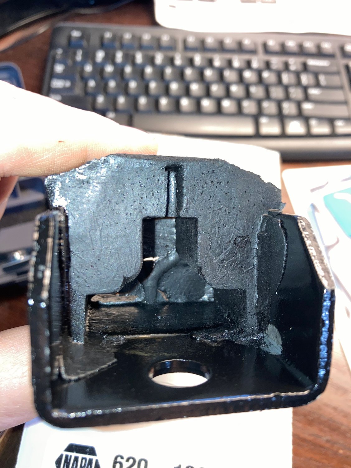

here is a new napa one..
China..
the measurement i get is over 2 inches where i see Greg posted 1.7"
would love to know what a manual mount should be and not a universal mount auto /manual.. Was there a difference auto to manual? height? other?

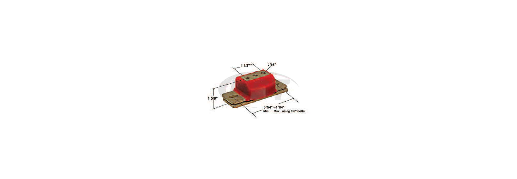

EDIT- See this shorter universal mount! 1 5/8 and maybe shorter without spacer? too short?
https://www.energysuspensionparts.com/3.1158

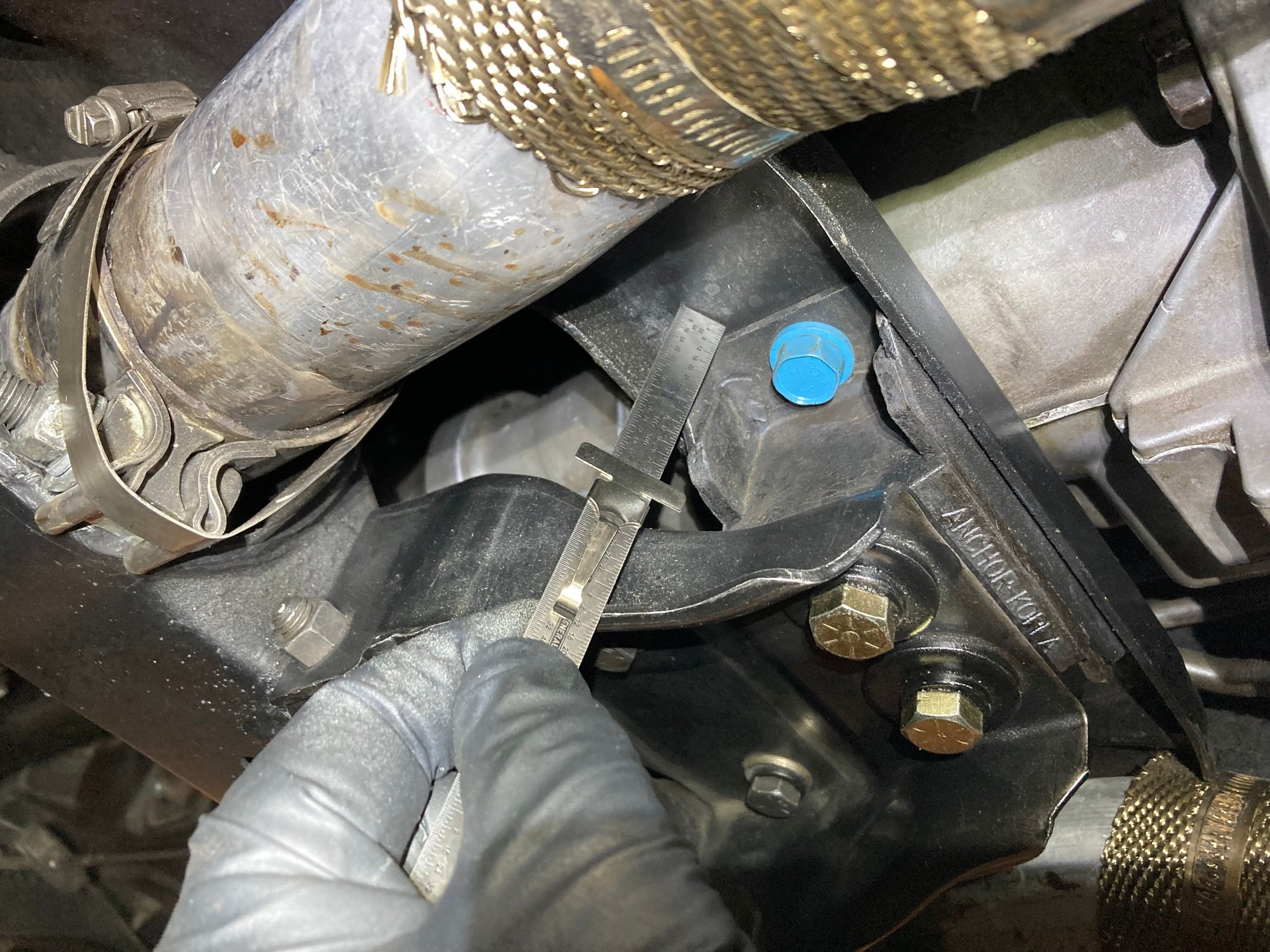

so i quickjacked to see my Korea rock auto mount i put in a while back..
interesting things i didn't notice before;
- Best i could measure with weight on mount (whatever that is..) i get ~ 1.85"
- The damn thing is SOLID! there will be limited squish and assume not much vibration control on shifter??? (over 80 MPH). the picture shows not solid..
the search continues.. hollow mount rubber right size. Heh Gary, i'll take that mount if for sale and you ever find it!
will update searches..
maybe put the short poly in and drill some holes to hollow it?
SOLID!!

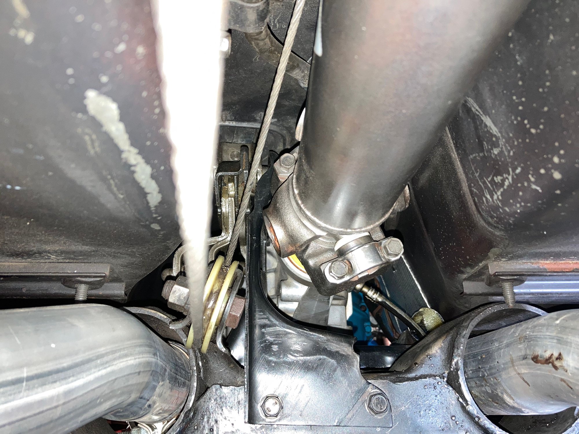

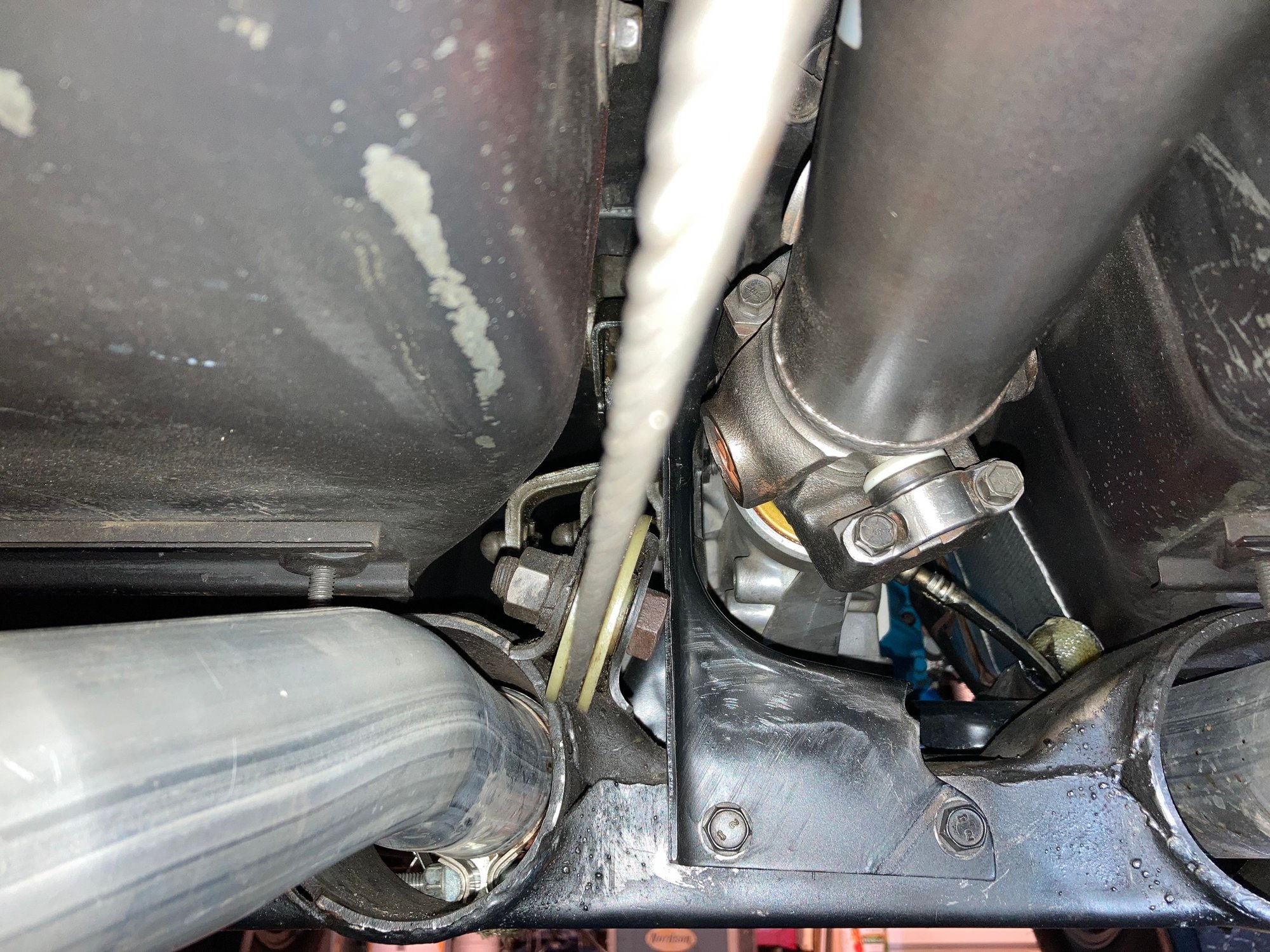

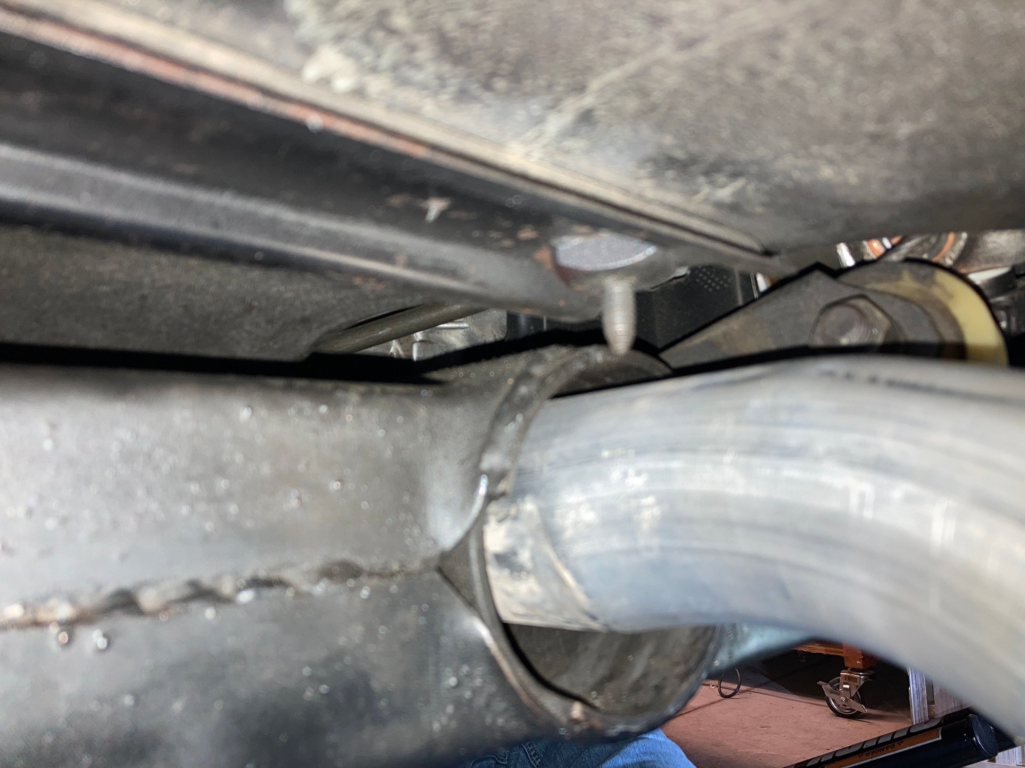

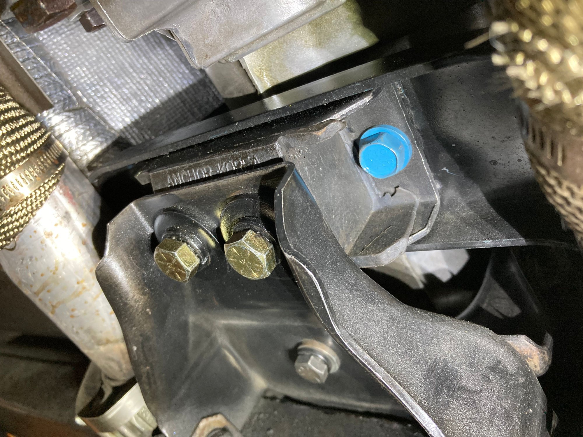

interpon, I can't tell by your pictures, but are you having issues with your exhaust touching the cross member due to the trans mount height? I was and that's where my noise transfer/vibration was coming from.
Koreans are known for making great kimchi, not for making great transmission mounts for American muscle cars.

I shall look when up again. GREAT POINT
I use ss worm clamps to hold tight against exhaust hanger as i use band clamps instead of standard exhaust clamps.The u bolt type indent the pipes and you cannot get off and on and still a PITA with these.. but doable. not that i remove them often!!!
round 4 O'reilly's coming and if 1.8 or less and hollow i will be changing..shall report..

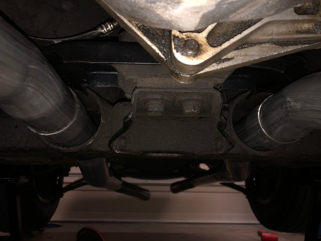

Looks like enough clearance currently in holes.. could be a little lower. with no hollow mount there is no give so hoping new hollow 1.8 or less will help more if it can slightly crush. passenger side higher for some reason.
if i put that chinese 2 incher on it would be almost touching!

I agree, that looks like enough clearance.
Damn, I just realized that I did not do a follow up post to my original. I should have posted which mount I ended up getting and that it did solve my vibration/noise transfer problem. I'll dig through my file on this car today and see if I can find the correct receipt with source and part number.

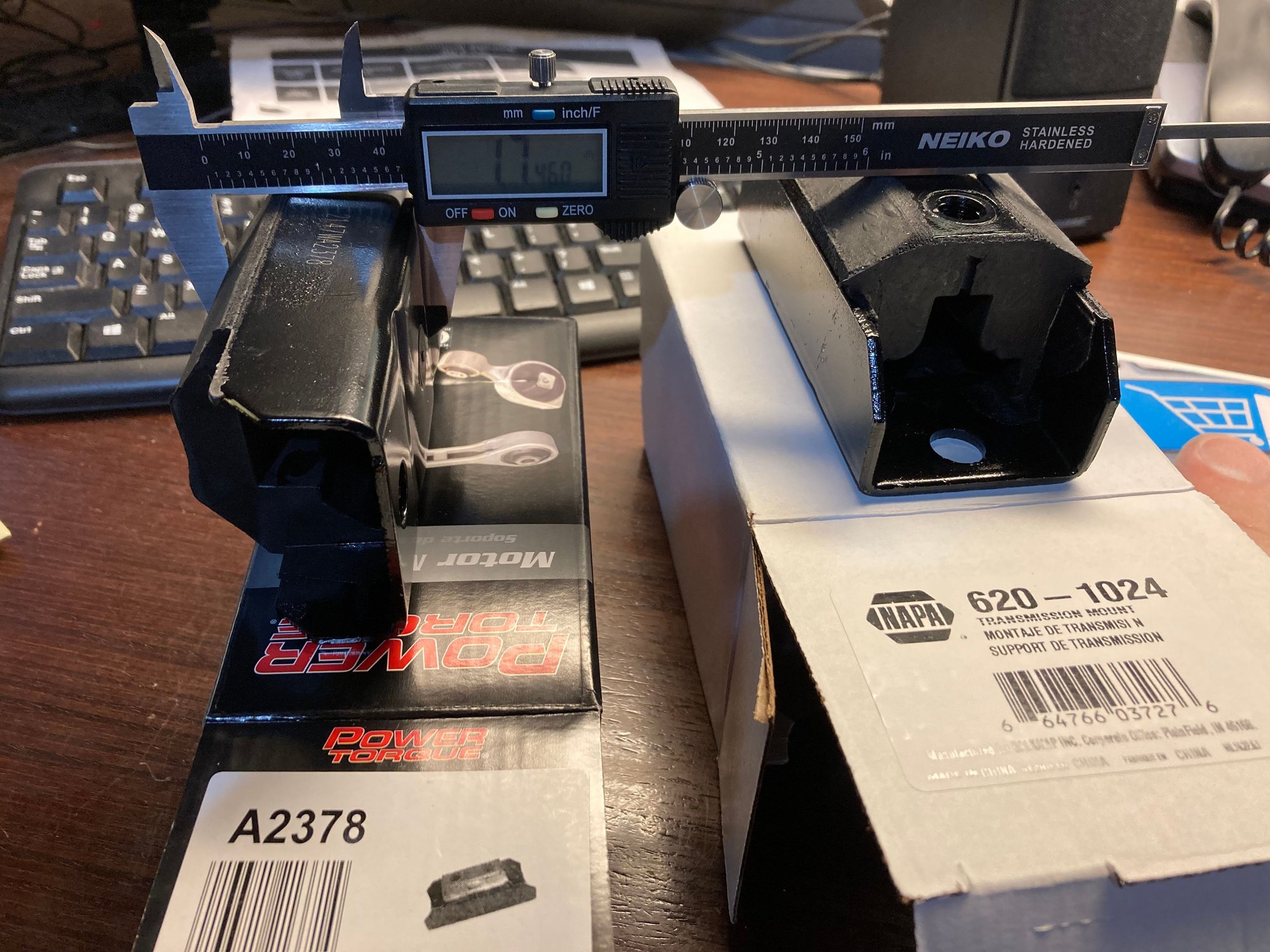

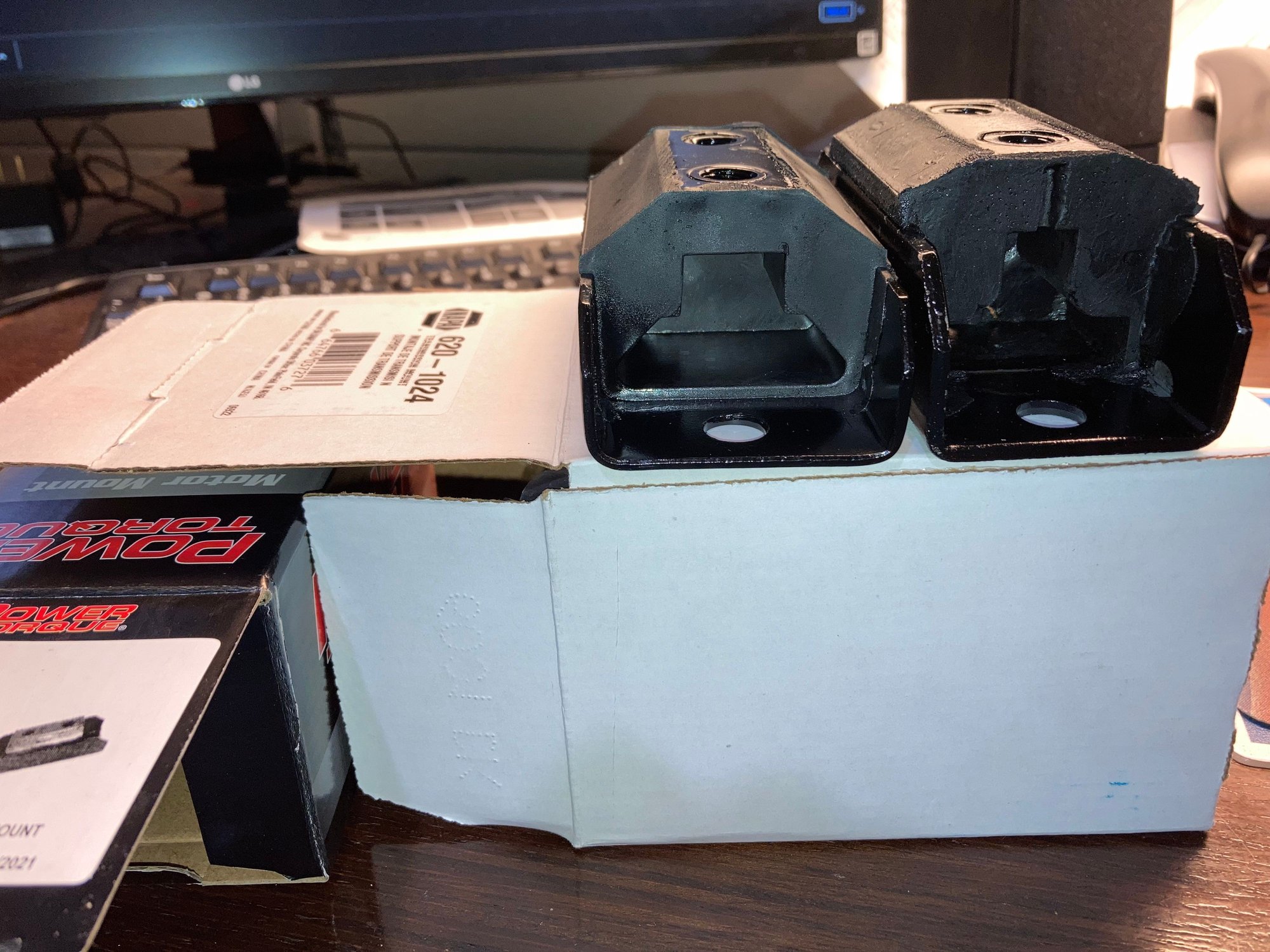

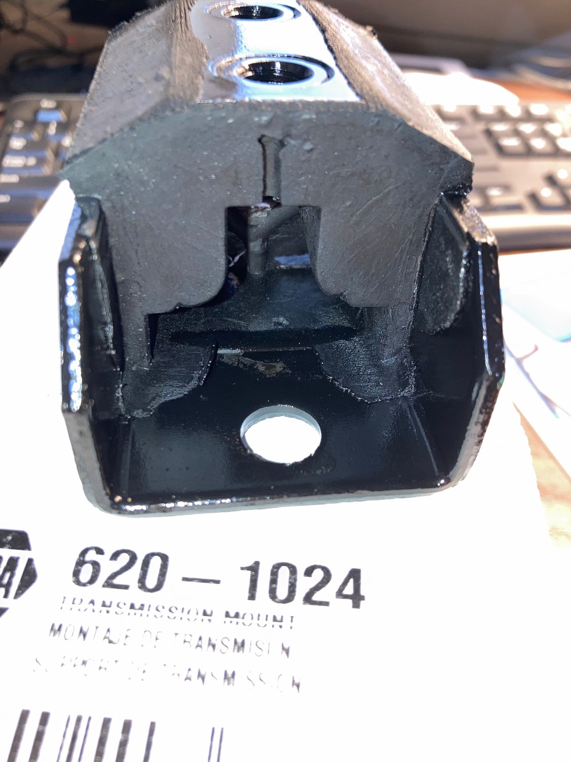

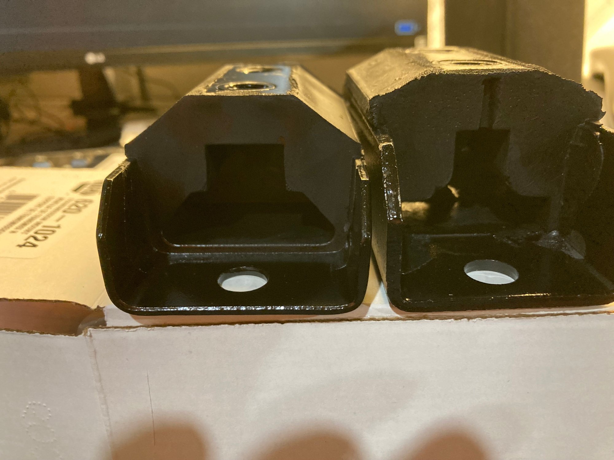

Chinese Oreillys A2378 Power torque brand!!!
https://www.oreillyauto.com/detail/c...?q=a2378&pos=0
- measures 1.75"
- has a cutout similar to OEM (more air less rubber)
- the Napa one is 0.14 " thick metal (2.25" width overall) and the power torque is 0.1 " (2.37 overall width). i don't see this as a big deal.
I can even slightly move the power torque one by pressing on it where the Napa 2 inch has less opening and very ridgid. And of course the Korea anchor is solid..so no give there..
getting closer!
