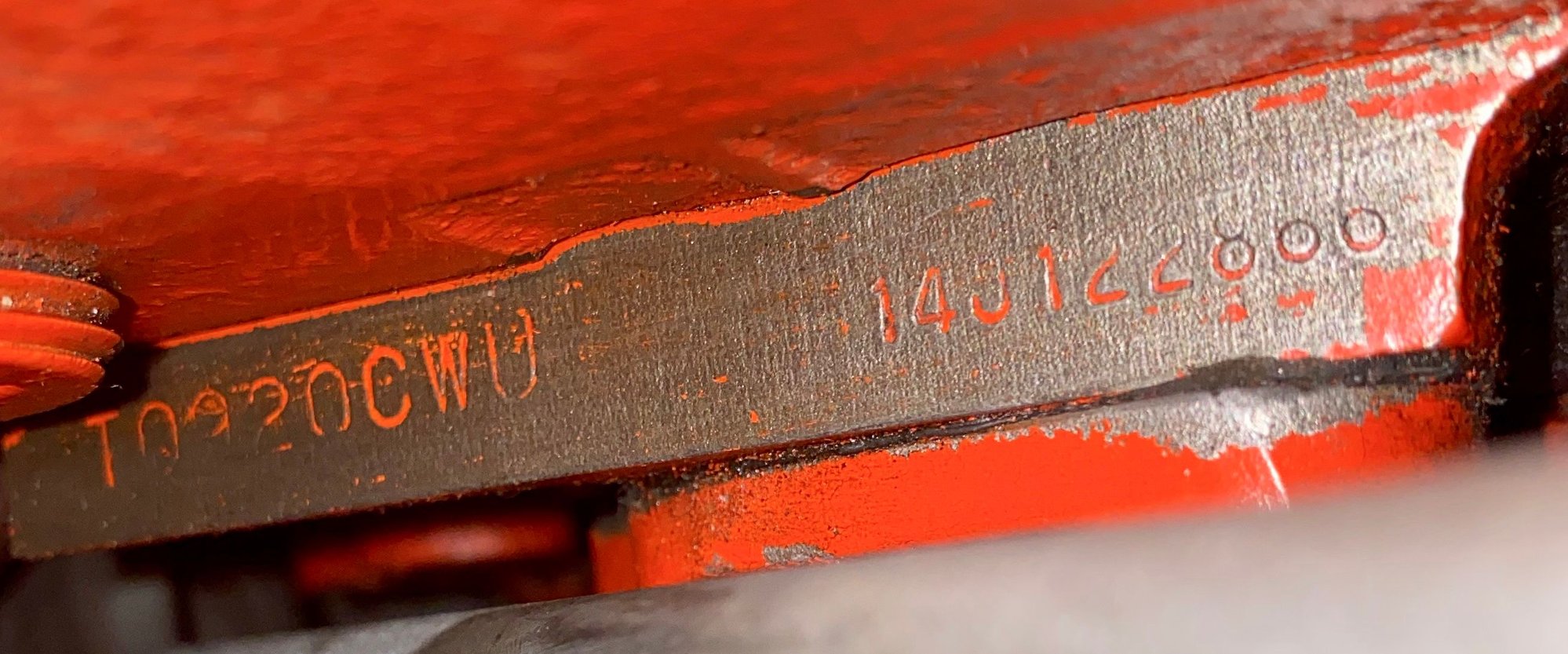

The engine block code is CWU, which according to http://www.gregwapling.com/hotrod/mo...rs-cth-ij.html is a 235 HP 1974 police chevy engine.

Post a pic of the stamp pad and block casting number. The numbers don’t match, right?

Here's one pic, where do I find the other # you're asking for?

Am I missing something here? Block stamp from the OP picture is "T0220 CWM"
T0220 = Tonowanda built engine, February 20
CWM = 1973 or 1974 LS4, manual transmission
As others have said, please post a pic of the VIN derivative stamp from the pad.
Also, what year is this car you purchased and what transmission does it have?

Are the last three letters on that block pad "CWM"? If so, that's an LT4 454 engine from a 1973 or 1974 Corvette 4-speed. 275 hp (in 1973), and unlikely to be from a cop-car.
CWM = 1974 LS4, manual transmission
I thought it was CWM at first too. Someone else said it looked more like a U to them so I was bowing to a more experienced eye.
CWM pulls up as 1973 corvette for me but either way that's better news.

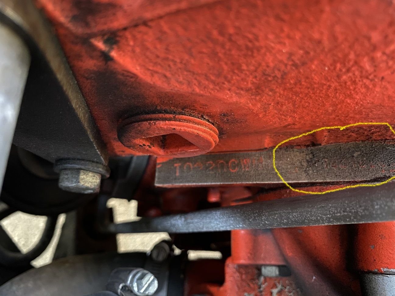

In the area of the yellow circle there is a stamping. There is something stamped there, I can't read it from the image you posted.
Try to get a better pic focused on that area.
Look in the area of the yellow circle
What year is the car? Transmission? VIN?

Alright, it's pretty clear that it's CWU, so we're back to a non-vette engine...
And the rest looks like 14J122866, but I don't know what that means.
And the rest looks like 14J122866.....
that’s the VIN derivative of the car it came out of. I’m going to go out on a limb here, but the last 6 digits are not the same as the VIN number of your car?
