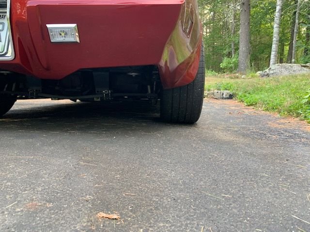

Here is what I have on my 76. When I did the rear conversion I wanted the 68 look, but it just wasn't cost effective. I used a set of flush mount lights and added the LED bulbs. The result is better visibility than the original 76 lights. Another pro is you don't have to cut up and do any fiberglass work. I simply had to drill a hole for the wire to pass through. you can level the light when you install the two screws to hold it to the body.

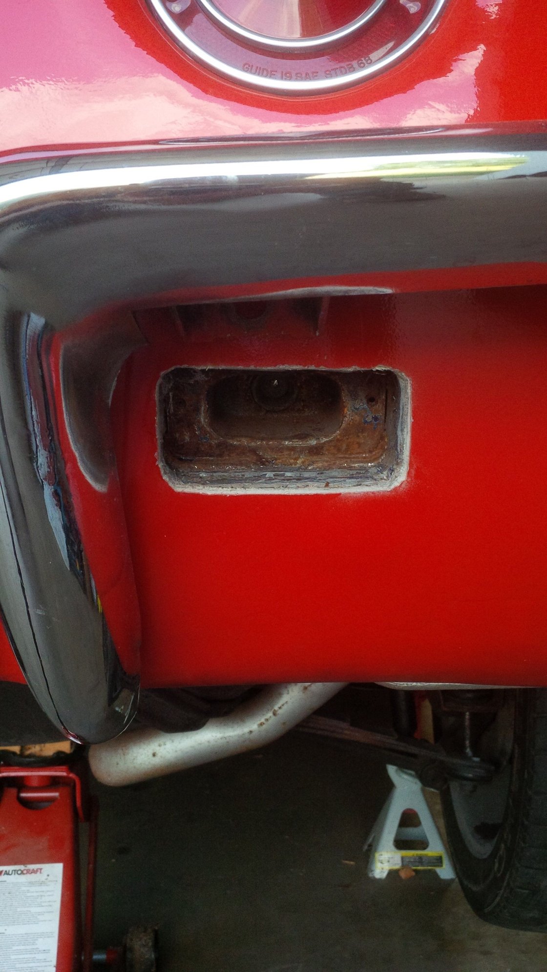

The PO of my 68 convert did just the opposite of what you want to do. They fiberglassed over the reverse lights and painted the rear valence. I cut away their modification and put back the lenses. There is a bracket on the rear that is probably difficult to get, so you may have to use one of the modifications suggested in the other posts here. I like having four brake lights too.
backup light opening after carefully cutting away fiberglass covering it.
