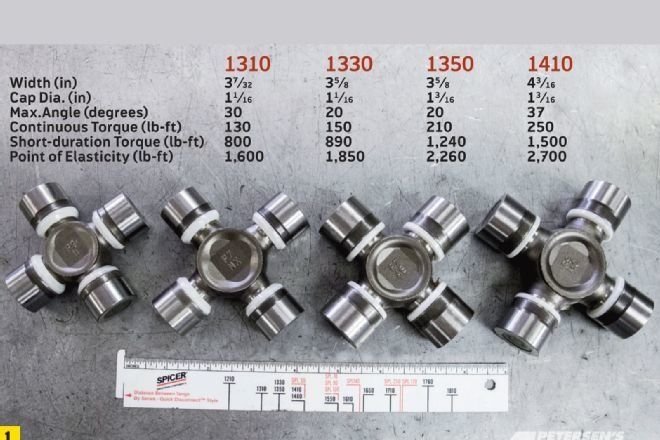

Originally Posted by Peterbuilt
Thanks.

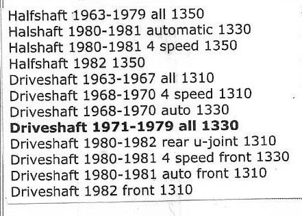

This chart shows the confusion I'm running into.
VTech said half shaft in 81 Auto is 1350.
This chart shows 1330.
Will both the 1330 and 1350 fit?

Default Does this help?
Yep this is correct for the 80-82 auto and manual cars. Thanks Peterbuilt.
