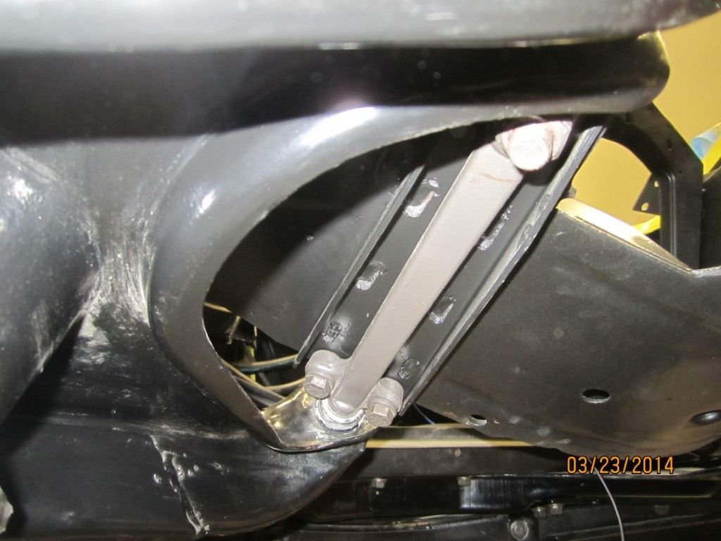

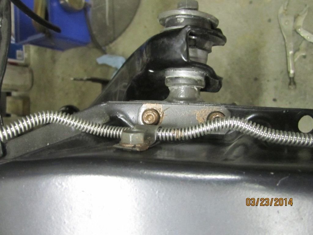

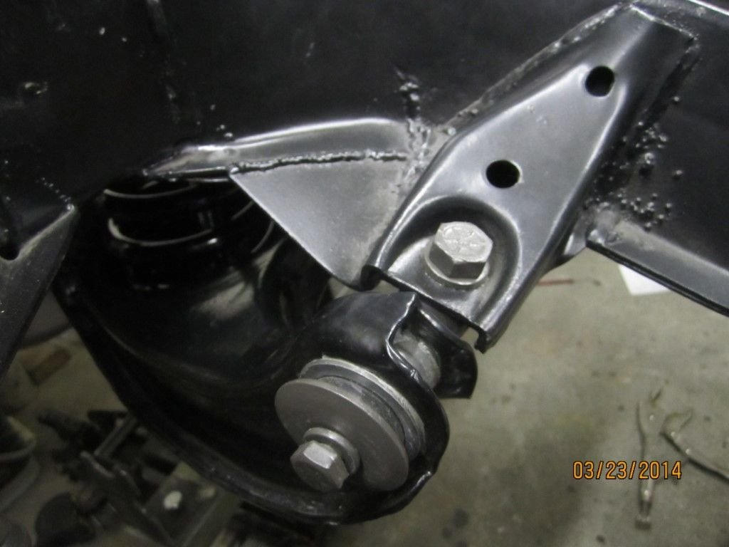

What exactly do you mean "the control arm bracket has been welded?"
(Please ignore the triangle gusset added into the corner)
Before going in too far I'd measure and make sure the rather flimsy control arm isn't bent, a good hit into a curb will bend it out at the end of the arms where it meets the shaft. And for that matter, the shaft will bend where the bushings are.
Do some triangle measures from known positions comparing the drivers and passenger sides, frame fixture hole on the passenger side to the end of the control arm shaft on the drivers side vs the other way and then to the front, etc

Then the lower U channel would have to be cut loose to move the rear end of the shaft as well. You can see where they welded through those slots underneath. Between those and the weld around the edge of top bracket I'm surprised it could have ever been moved in the first place rather than the frame being bent somewhere else.
Getting that channel off without ruining it seems like a tall order. Replacements were available but I'm not sure how available there are "over there"
M
