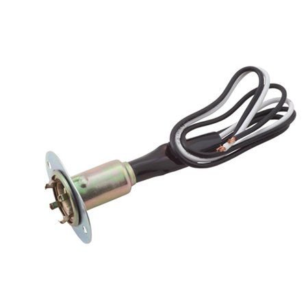

Get an couple 1157 bulb sockets to mount on the inner housings-
I like this one- as you can rivet ( or use small bolts) it to the housing- rather than the clip/teeth one that won't hold worth a crap-
https://www.delcity.net/store/Bulb-P...10384.h_810385
Then wire like this- the Light green wire is for the back up light-
So you'll have the dk green and brown wires - and a ground (black) going to the pigtail
Then do the same for the left side- yellow and brown wire- black as ground
