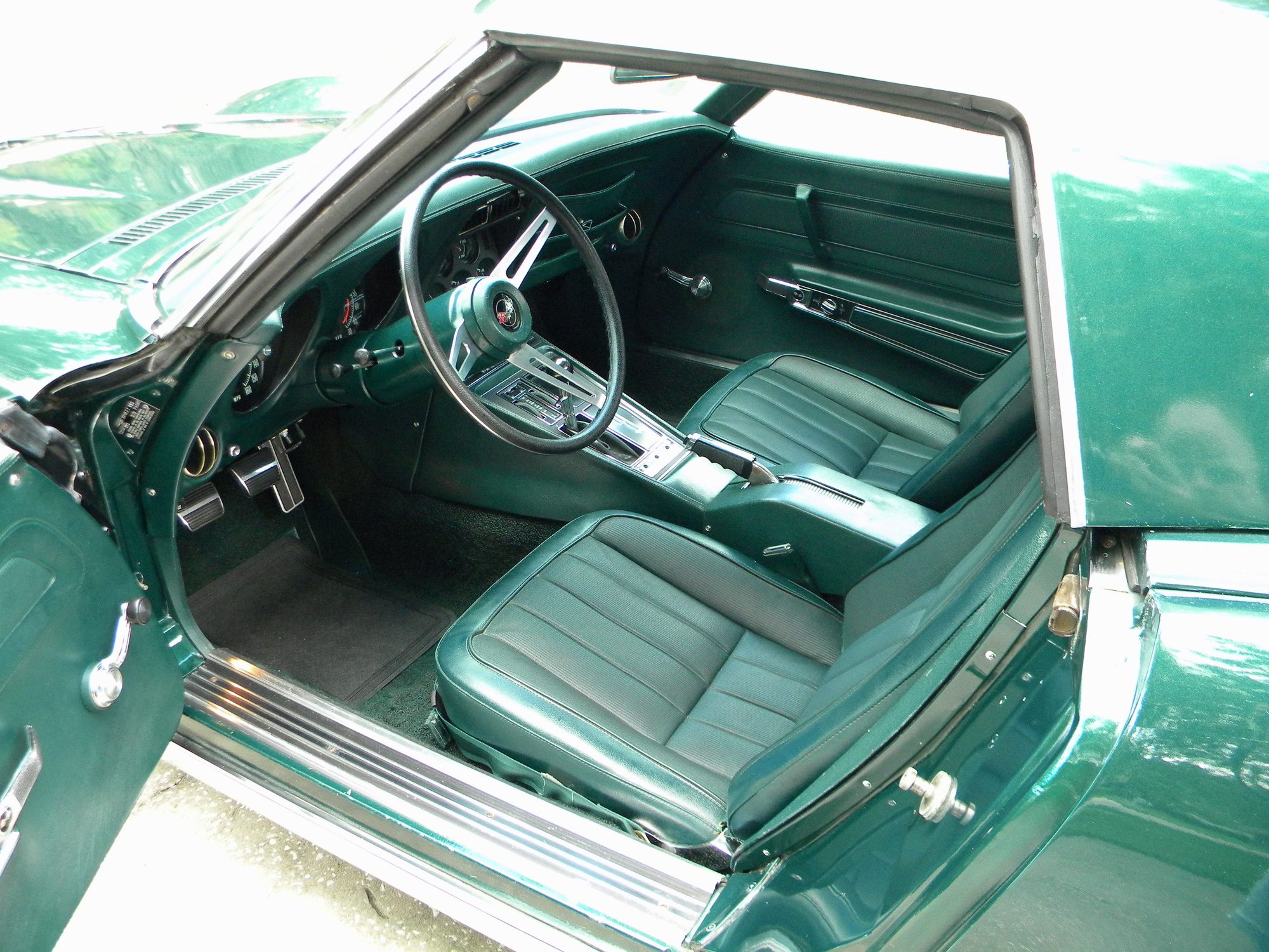

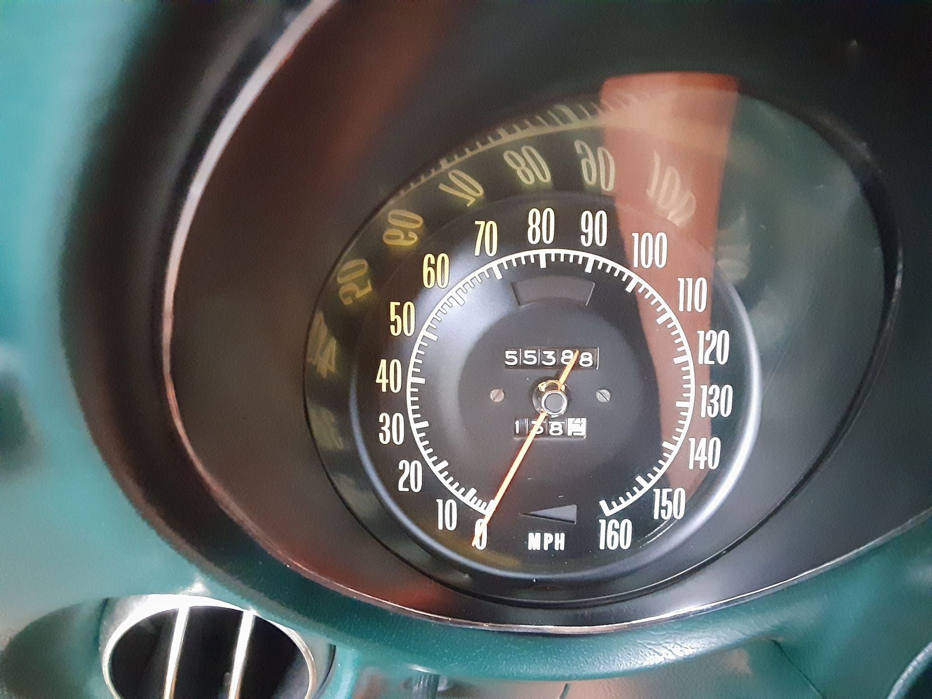

Interesting post, I always like to see good photos of low mileage original C3's for comparison.
"When I phone screen "original miles" ads my question about documentation is often answered with "well it's been sitting, on non-op or I hardly drove it during the last xx years I have owned it "."
Hey, I'm that guy! I purchased my '71 in 1975 from the original owner with 28,152 miles when I transferred the title at the DMV. It was my daily driver for a couple of years until I bought a new car. Don't really know why I kept the Corvette, but I still have it. As of today, I have driven the car 27,238 miles since Oct. 1975, which were mostly up until around 1990. I have always had full coverage insurance and new tags every year, so you can imagine my costs per mile to own it for 45 years.
Yes, I would expect a potential buyer to question the mileage, so I can only state the mileage is true as a 45 year owner, and the car can represent itself. The only bushings that have been replaced are the upper control arm bushings, the ball joints are original, the rotors are original...(the rears were drilled out to replace the parking brake springs), all original interior, and the lacquer paint is 50 years old.
I know it's sad that the car hasn't been driven much over the past 30 years, but that's just the way it turned out. Looking at some old photos, I see that I have driven the car 36 miles since 2002, it currently has 55,390 miles. It has always been garaged and repairs made as needed. Strange how things can break or go bad just sitting. I'm sure there are others out there, but it seems like when they are stored in a barn they don't hold up as well compared to garaged.
If the potential buyer thinks my '71 has 155,390 miles, all I can do is disagree.
Odometer 9/2/2002
Odometer 8/19/2020
