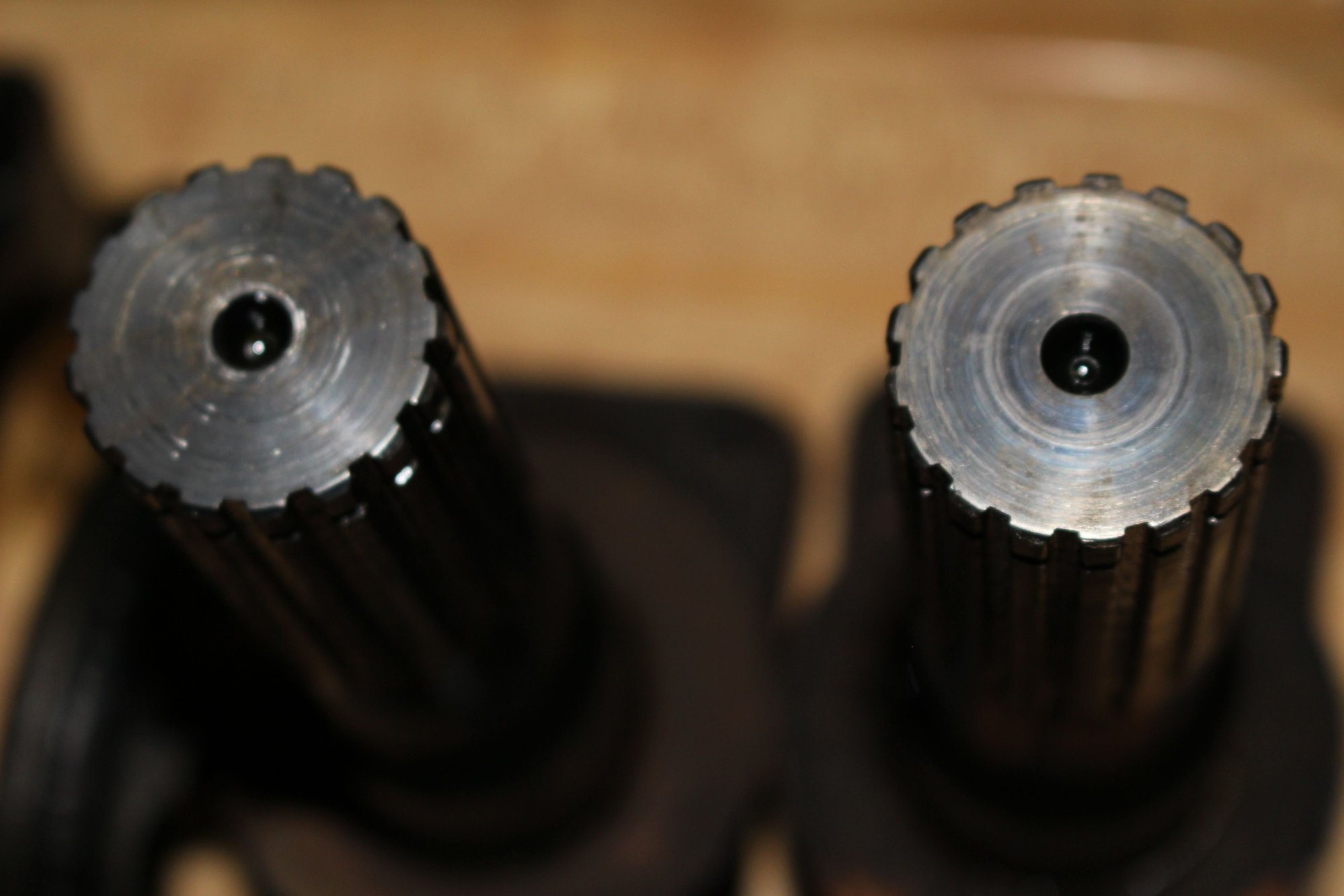

So is there a way to examine the stub axles to see if they have too much wear? See pics. The toothed section above the c-clip slot appears to be .188-.190" tall.
Here's a close up pic of my stub, and a new Eclkers "Hardened" one. My tooth "slant" appears shorter.

If your friend has a Wilson Rockwell hardness tester check the hardness of the axle faces. 50 Rc is good. If the dimension is 190" then there's little wear on them, they don't look bad. If they are soft but in the 190 range you can source a heat treater and have them hardened and tempered.

You can run GM 1/2 shafts in either size for you application. There is a widespread picture of a twisted 1/2 shaft online, look and you will see other mods as well so the application has a more power and TQ then yours. Typical shaft failure is with the u-joint not the shaft. We broke a Tom's shaft, it was not the shaft but the solid spicer joint sheared under a hard launch, taking out the shaft yoke- the real weak link area more so then the tubes.
Hard use will snap the outer axles at the base of the threads. Some imported axles broke there with little abuse. I know of one guy who had it happen just driving on the street, it wasn't from abuse it was from cheap imported parts of low quality.

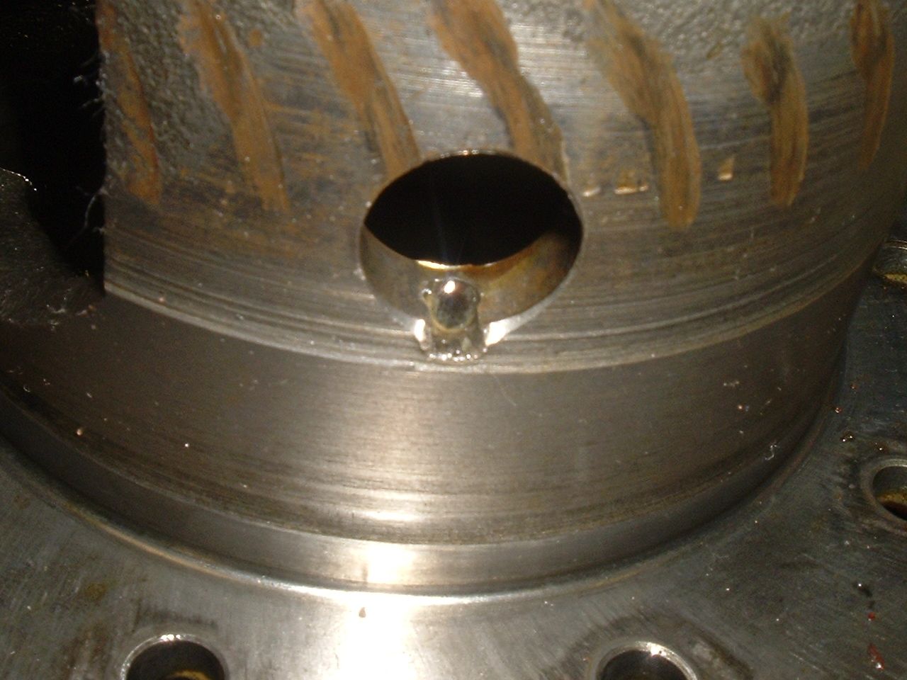

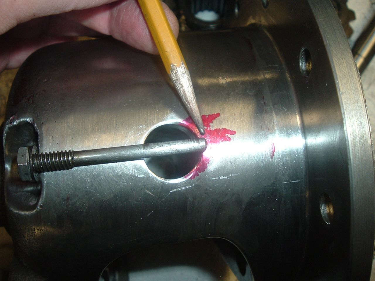

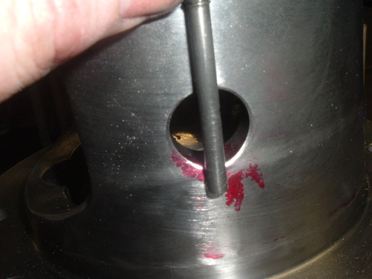

remove the cross shaft bolt. lay it outside the case where it would be in place and look to see how far through the cross shaft the bolt extends into the case. The Eaton cases are shallow, just about everyone out there, sometimes they break out the case and break the bolt. Milling the pad lowers the bolt and extends it into the case. Something I do on every posi I build.

I had the cross shaft retention bolt pad milled down 0.120”. When I trial fitted the retention bolt after, it bottomed out in the case so I ended up trimming the bolt a couple thousandths off the tip. Be sure to check that if you choose to make this modification.

Once the pad is milled the hole needs to be drilled and tapped to allow the bolt to fully seat. You want to get full extension into the case.
I went back and pulled some pictures, since Sunday Night Football is over now.
Here is a bolt on the case you can see there is little extension into the case.
After milling, drilling, tapping
Case broken out

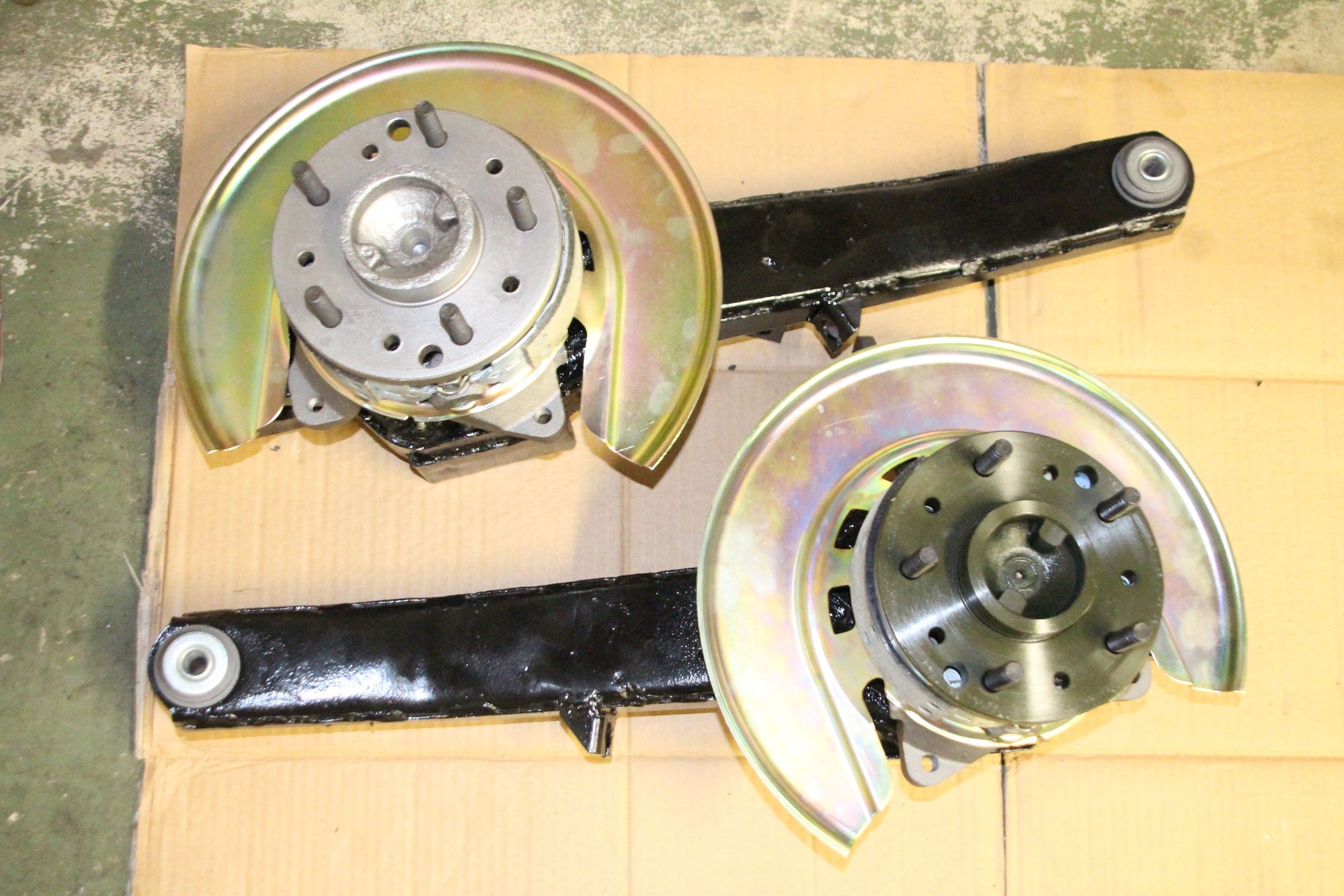

In another post I found a description of a Chinese axle vs a Spencer Forge (IIRC)
I just had a shop put a new axle in one of my trailing arms and does this fit the description of a chinese one?
And Should I worry about it for my 500 HP street car?

So to follow-up.
I found out this imported axle was sourced by my vette shop (Ron at Corvette Paramedics) from Van Steel. We called Van Steel together and after a nice talk, Paul at Van Steel assured us that they have been using this one particular supplier of axles for several decades. They are actually from South Korea. They have had them heat treated and rockwell hardness tested and their is barely any difference at all between them and OEM GM ones. Certainly less than 5%. In his opinion (40 years of working with vettes) there is no need to pull them to go worth the USA made ones. Almost no gain. (Although they both would be glad to sell me the USA ones if I insisted.) . In short, He would run them in his car, if it this was his car..
Case closed.
And Kudos to both men at both companies! Two outstanding suppliers and we are lucky to have them!

Depends on use. Many GM axles have sheared at the base of the threads with some abuse. I know of a guy whose new imported axle sheared a few months ago without any abuse. 500hp is about the point where they break but again it depends on power, trans, traction and your right foot. Nothing against either vendor , as long as you're happy good to go. I have never had a Toms 31 break yet. Rockwell testing is just that, a test of the hardness of metal but that meaningless unless you know what level it is on the C scale.
