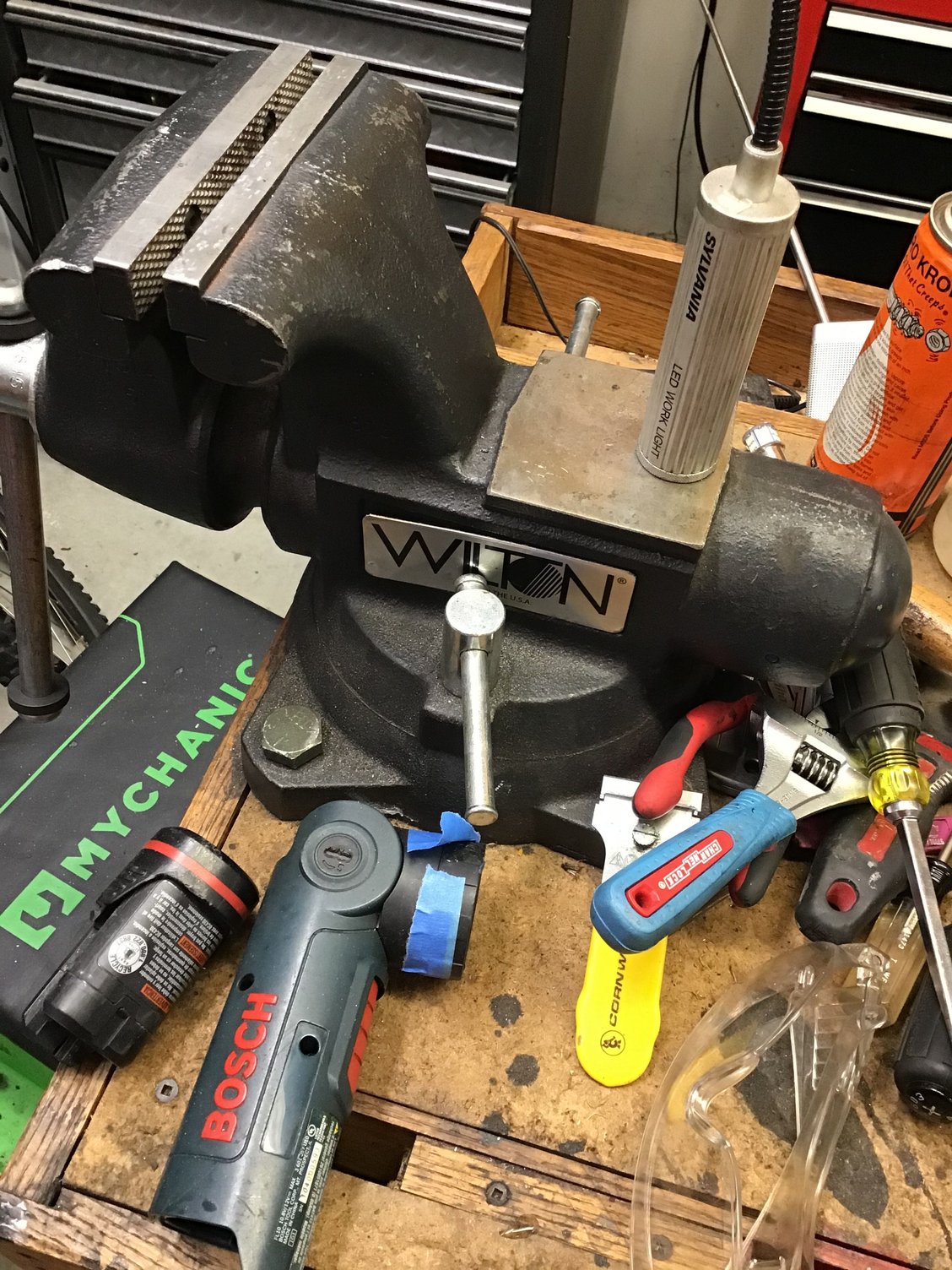

Awesome I agree I always struggle with clearance loosening on the car, a good vice is great investment., hard to find used USA so i just bit the bullet and bought USA made wilton...worth it..on a solid table/ bench
edit..omg. 2016 thru zoro i got a 5.5 inch combination vise shipped with free hammer for 319 after 20 p% code..discontinued..these are 1500.00 bucks now!
