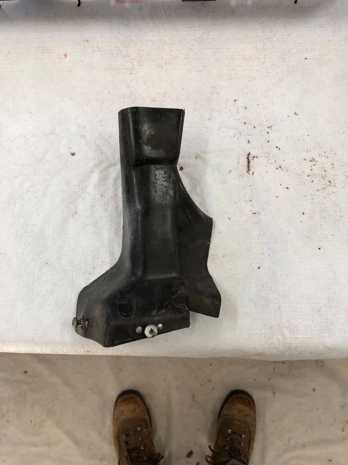

During a front clip reglue on my 1978 L48 I removed this part and now cannot remember where it came from. Any have an idea?
It appears to be shield of some sort . Material is semi rigid black plastic
Two machine screws attach it to something

Door lock shield. Goes on the inside of your door and protects the lock mechanism from outside moisture, as well as making it harder/slower to get in with a slim-jim.

Thanks 62corvette. I remember now. Driver’s door I assume. Will try replacing it since door panels are still off. You’re amazing
